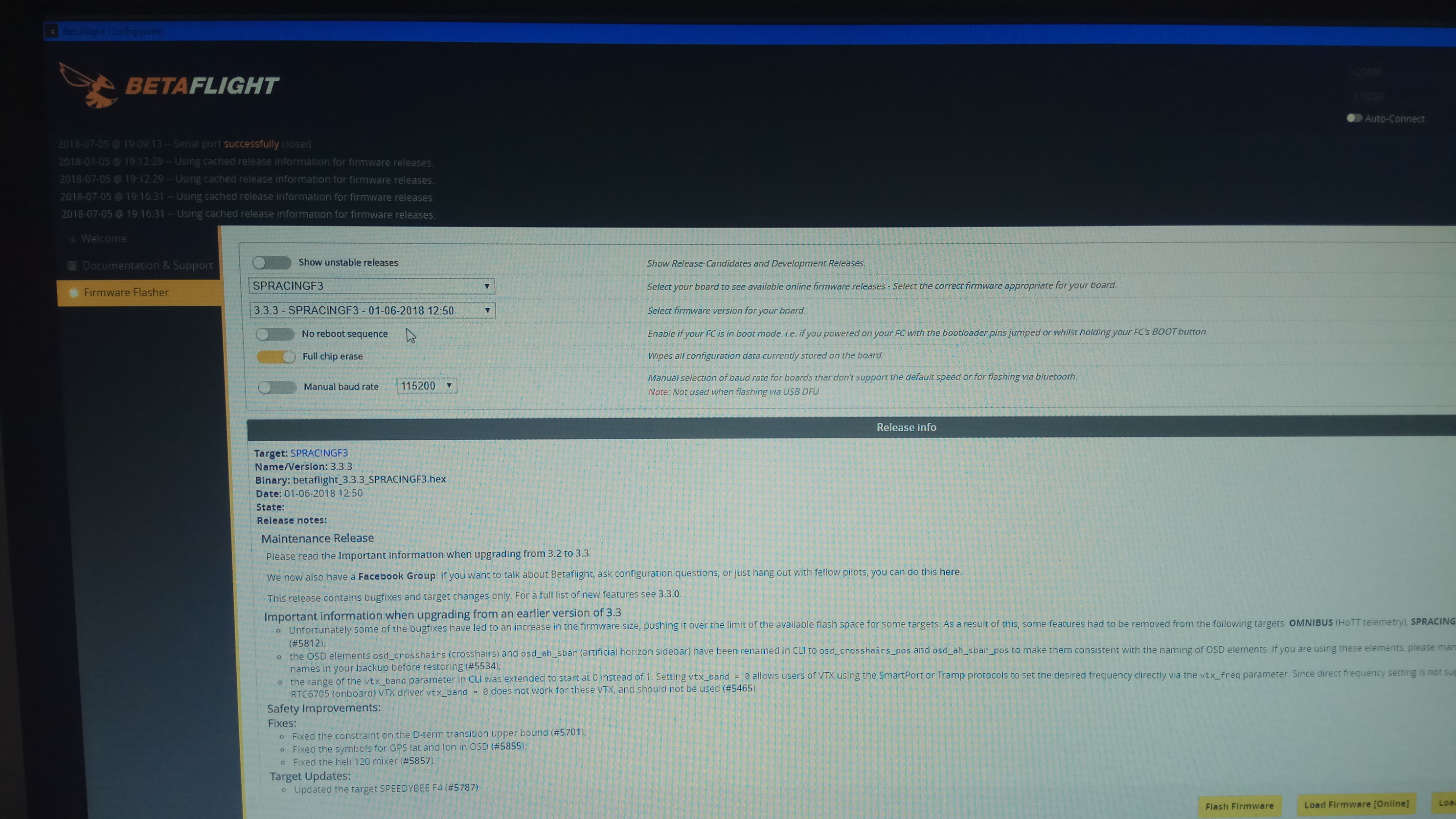

I’m sending you a video, for somereason I cant reflash it altough I tried zadig and reinstalled all the drivers.
make sure your in bootloader mode first?
Yup it is in bootmode
Then just flash it like i taught you to think carefully as you make each step pic of your normal bf screen?
I have seen your video and make sure you have the cp210.x driver installed and not the stm32 and list all devices(options) and select and reinstall?
I do,but its not working either

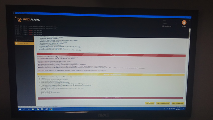

Enter bootmode, trying full chip erase, load and flash, full chip and no reboot load and flash, full chip no reboot and manual baud load and flash and not working. trying again.
When you mentioned changing the uart can you just go back to the ports tab and change it there?
personally you only firmware flash when you want a new firmware or update
Unfortunatley I cant, at the moment I changed it and save the program just stuck and lost connection to the drone, now when I try to flash it doesnt right failed only failed to open serial port.

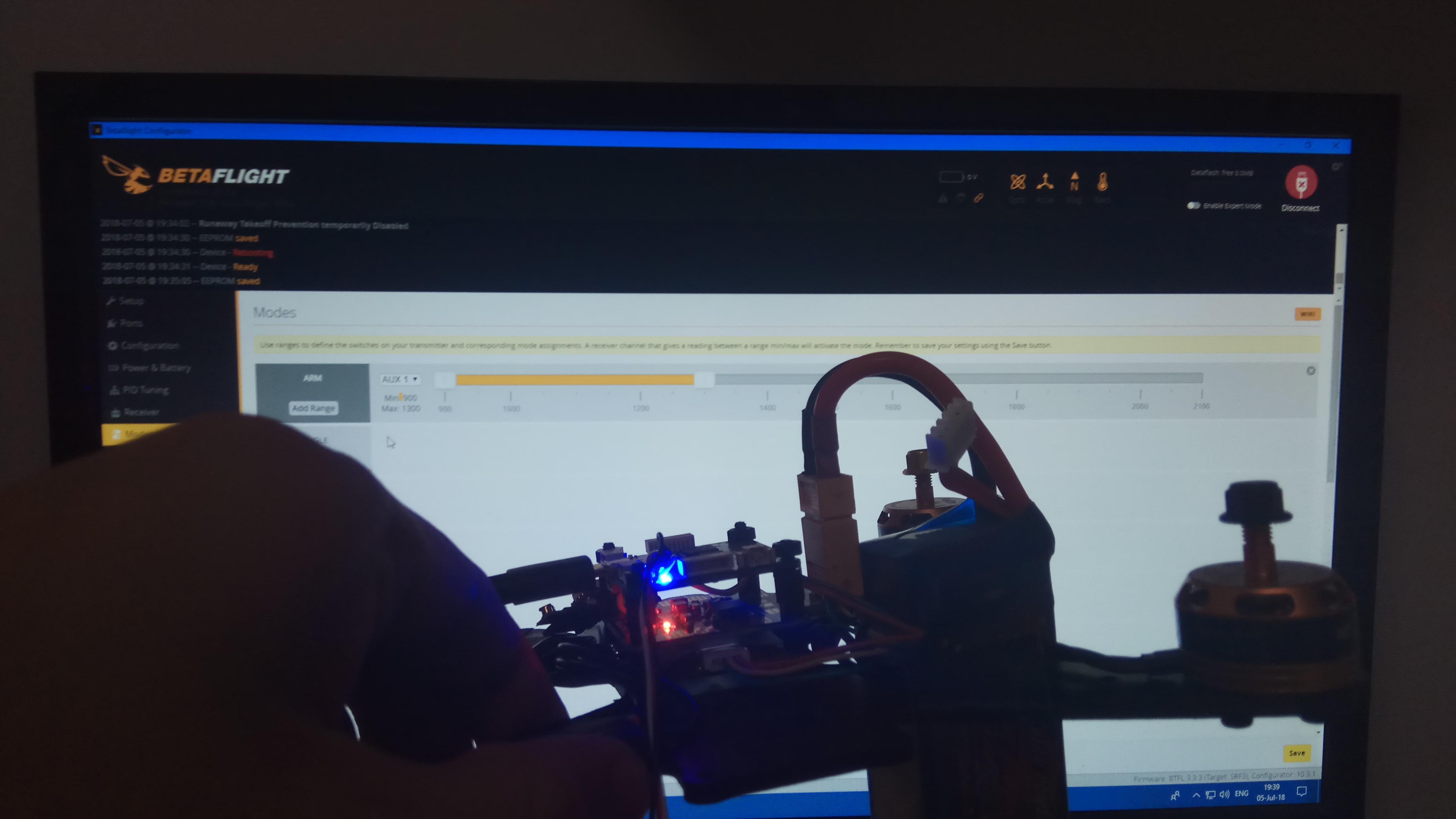

Alright! managed to reflash it after I checked all of them and another checkbox to flash as soon as it recognizes new port(something like that), I’ll do again now the configuration and we could go back to the place we stopped,I filmed the connections to my battery, maybe i didnt do it right or there is something else?

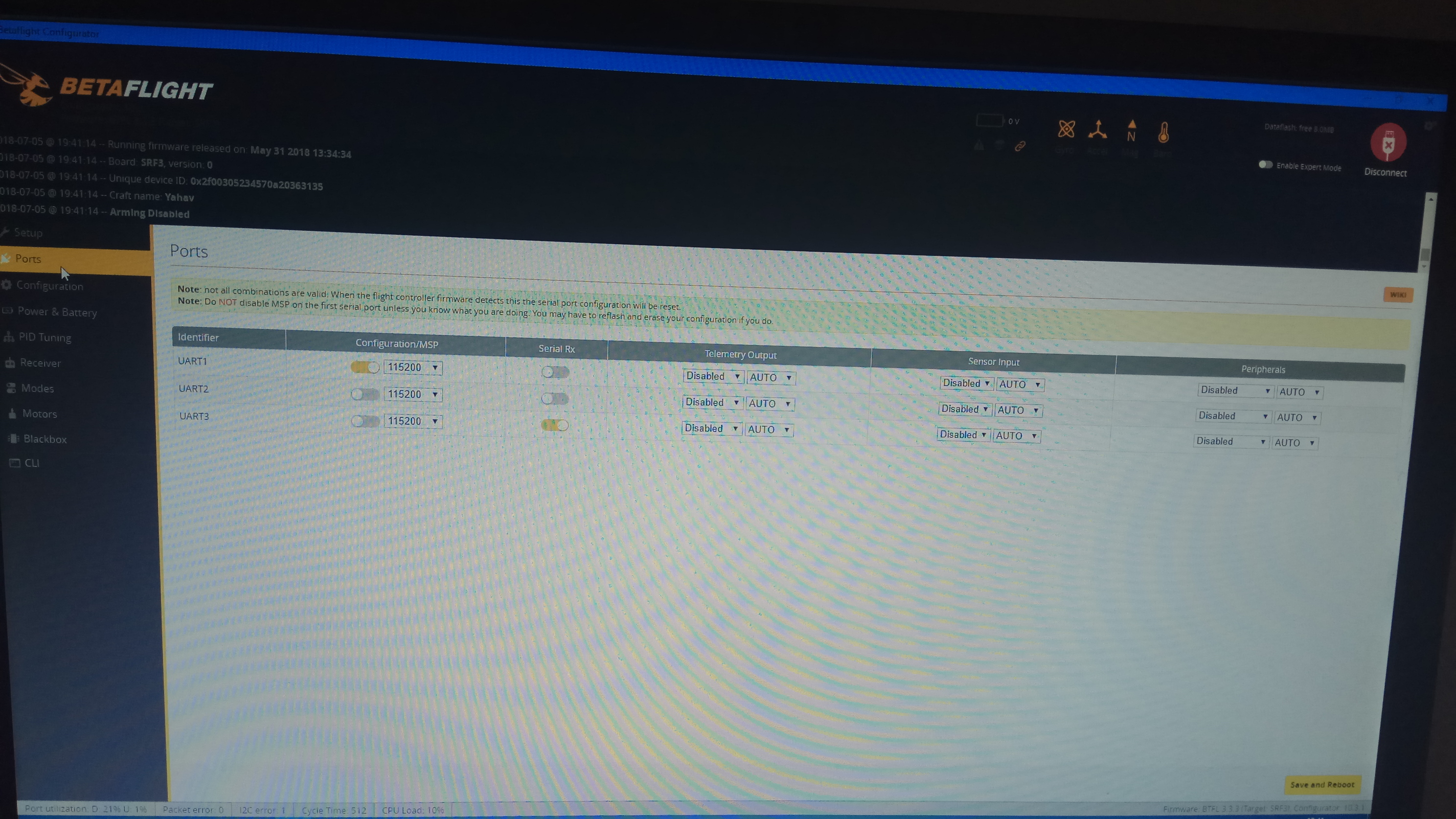

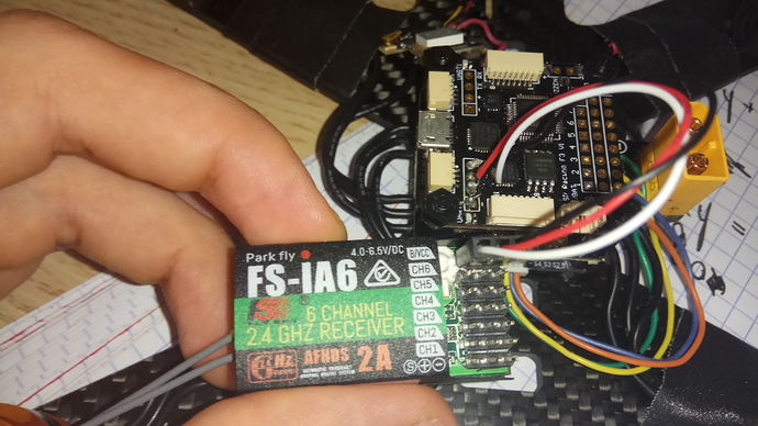

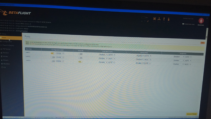

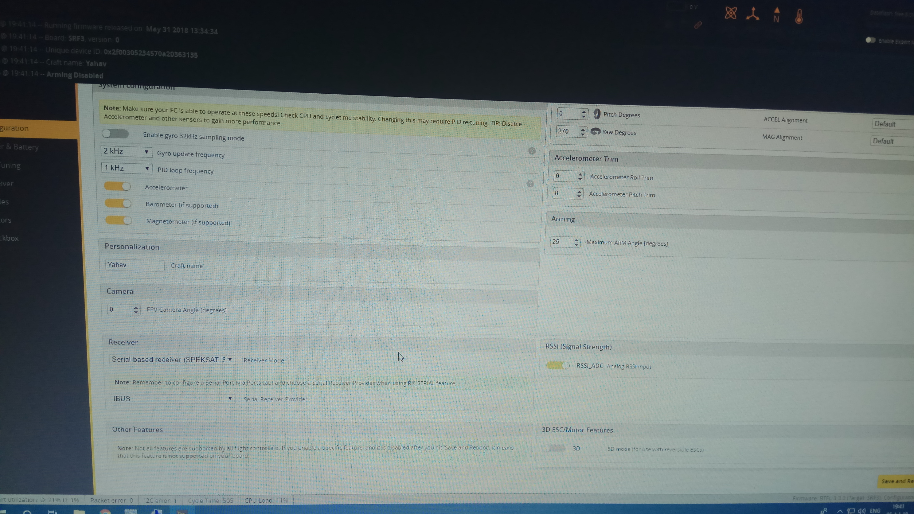

EDIT: so I added the pics of my config,ports, the reciever and its soldering on the FC and the no voltage in BF with the batt is connected, I tried in config PPM RX input and Serial based reciever-iBus like stu did. with no result.
Atleast I know I found one problem,about the voltage, if the engines get power from my battery when I activate them through the BF then its not the solder of the batt connectors I guess, what could it be?
I think you have connected the wires wrong on the reciever. connect it on the pin label of s± below ch1?
u have connected your jr connector to the binding pins, connect it to the pin at the very bottom below ch1. thats your problem after that ur going to be flying
I’m sorry but I didnt understand which jr connector to where, could you draw on the pics I sent?
You mean the jr connector that goes to the reciever? desolder it from the RX,-,+ and solder it to VBAT +,-? which cables?
This step requires no desoldering/soldering
Unfortunately I have watched stu’s video of this build and you sir have the wrong reciever. Your build is fine no changes should done anywhere else but you need to go and buy a reciever that outputs sbus. You have flysky ia6 which only outputs ppm instead of sbus. In Stu’s videos he is using flysky ia6b which has an sbus output. Therefore I recommend getting flysky ia6c reciever than the ia6b because its more compact. In todays standard ppm output is pretty much outdated. These ia6c recievers are pretty cheap i think so if you can get you hands on it, its just a case of pluging the cable from your uart2 to the sbus pins. Sorry it took too long for me to figure out what was wrong with your set up(I had to go back and look at the past pic that you sent me). I apologise.
