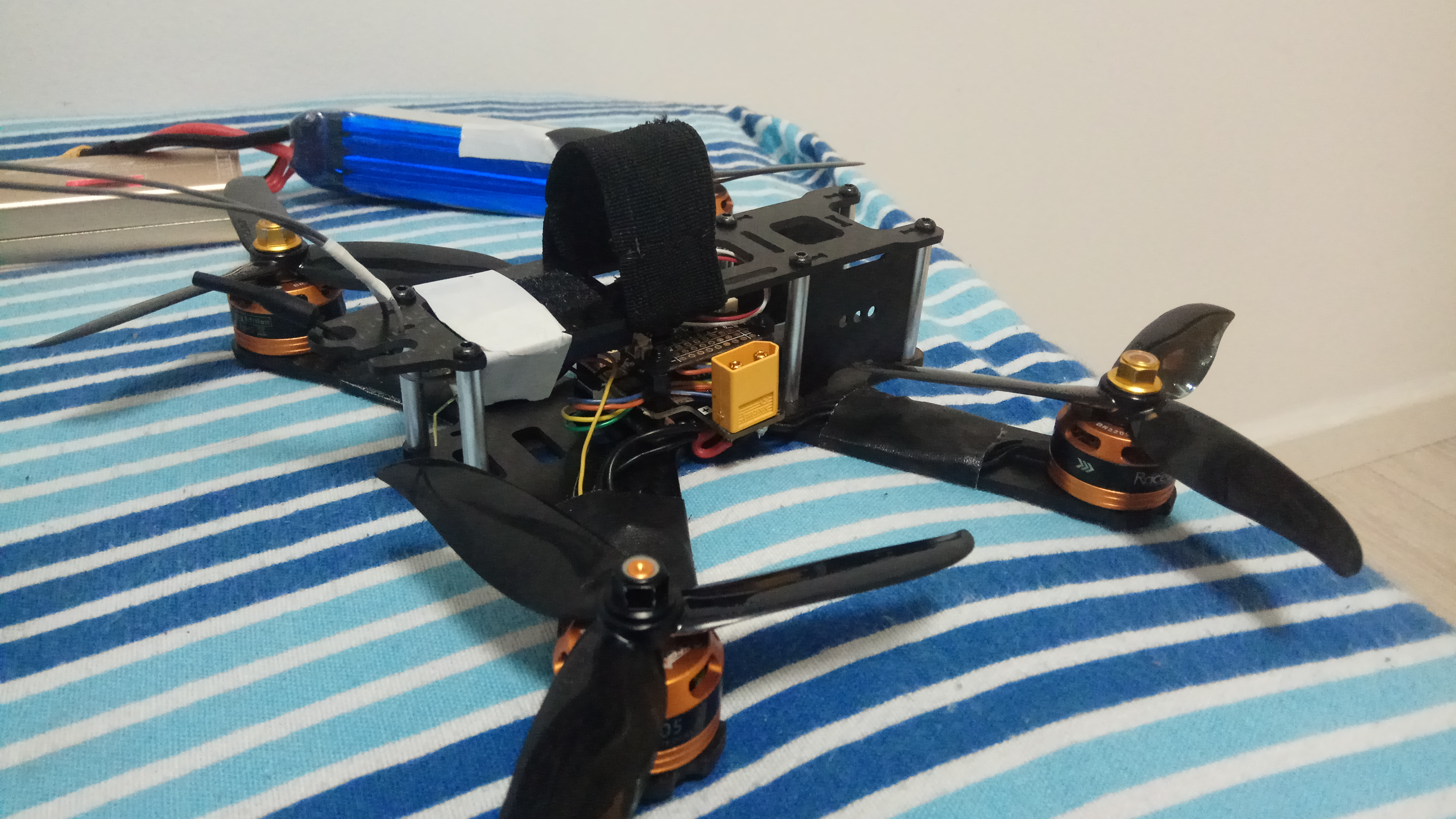

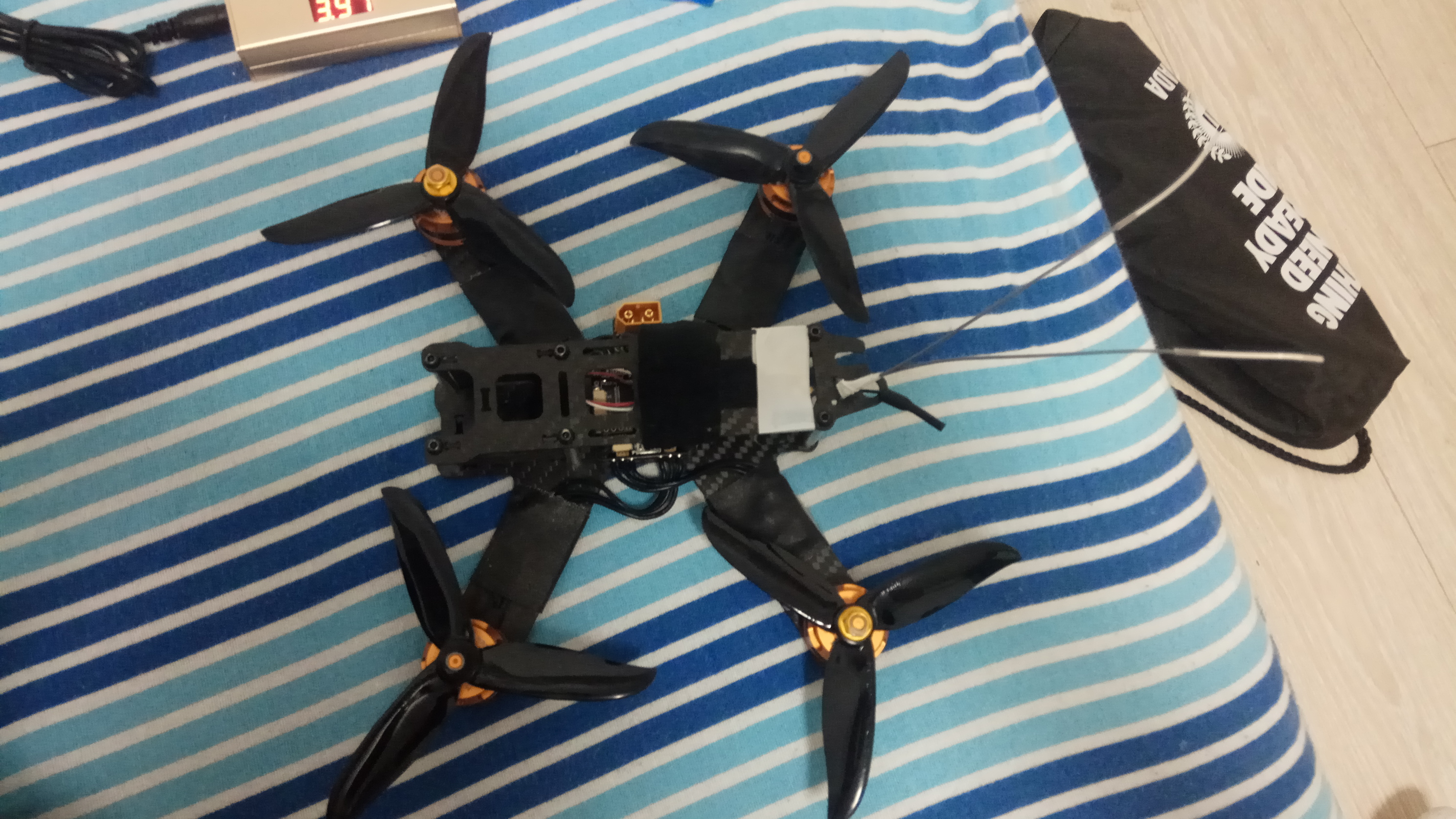

Pic after the crash you can notice the propellers not straight:

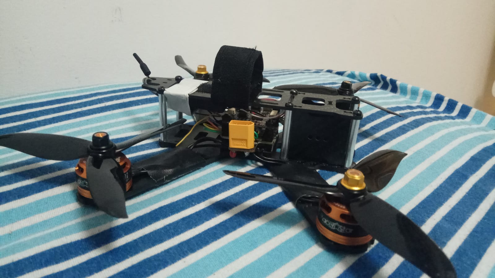

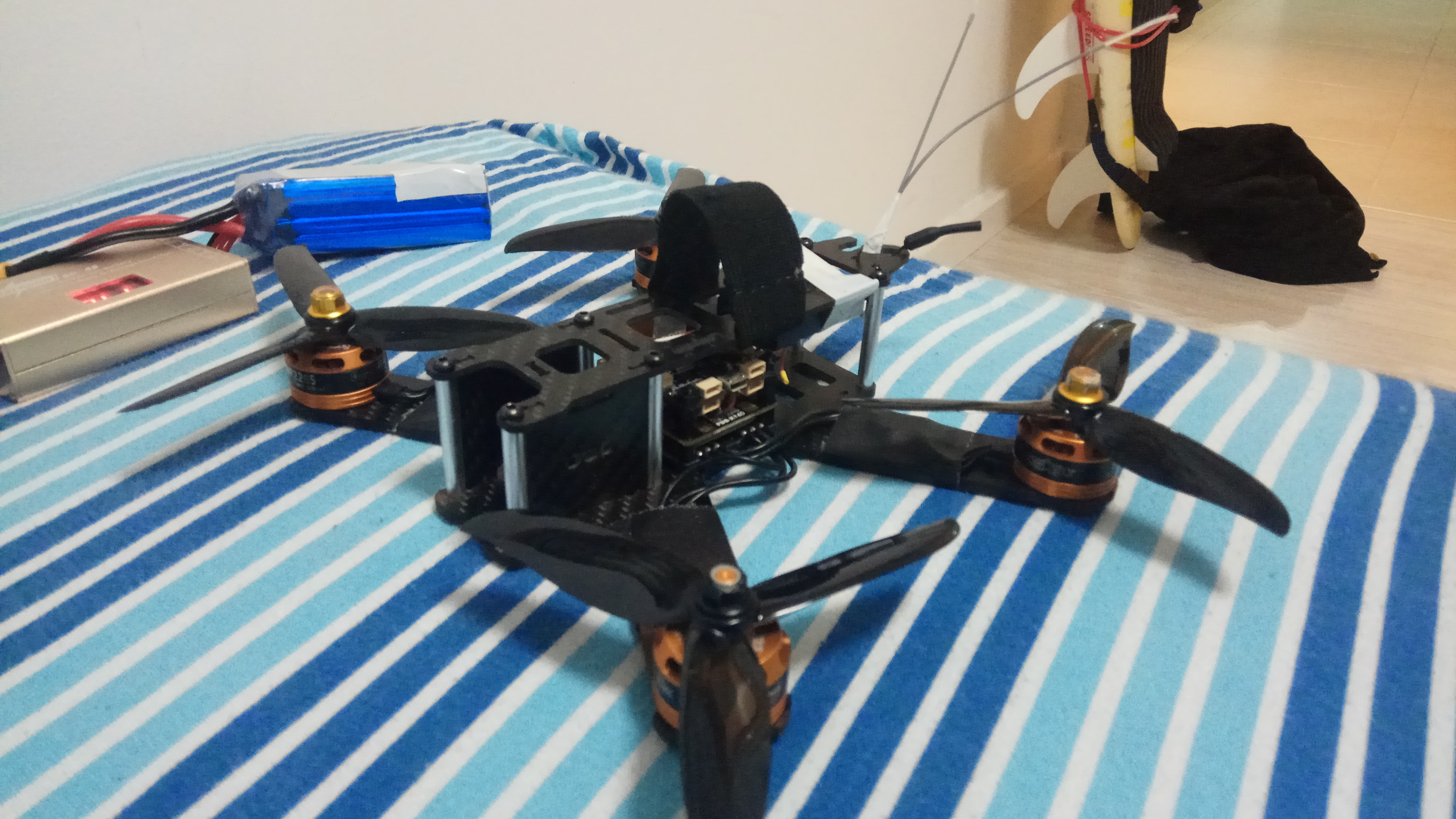

Here is a few pics,I put for now PVC over the battery that got a hit so the wrap wont continue to fall off:
