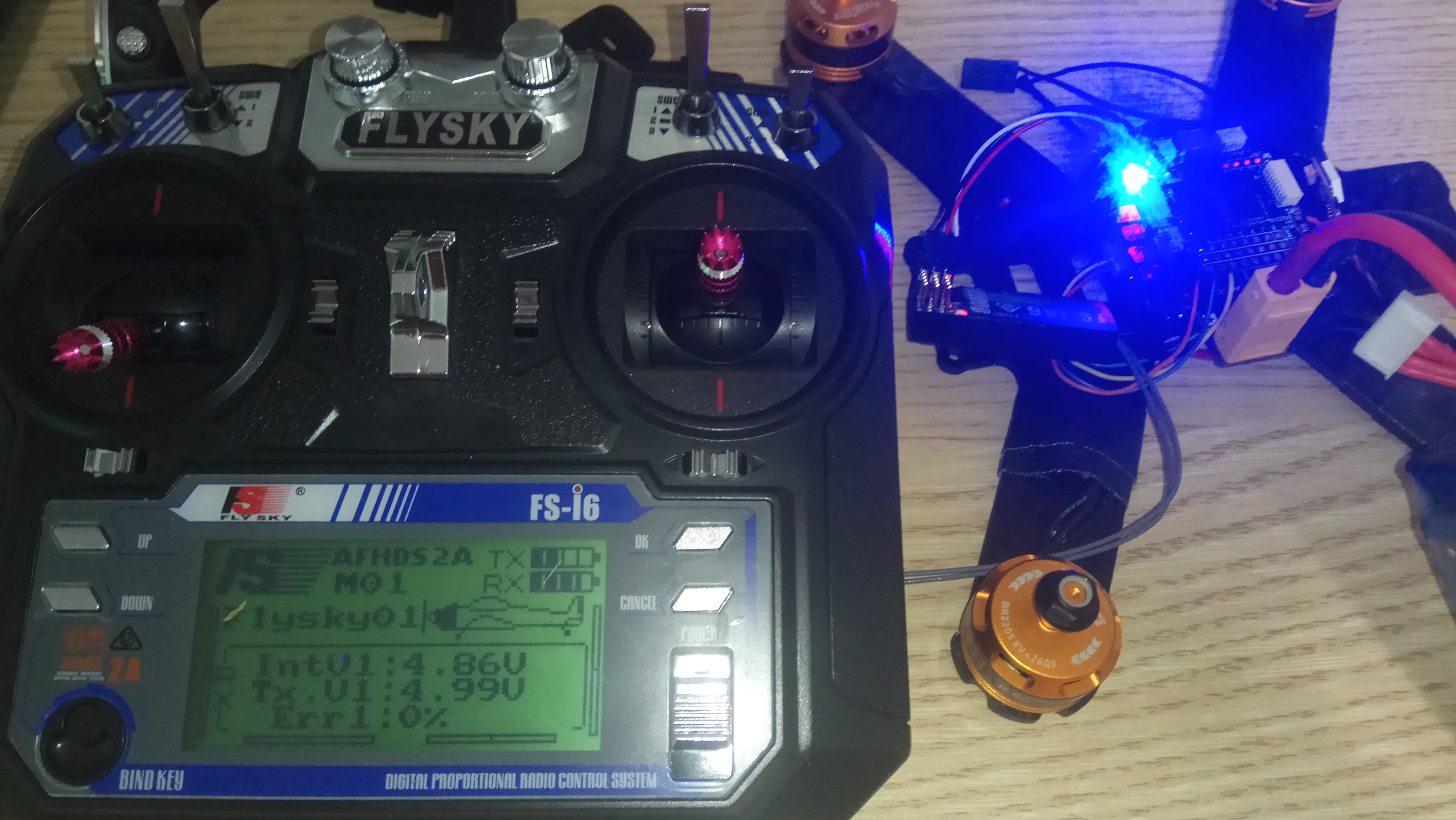

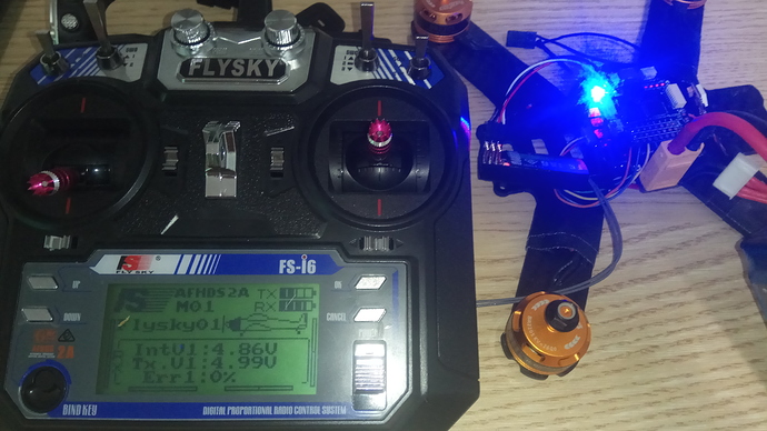

Now I see in the remote controller the RX and ERR1:0% and there is no power when I try to throttle up, what should i do?
could you possibly sent a pic
Sure just a sec
Cool when you mean no power the motors dont spool up?
Can you also check you PPM output is on?
The PPM is on, Yes I mean I try to “level up” the drone and it just doing a beeping sound here and the motors and moving back and forward tiny spins…
