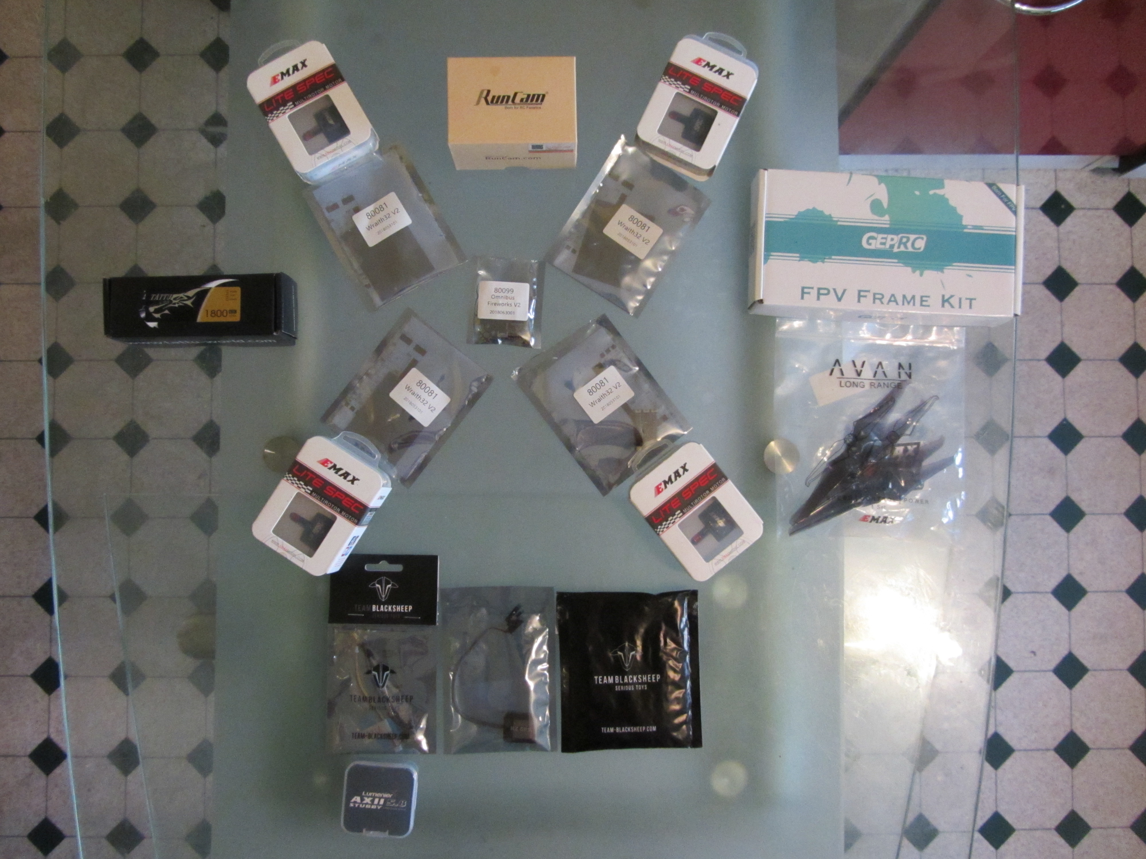

I’ll post regular updates and pictures here so everyone can follow the progress.

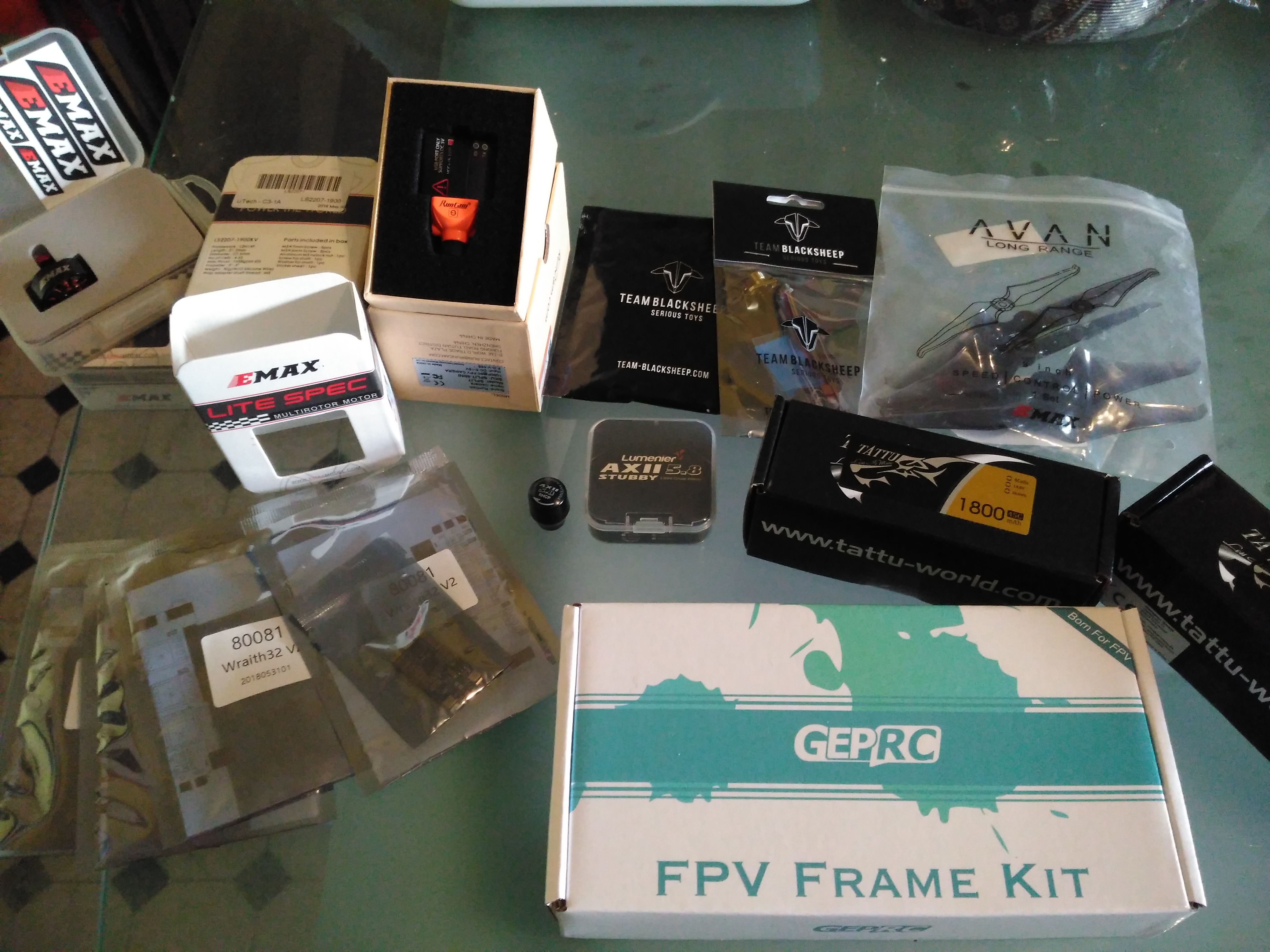

For the keen of eye… What’s missing from the picture.

The Parts List

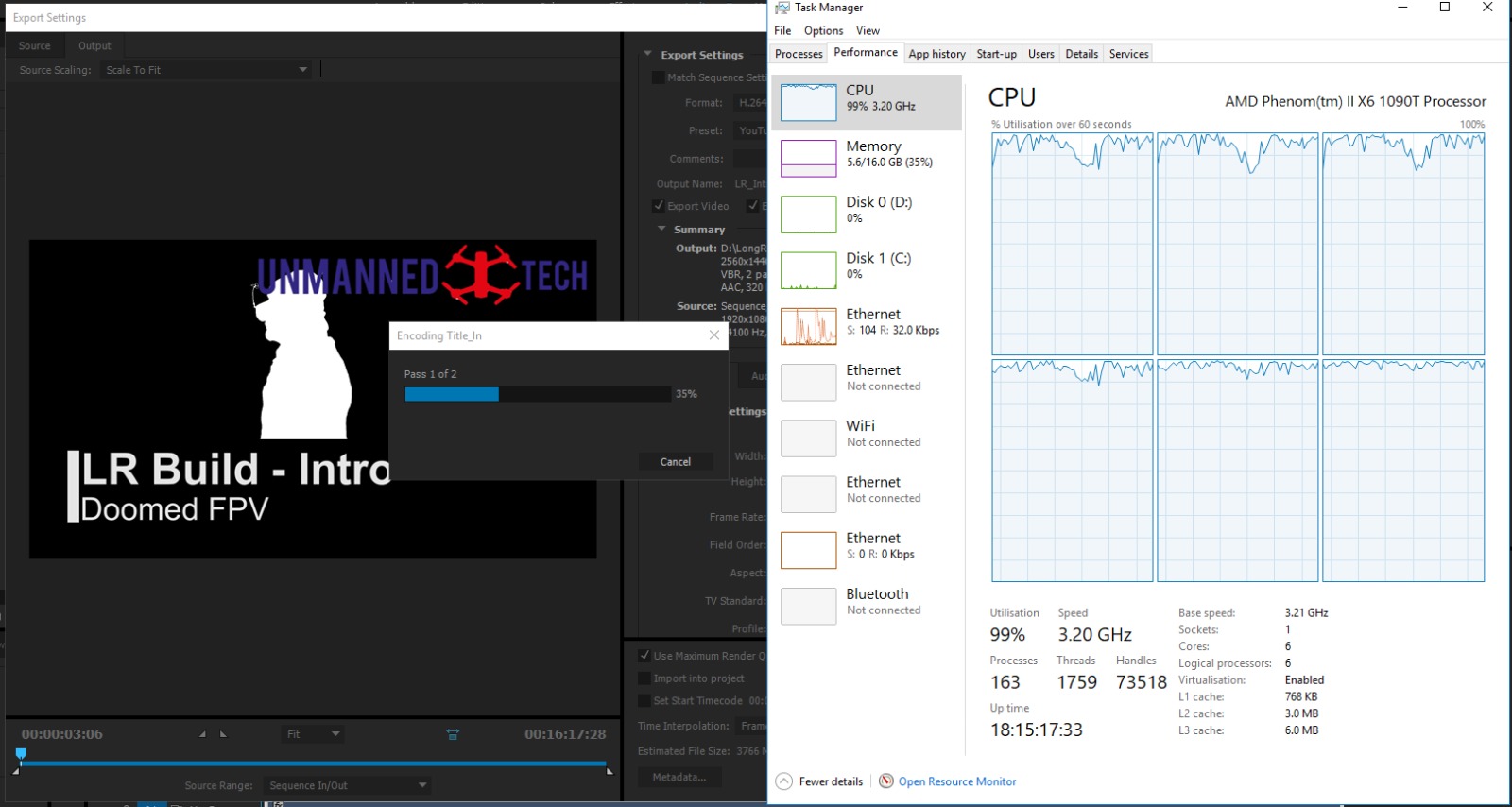

The Long Range Intro video is encoding now for yourtube.
Only started it at 10am (its now 2pm)
This could take a while to finish.
This video took nearly 12hrs to finish encoding… feel sorry for my CPU

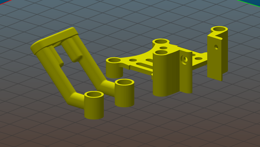

Plus I’ve got some protype mounts ready for printing… Looking at about 3hrs 30min in TPU

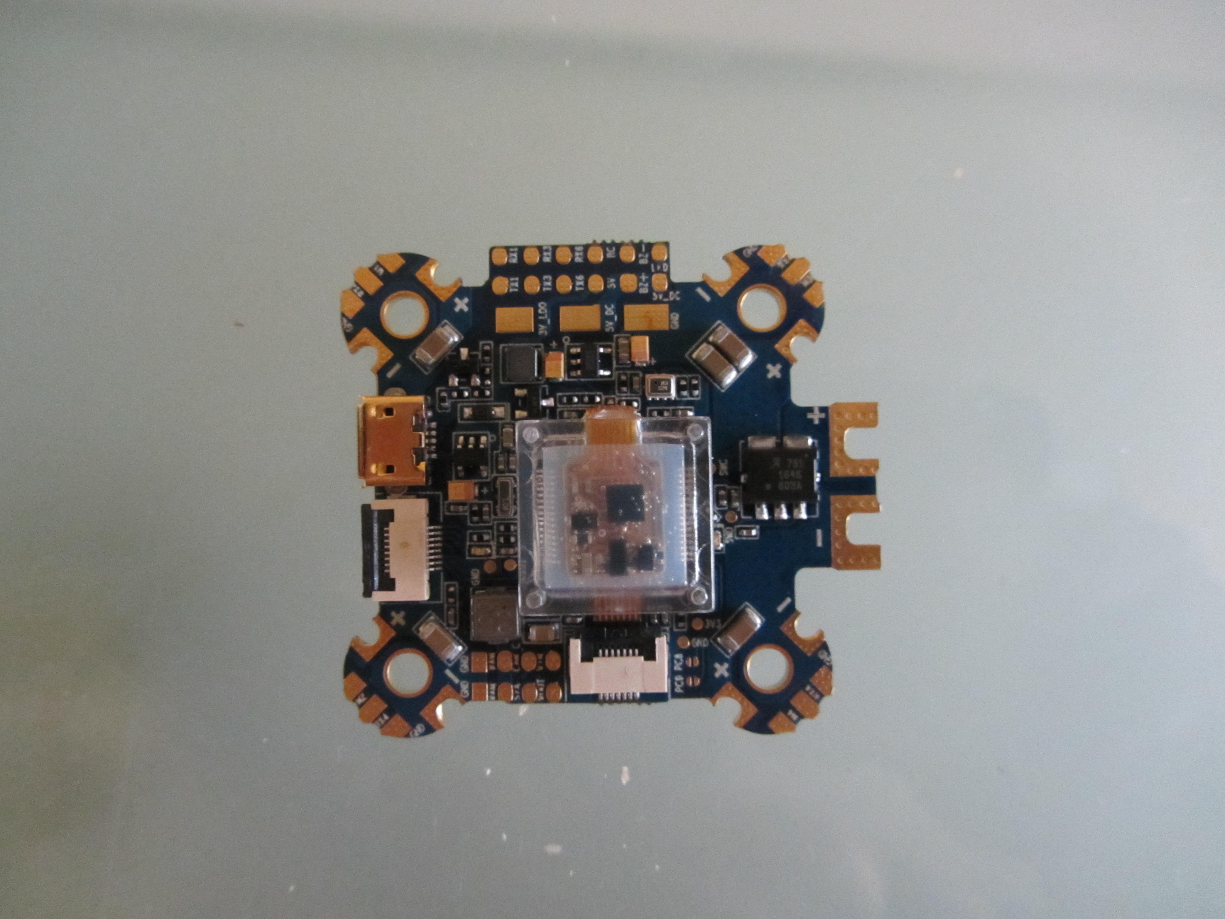

Look what came in the post today from unmannedtech :slight_smile:
The Airbot Fireworks v2.
Smaller than I thought soldering is going to be tricky.
I now have every part needed to complete this build.
Its going to take me nearly 2 weeks with all the pictures/guides and videos.

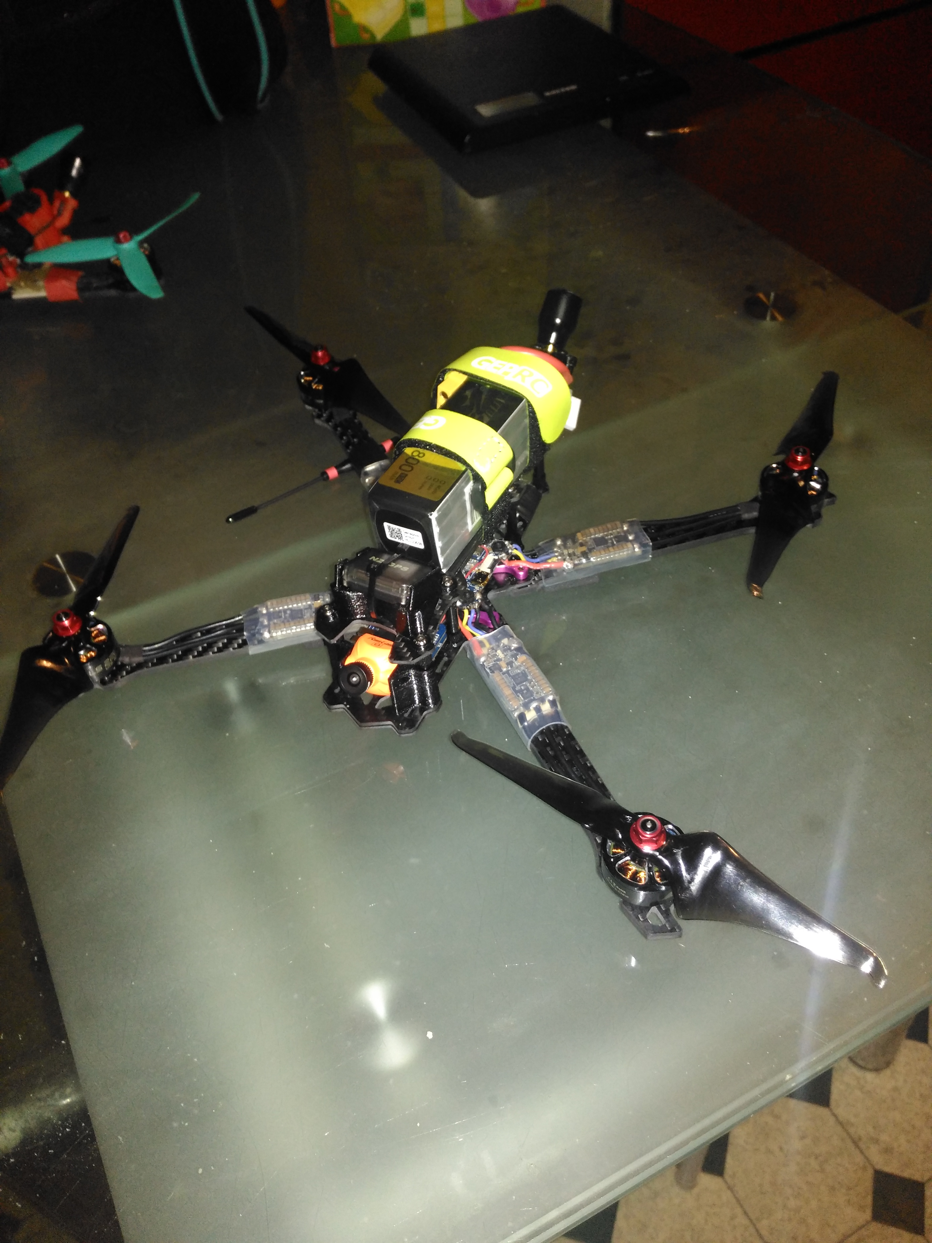

I’ve just finished fitting the Motors and ESCs and started the soldering work.

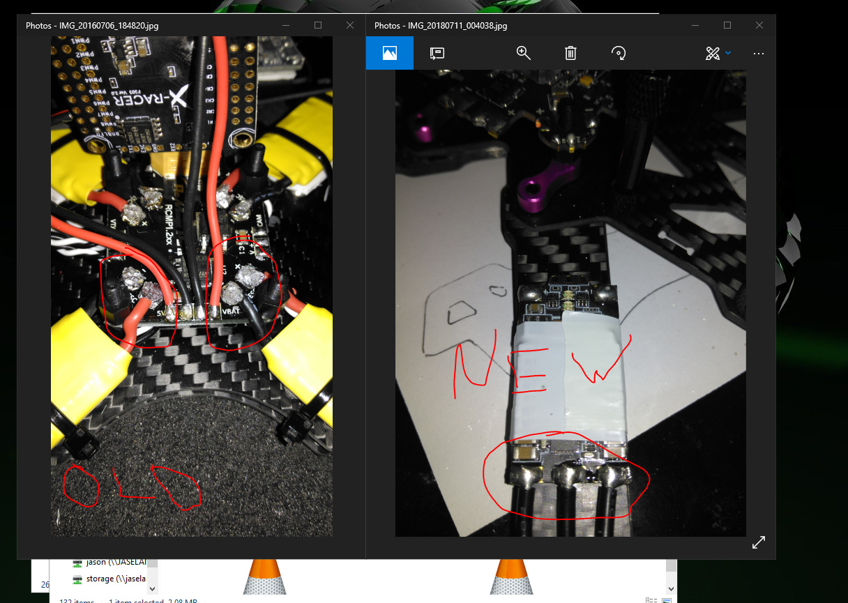

and just to show that soldering does get better with time and pratice.
Below is a picture of my first quad (it still flys) and todays work.

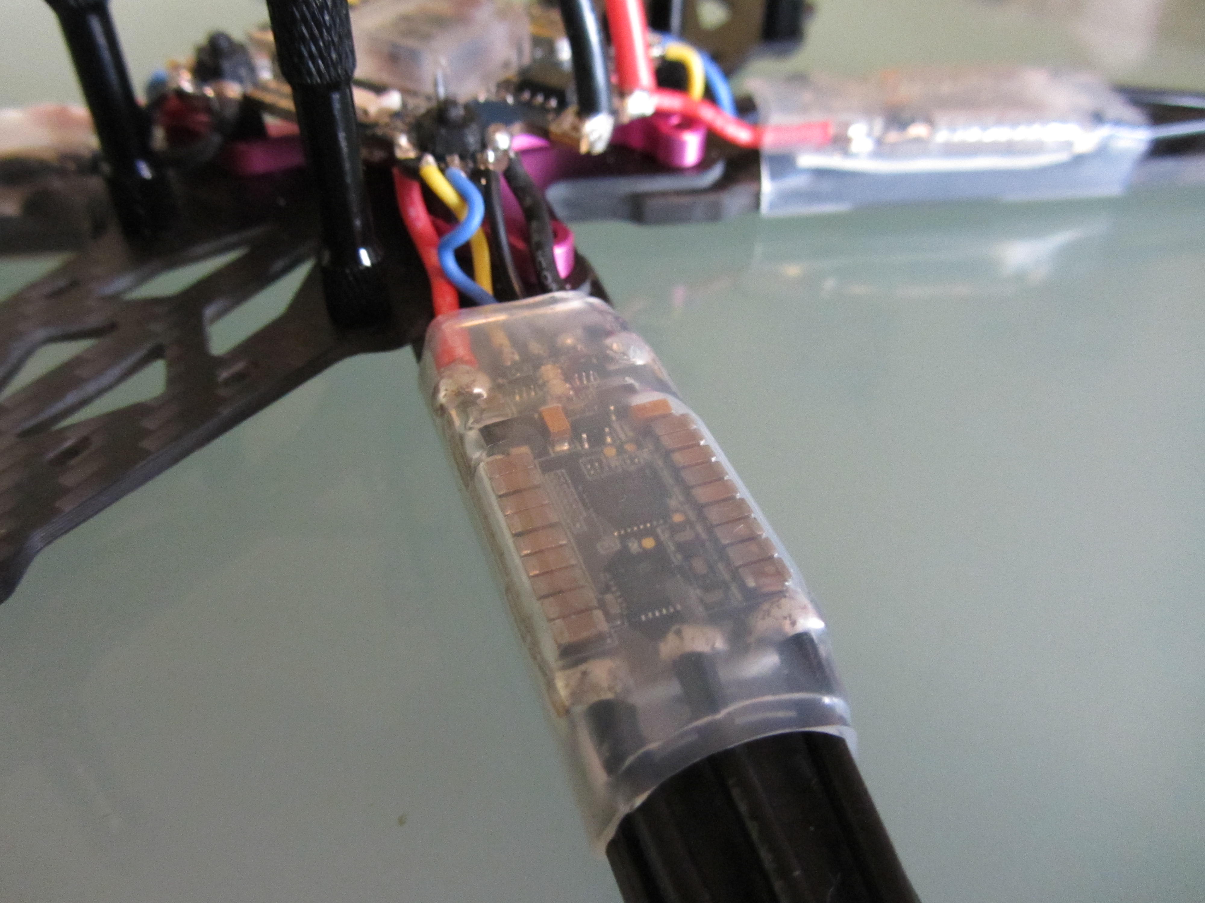

So the smaller heat shrink arrived today for the ESCs.
So I’ve heat shrinked the ESCs, used double sided sticky tape onto the arms and then…
heat shrinked them to the arms. Nice too look at but will be a real pain to work on later on.
Next up is a new video.
Covering the work I’ve just done, continuity checks, smoke stopper and what I’ve learnt and a quick test in BF.

Looking good :slight_smile: And I do like the look of mounting ESC on the arms like that but also agree with you about it being a pain if you need to repair something. I always find it funny comparing a quad just after you built it, to the same one a few months later after about 100 quick fixes! But being a long range quad, hopefully it will have fewer crashes… unless someone decides to fly behind a hill :mountain: :face_with_hand_over_mouth:

Well the weekend is nealy over.
Recorded a video ready for editing…
Got every thing mounted and put together.
Next week I will be mostly covering the configuration of the build.
Working on the build guide and more videos.
May do a maiden flight towards the end of the week.
But for now here’s a preview shot of the build.

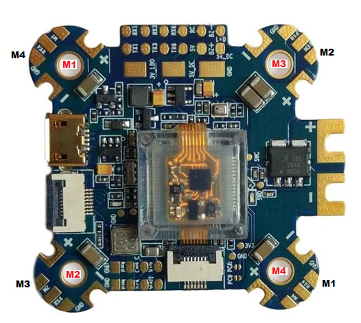

Just been having a look at the flight controller and how I’ve got it installed and it looks like I have it the wrong way round…
But that’s not a problem, I can use resource remap to move the motor pins.
I did this on purpose so that I could cover remapping motor pins and adjusting the FC origination in Betaflight. :wink:
In the image below:
Red is where the motors are on the FC
Black is where I need them to be.
