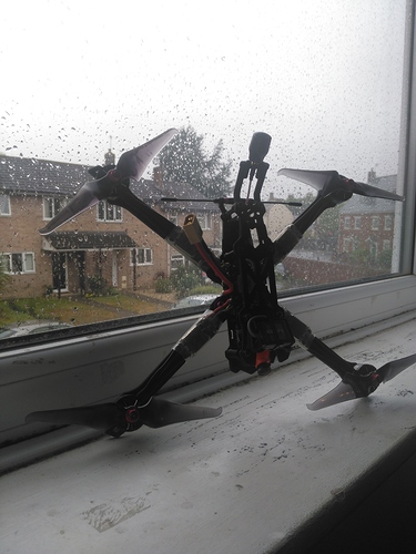

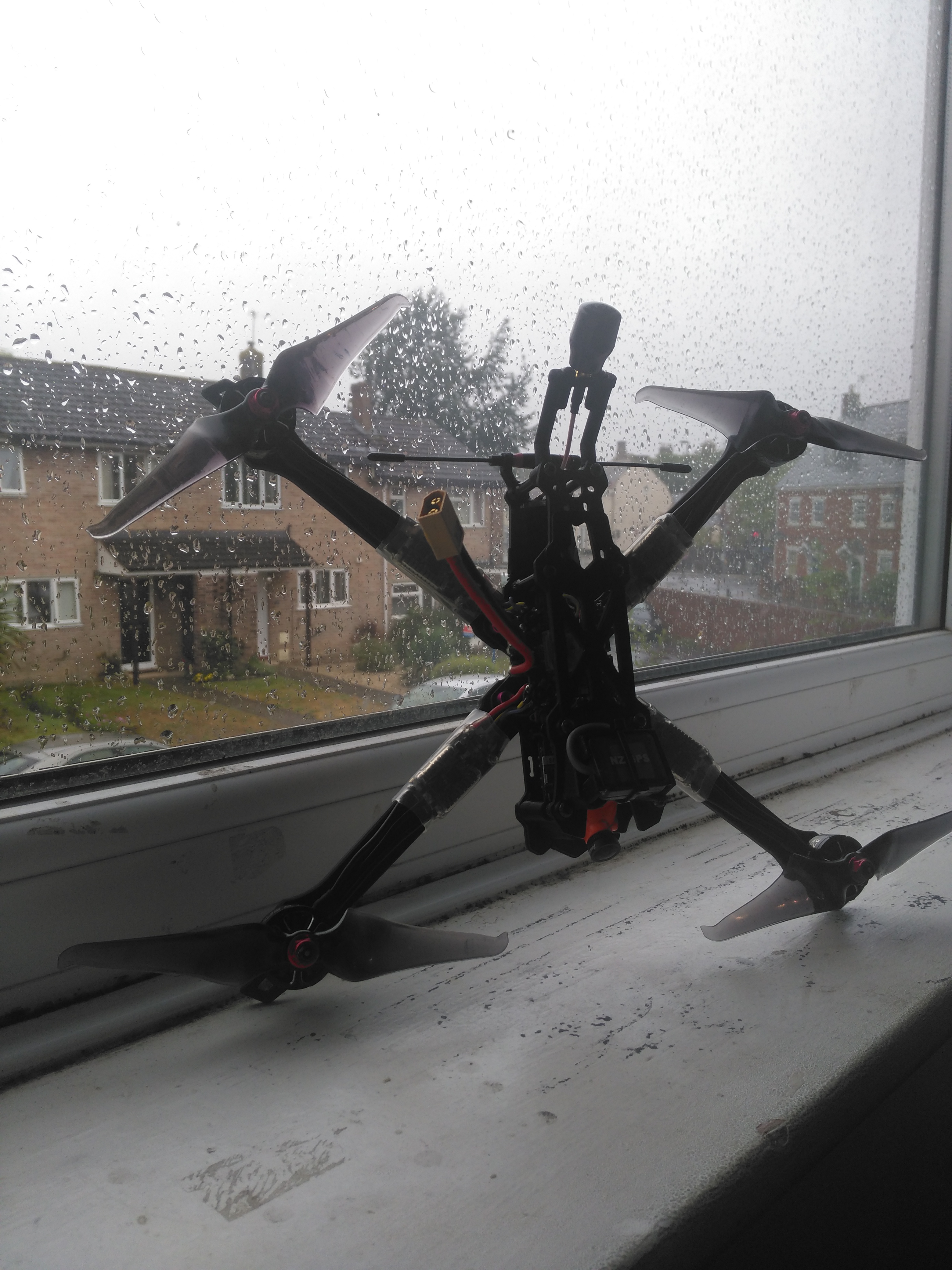

We have been having a heat wave for weeks and now the build is finished it rains :frowning:

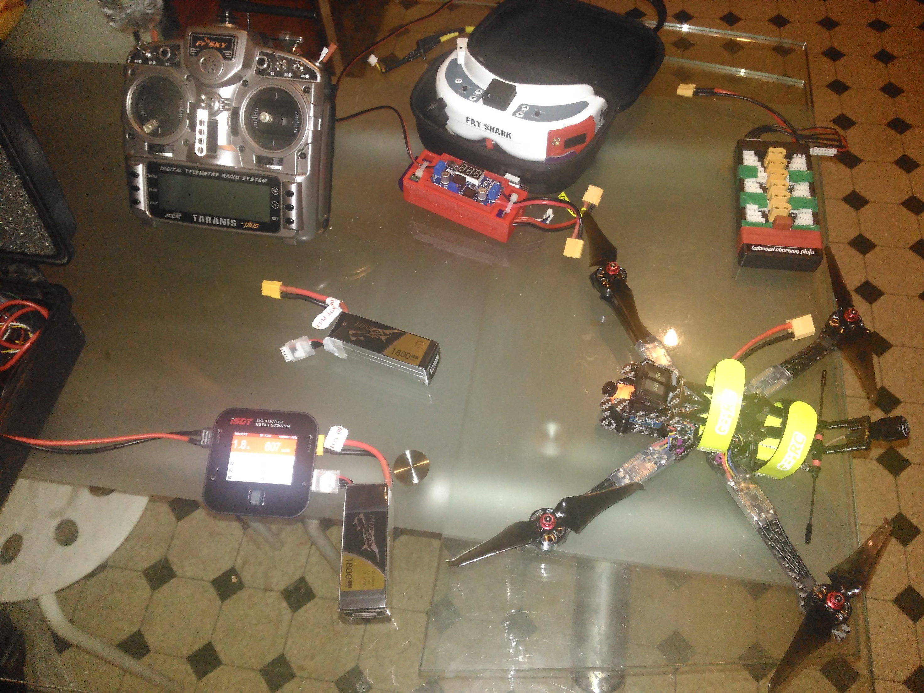

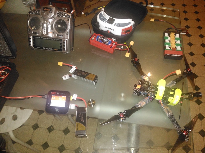

Charge everything…
Tomorrow if its dry… It’s going up.
Also I’m checking my SD Cards to make sure they are already and empty.
I cant wait to see that beauty up in the air :blush:

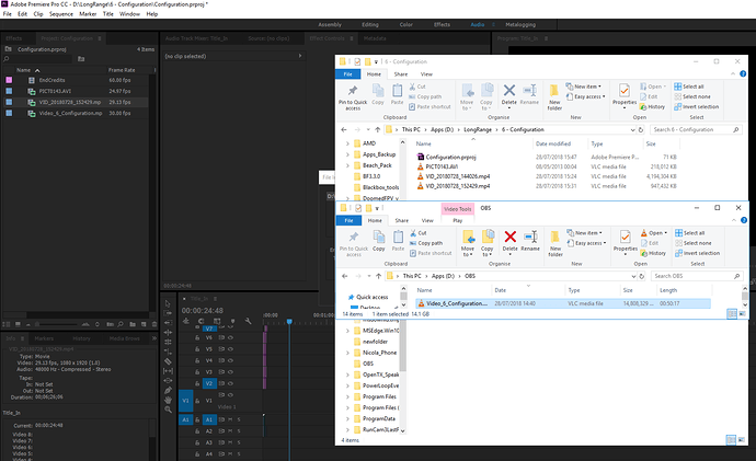

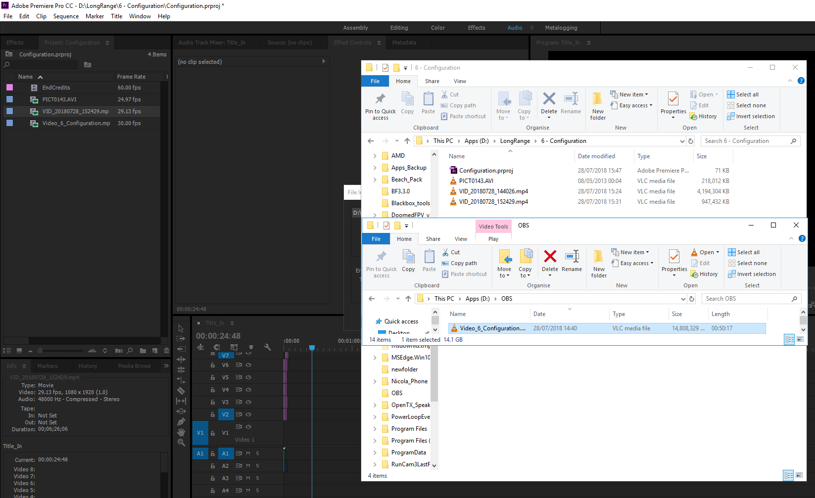

Configuration Video
The configuration video is being edited but one of the videos (the one above the quad) was corrupted so I’ve lost that footage :frowning:
So I have to redo some of that footage.

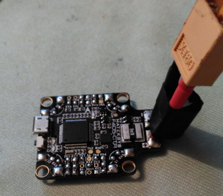

So I have swapped out the FC within this build to a Matek F405-CTR AIO Flight Controller
And I’m happy to report this FC is running and the LR build now fly’s… its in need of PID tuning the default 3.5.1 PIDs seem to oscillates A LOT ( I’m working on PID tuning now )
So why this FC
It has a SD Card slot ( good for black box ).
Its has enough UARTS ( 4 = RunCam, Crossfire, GPS, VTX ).
It has separate pads for ESC telemetry.
The only down side to this FC is its Gyro max’s out at 8k /8k ( so no 32k or 16k PID loop )
As this build is a long range cruiser I probably won’t even notice the difference nor will it make a difference to its flight performance.
