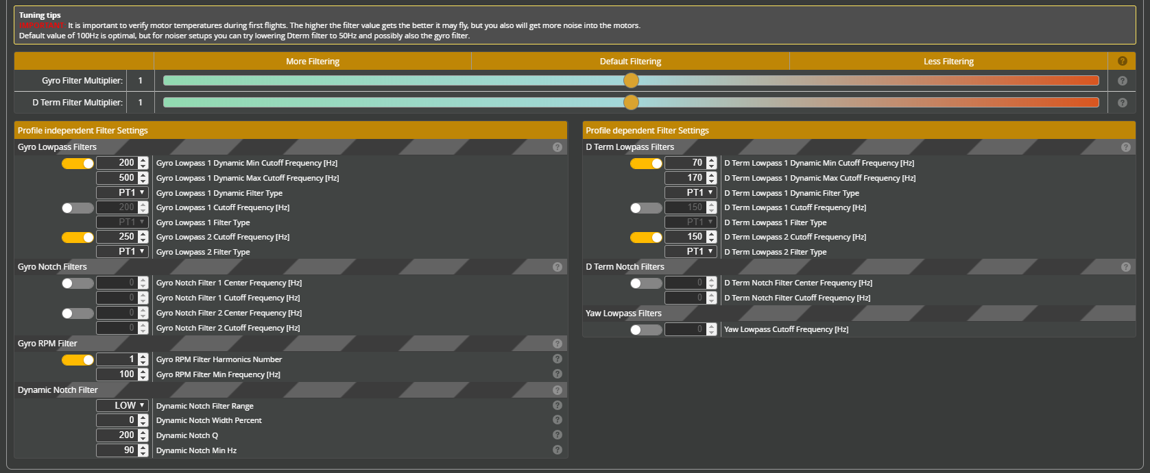

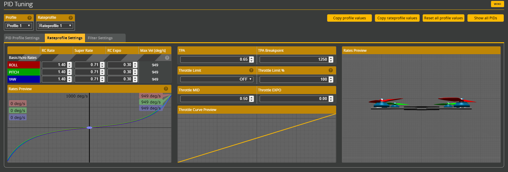

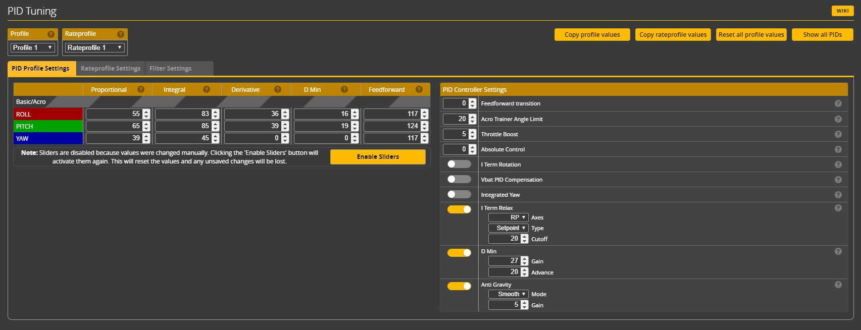

So below is a upto date parts list, a CLI dump, and screenshots of my PIDs and Filters ( not finished yet… but close enough for now)

PID Tuning Tab - PID Profile Settings
PID Tuning Tab - Rateprofile Settings
PID Tuning - Filter Settings
