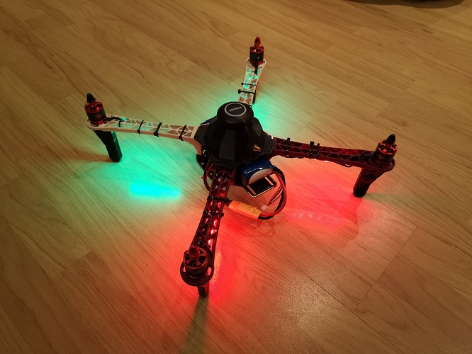

This is the dome cover
450_dome_poly_top_preview_featured!

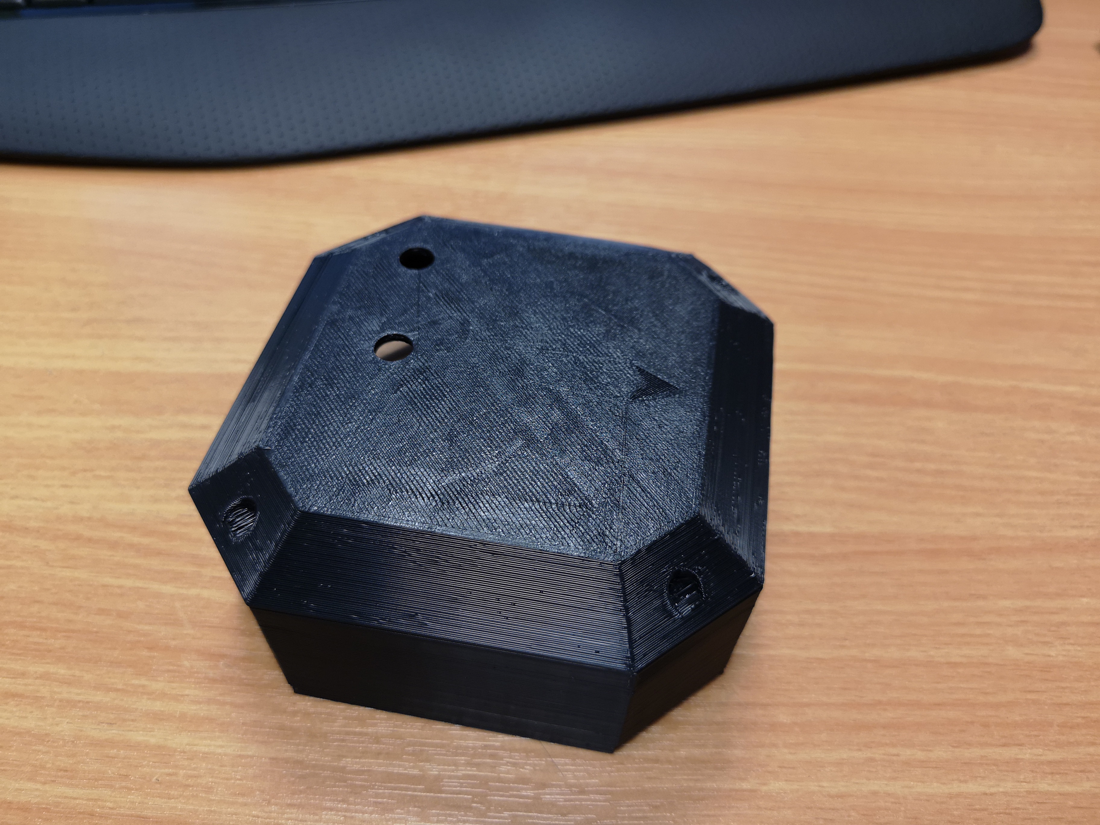

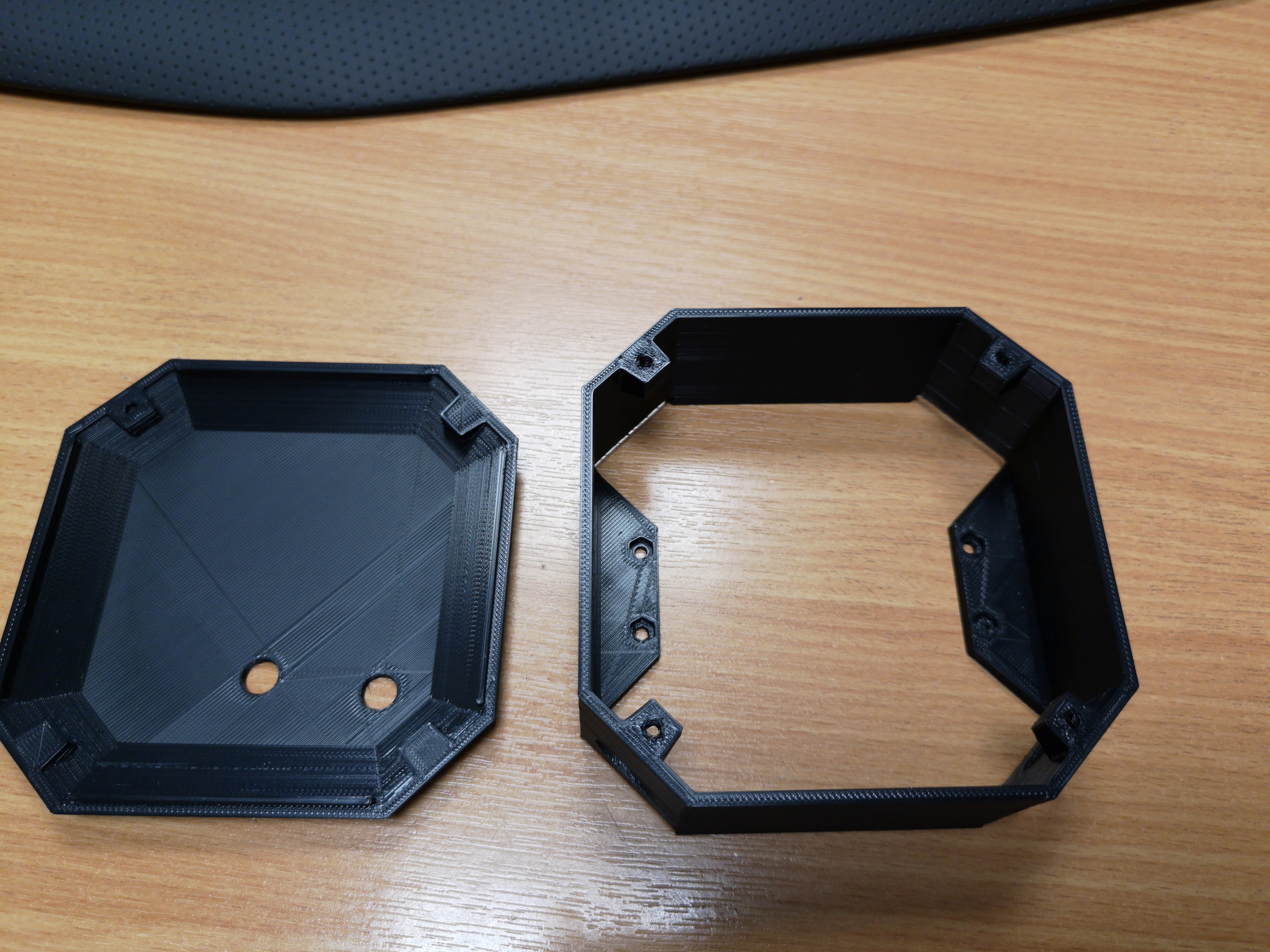

This is what it will be changed to. I have remixed a part from Thingiverse to close the hole that was made for an FPV camera as i won’t be using one currently.
450_Cased1e43b860f4e90c502c76831720d6a13_preview_featured
The dome definitely makes the build that much neater, if you ever damage an arm you should try to get the black ones to make it look even smarter :slight_smile:
Looking forward to seeing how you get on with Librepilot as I have not flown much with it for a while now, and when I did was mainly just using it for FPV flying without GPS. When I build multi-rotors for photography I usually go with pixhawk as I generally prefer the arducopter firmware as thats what I am used to.

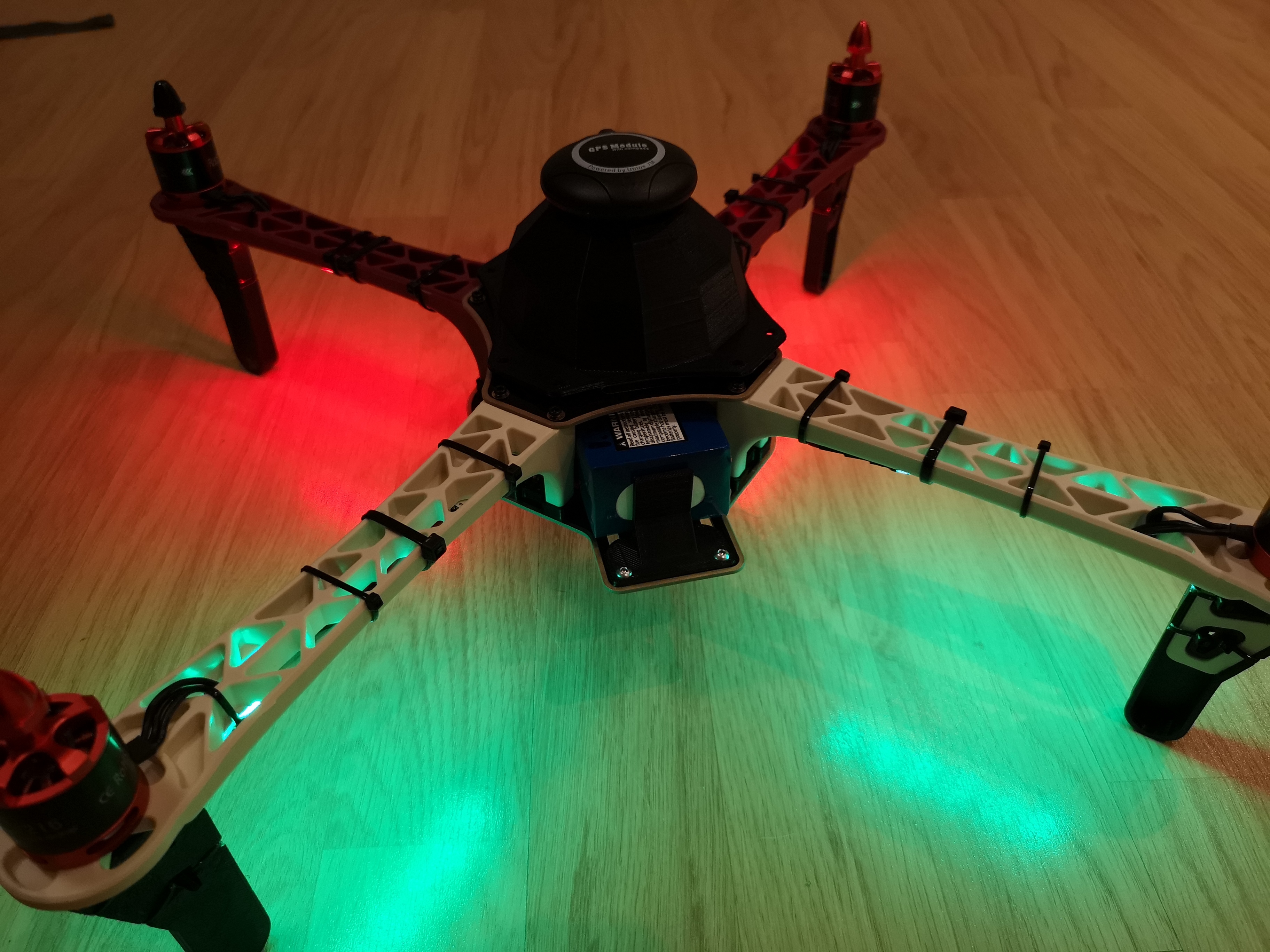

New top cover printed :smiley:
That should hide the cabling nicely :slight_smile:

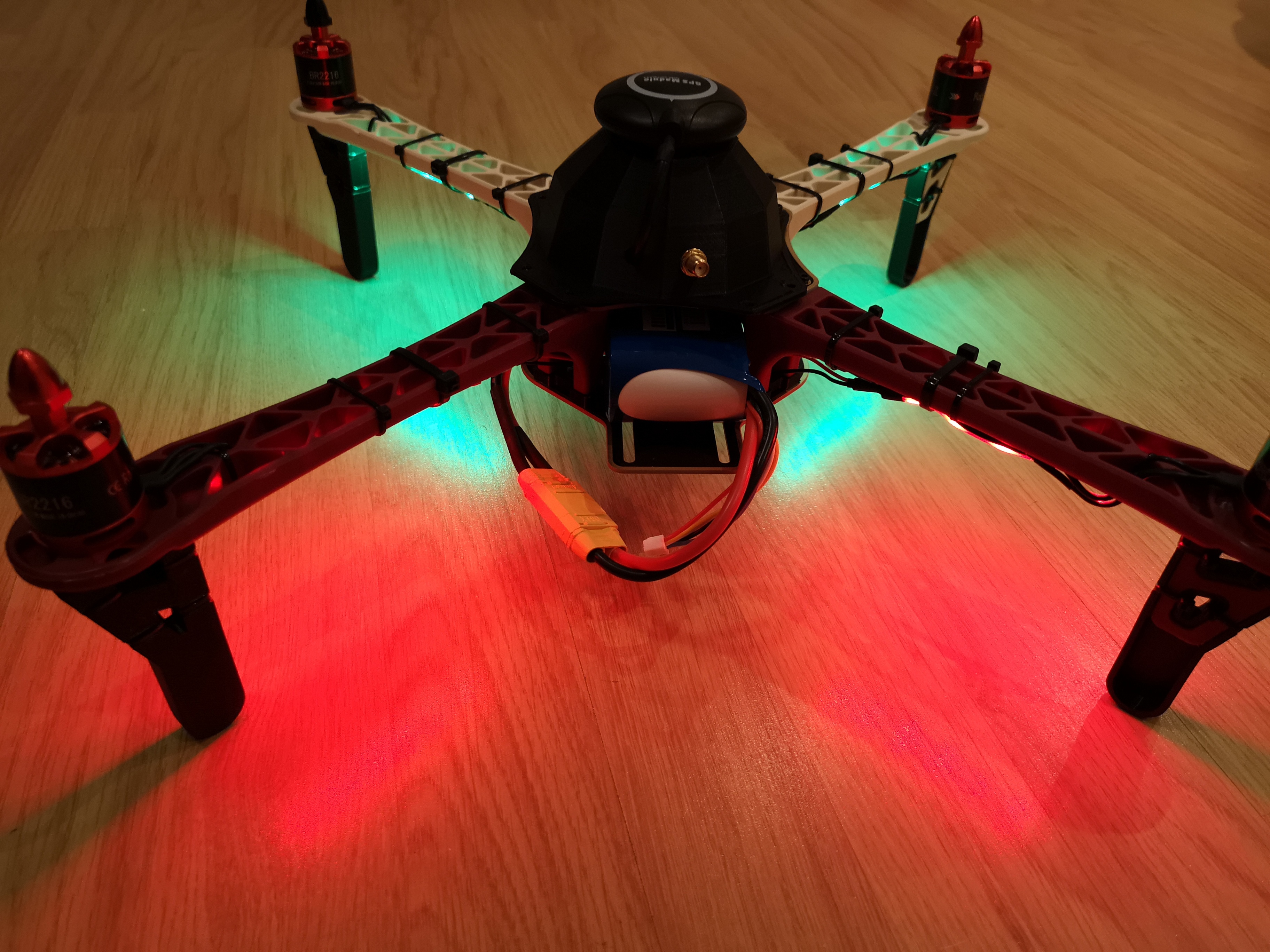

New cover added, all wiring now hidden and a lot more tidy :smiley:

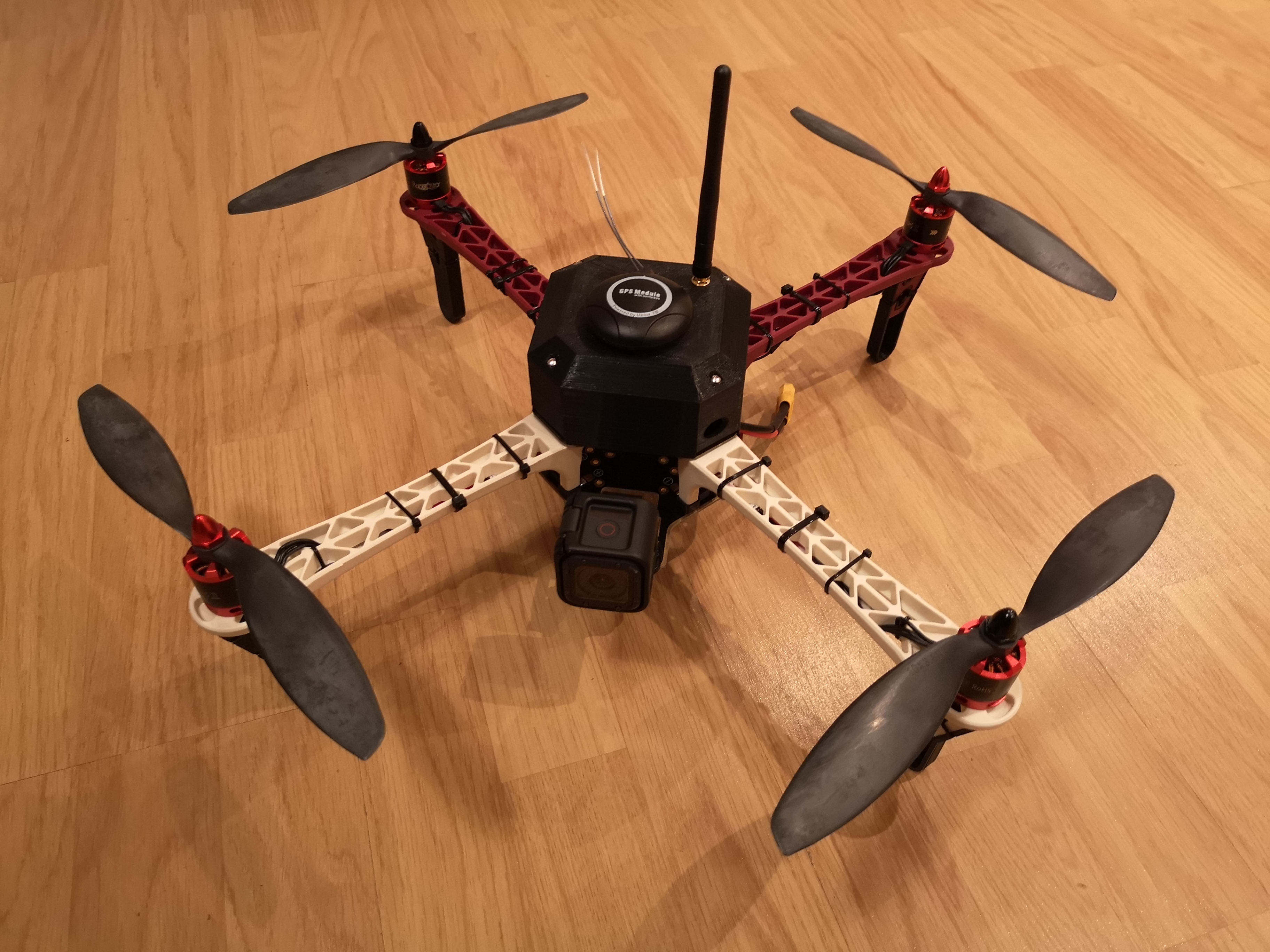

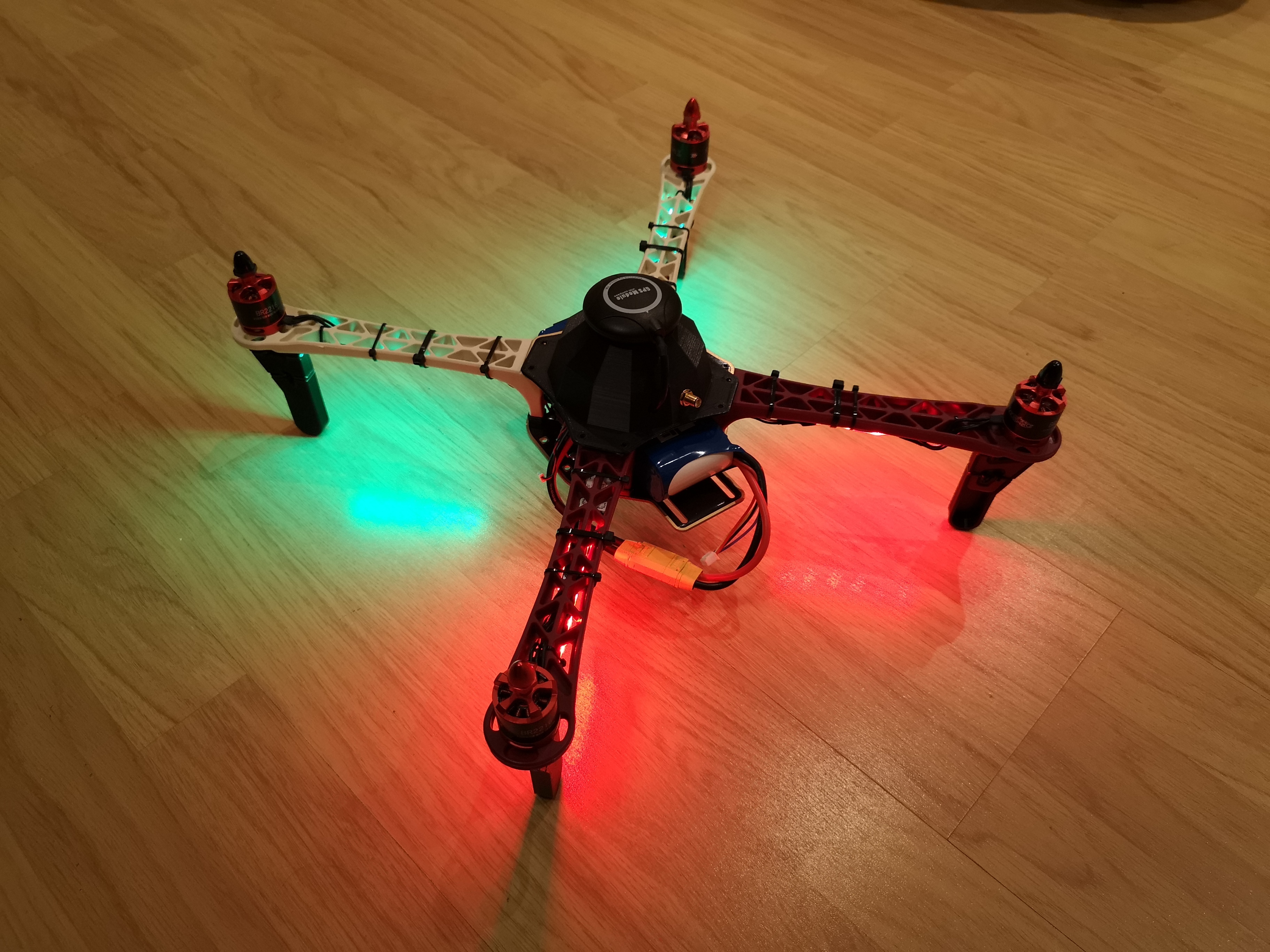

Antenna’s now added, as well as a new battery end-stop incorporating a GoPro mount 3D printed. Had to print 6mm spacers for the bottom plate to allow the 5000mah 4s to slot in inbetween.
I’ve a feeling the GoPro is going to see a lot of the props in video, so i think i might mount the cage upside down. If that doesn’t work, I’ll go about making another to mount elsewhere (i suspect i’m going to need longer landing feet too).
Incidentally, the Housing, and Batt-stop/Gopro mount can be found below
Housing: F450 Drone Enclosure by Rickolas - Thingiverse
Batt/Gopro: F450 Battery Holder with GoPro Mount by Rickolas - Thingiverse
So this is it so far. Not had a flight yet.
