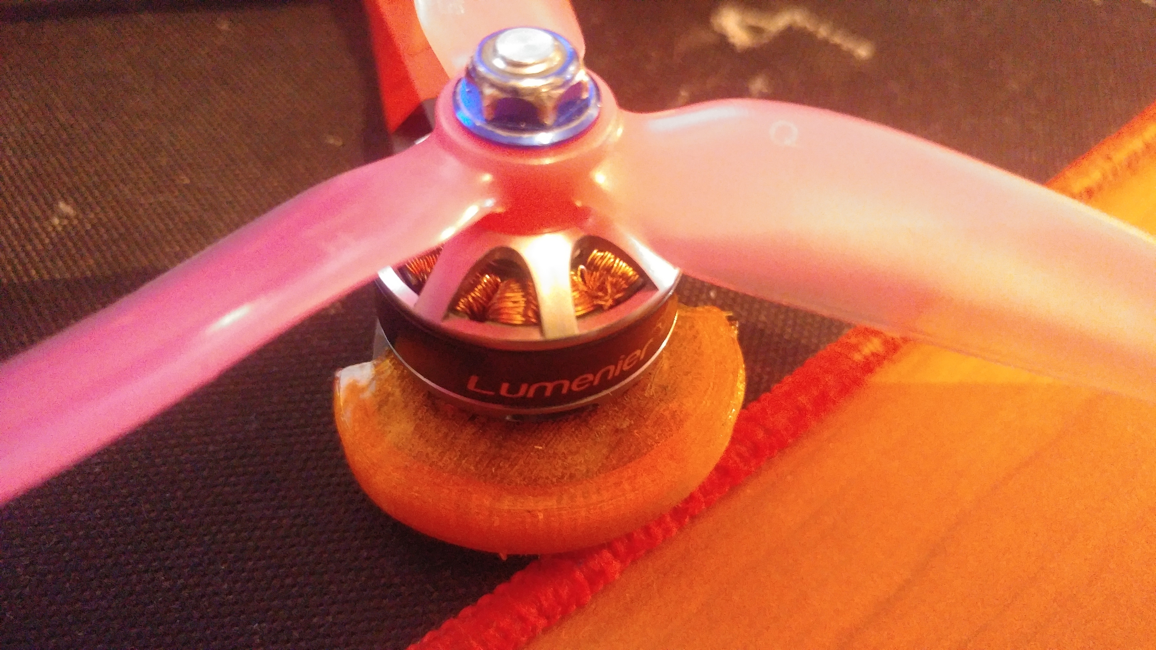

Hi i was flying today and the quadcopter flipped out twice. The day before i changed my props and one of the motor nuts wouldnt tighten up so i used a prop tool that keeps the prop still and i think i damaged the windings. Its the only thing i can think would be the cause as it only started happening since. The motor is a lumenier rx 2206 11 2350 kv and i cant find a replacement for it in the uk. Is there a motor i could replace it with and am i right thinking the wi dings would be cause?. Thank you (:
sorry for the crappy photo the best i could get

Pic is fine but I can’t see any damage to motor bell

It’s possible a magnet got dislodged if you gripped motor bell strenuously.
Dismantling the motor ought to show any problems.
hi i cant see any damage to the bell only to the winding. Im not sure what the correct name is

I would say you have damaged the bell if its made from a soft metal… BUT

Good morning. I changed the setting you suggested and went out to test it. As you said it is fine on rolls but as soon as i try to flip it flips out. Is it possible that the motor could be to blame as it only started once i noticed the damage to the motor in the original photo i uploaded. Although i don’t see any damage to the shape of the bell itself
