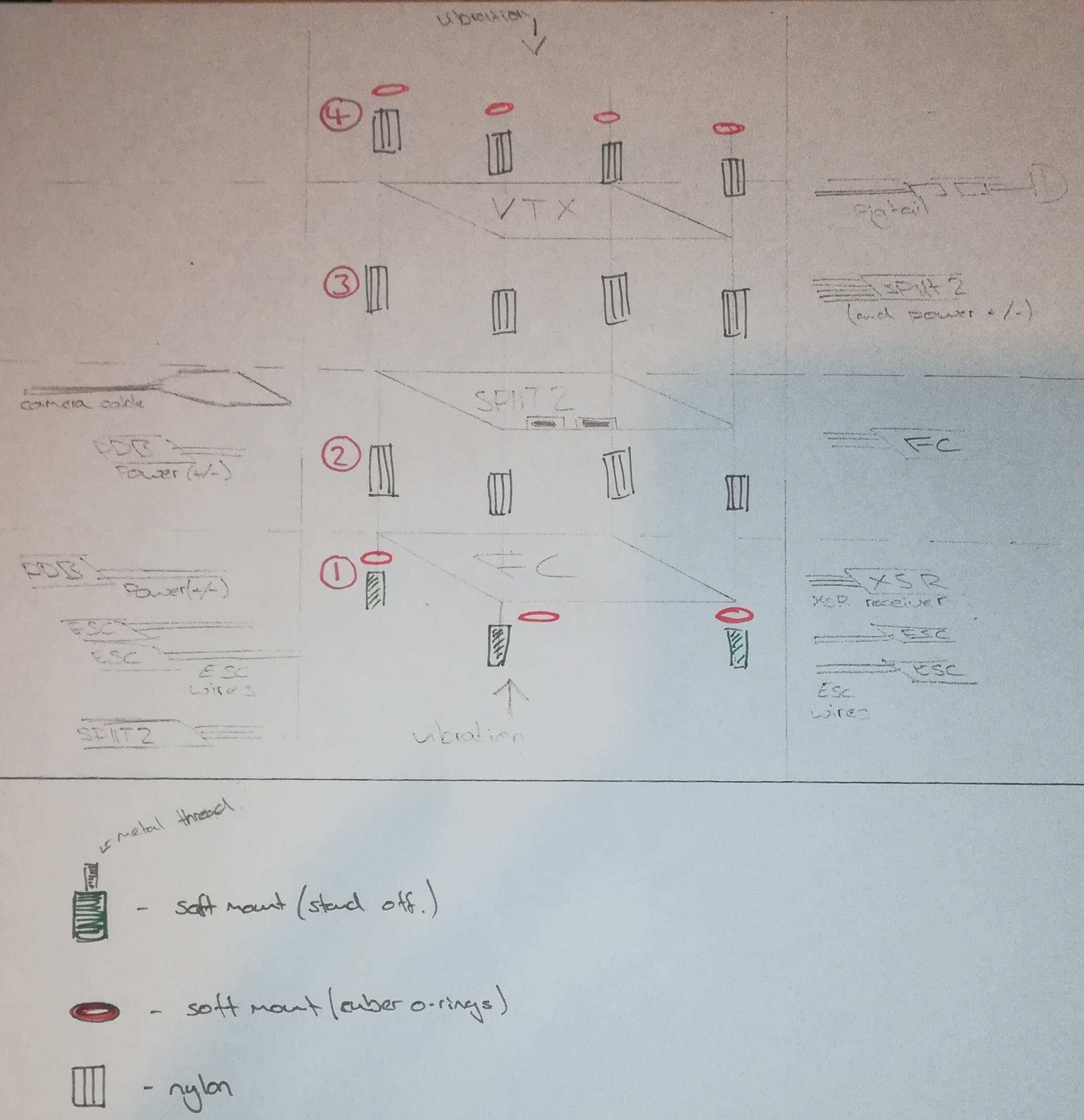

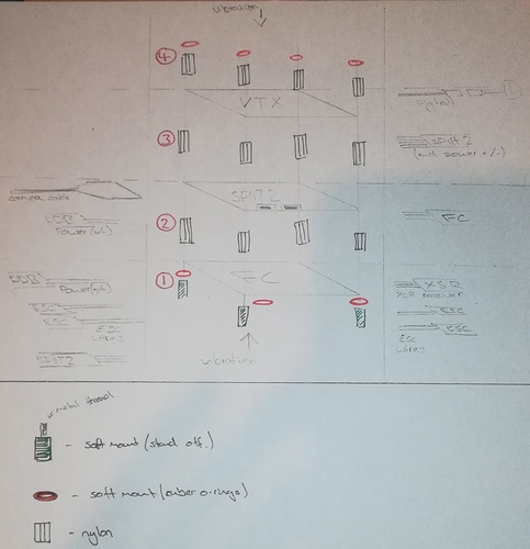

So before I change the mounting I’m getting confused about where so I’ve drawn my interpretation of what it think you said correct if I’m wrong and if I need more soft mounts as that’s all I have currently.
hope fully the numbering can help correct if I’m doing it wrong.
The battery cable needs so be lengthened so it can be strapped to the top plate then.

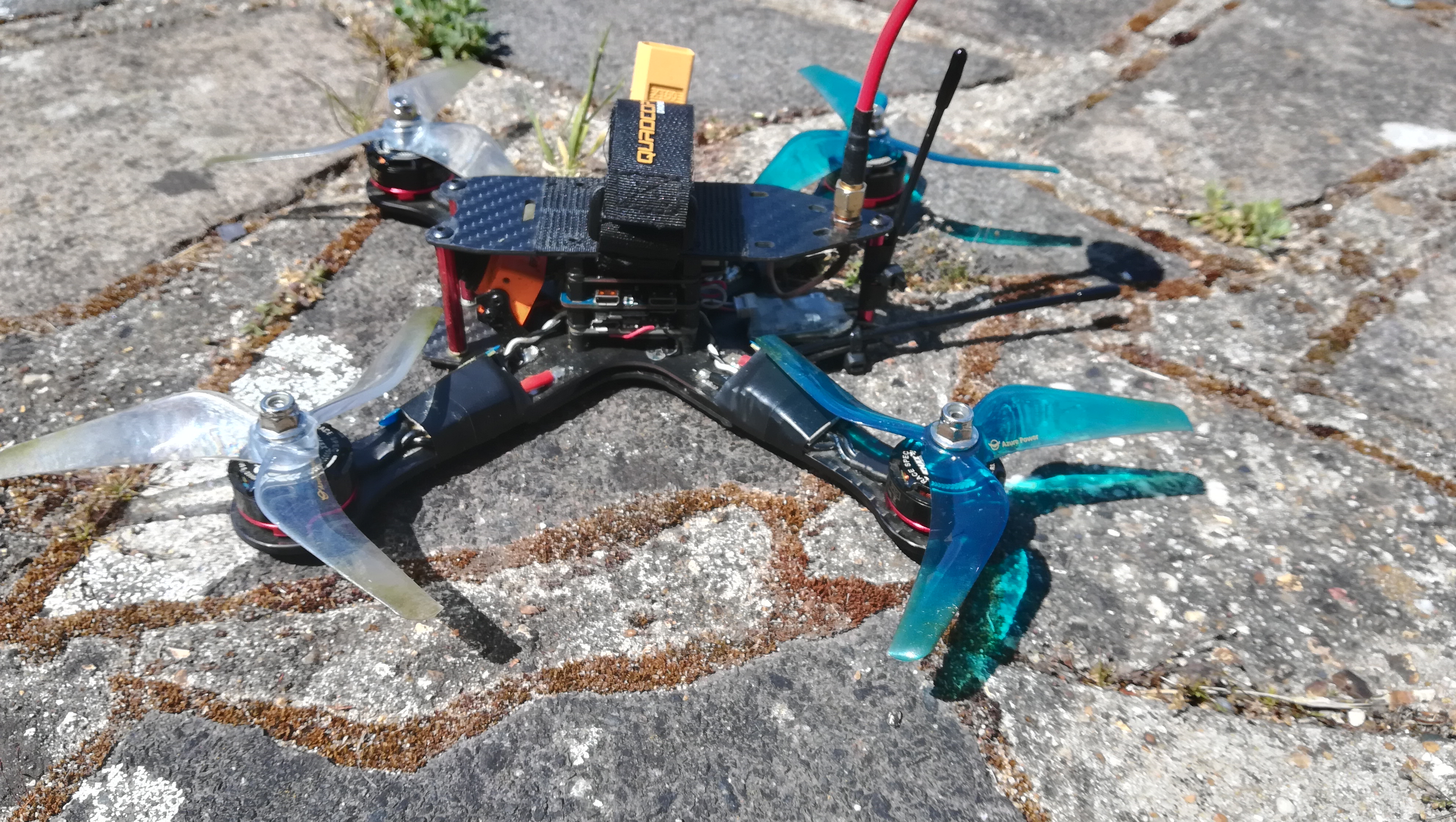

sorry my mistake (your plate above arms is your PDB) didn’t realise you had a RCAM split though this was pdb. in the photo of your quad from bottom does it go FC, SPLIT, VTX. if so thats a lot of stuff above FC should be ok as long as all cables free to move especially the VTX pigtail.
