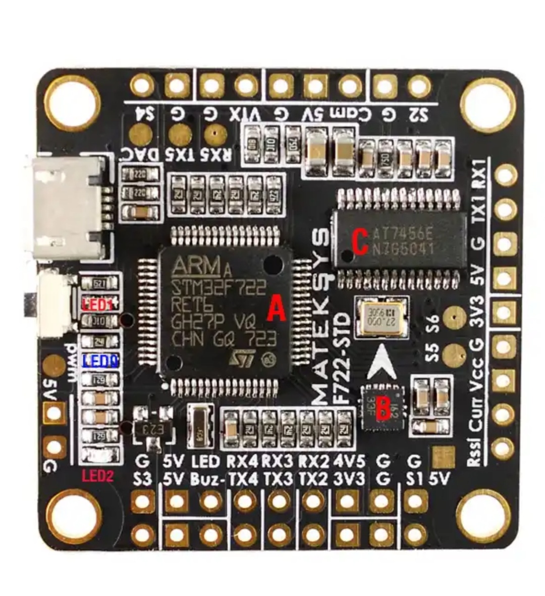

Does anyone know what does led and buzzer port mean in matek f722? is it a power port or a signal port that can be controlled using radio? Like a servo?
talking about the bottom left six holes now, the G 5v and LED on top are for programmable RGB led lights, eg blue disarm red arm, needs to be turned on in config then programmed through led tab.
painless 360 as a good instruction video here https://youtu.be/XdiJQwMIjJw.
Bottom row S3 is for motor 3 signal 5v and buz are to attach a pietzo buzzer that sounds when aircraft lost, low battery etc can be switch on off from radio by switch but must config in modes tab.

It says there is 8 motor support but i only see 7 which including the pwm pad. Anyone know where is the motor 8? How do I actually find out what ports are those codes for example, A02, B02, A00, A01…

you will notice A02 motor 8 is also serial tx2. these are resources the board uses as outputs and inputs.
it is possible to reassign any resource to most pads.
you seam to have a few problems with FC and firmware so being honest i would suggest you leave alone.
you cannot damage it, if you mess it up all that is required is a re-flash and all back to normal.
if you have an old FC practice moving motor outputs to different pads, this is very useful if after a crash a pad gets pulled of.

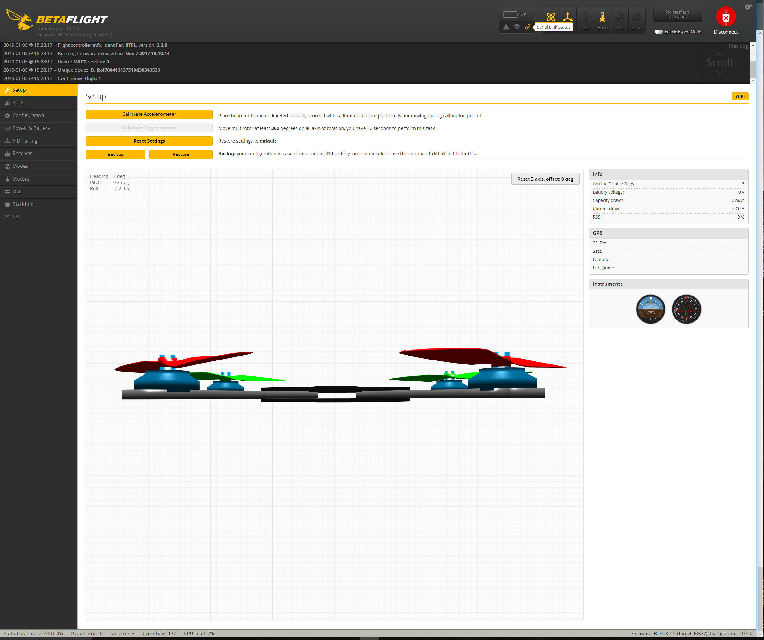

Hello, I am having Similar issue here.
I have the same Mateks f722 FC with the FC-Hub for PDB, and it connects to betaflight with out a problem with the micro usb on my computer for configuring it. But when i try to flash the firmware, it would not connect. It throws “Failed to open serial port” error. I tried changing the wire’s and different usb configuring softwares but still no change.
Also when i am in config mode with betaflight, it states that there are 3 I2C error at the bottom of the page. Could that be related to this issue?
Thank you,

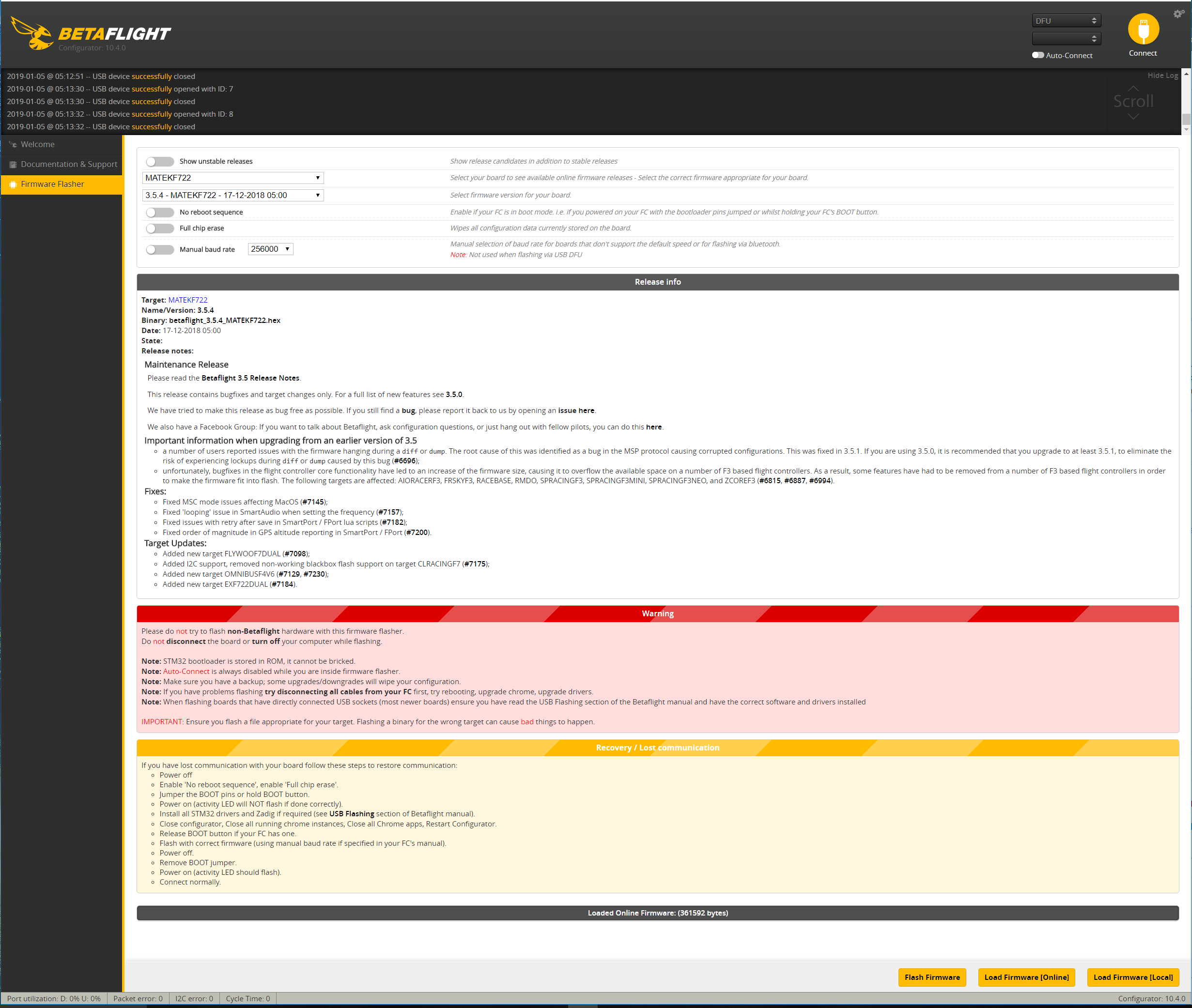

To flash the FC you need to put in into DFU mode…
Unplug the USB cable.
Hold the Boot button.
Then plug back in the USB cabe.
Betaflight configuration should show DFU in the top left corner.

After choosing my board and the latest release of betaflight, I loaded the firmware and connected my board in DFU mode. When I clicked “flash firmware” nothing happened interms of flashing the board. Instead recieved this message:
2019-01-05 @ 05:04:22 – Using cached release information for configurator releases.
2019-01-05 @ 05:04:29 – Using cached builds information for jobs.
2019-01-05 @ 05:04:29 – Using cached release information for firmware releases.
2019-01-05 @ 05:04:30 – Using cached release information for firmware releases.
2019-01-05 @ 05:05:15 – USB device successfully opened with ID: 1
2019-01-05 @ 05:05:15 – USB device successfully closed
2019-01-05 @ 05:05:19 – USB device successfully opened with ID: 2
2019-01-05 @ 05:05:19 – USB device successfully closed
When I checked the firmware on my FC, it is still the old one 3.2.0.
Here is what my BF config look like:
Did you click “no reboot sequence” and “full chip erase”
Looking at you screenshot
It looks like you have loaded the firmware but not flashed the firmware.
Also do as @blackhole says and select those two options
Yes I did load the firm ware and also selected flashware.
I have also tried selecting “no reboot sequence” and “full chiip erase”.
After I load the firmware and click the flash firmware button, it wouldn’t flash the board. and the upload status bar doesn’t show it uploading or anything. I recieved this codes:

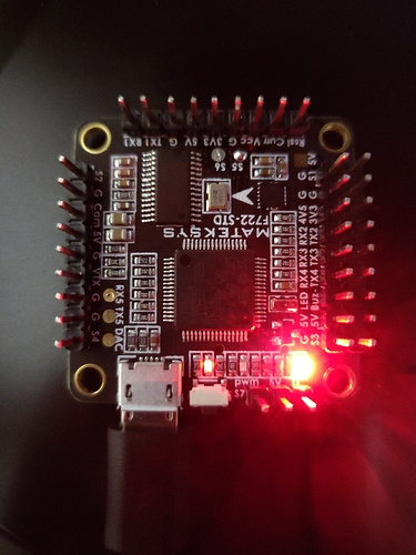

Also, when it is in DFU mode I see one bright red light and one faint red light near the button just like @blackhole did on this pic.
