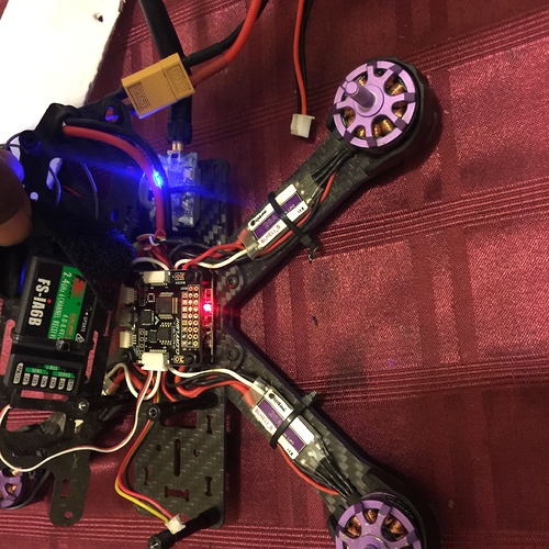

Won’t power on with the battery
Plese see:
It crash into a tree when I look at it it was ok but the it just turn of and on the power board only a solid led on by the 12 v on
use a multi meter on the FC where it is connected to the PDB and see if its getting voltage.
If it is check on a different +5v and -5v pad and see if there is voltage there.
