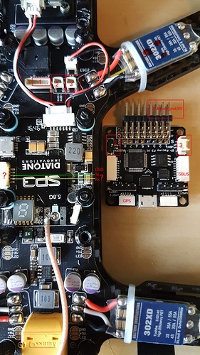

Heres a picture of the frame with the SP3 OSD installed and the three ports in question is marked in red and with the SPRacing F3 board on the right. Because of the size of the SPRF3 board i have to install it on the top of the frame.
Jorn
I know on the SPracing F3, the buzzer can be wired to the two pads on the left hand side of the board. The SPracing F3 also has a voltage meter built in and for this you can wire your VCC to the connector on the opposite side to the buzzer.

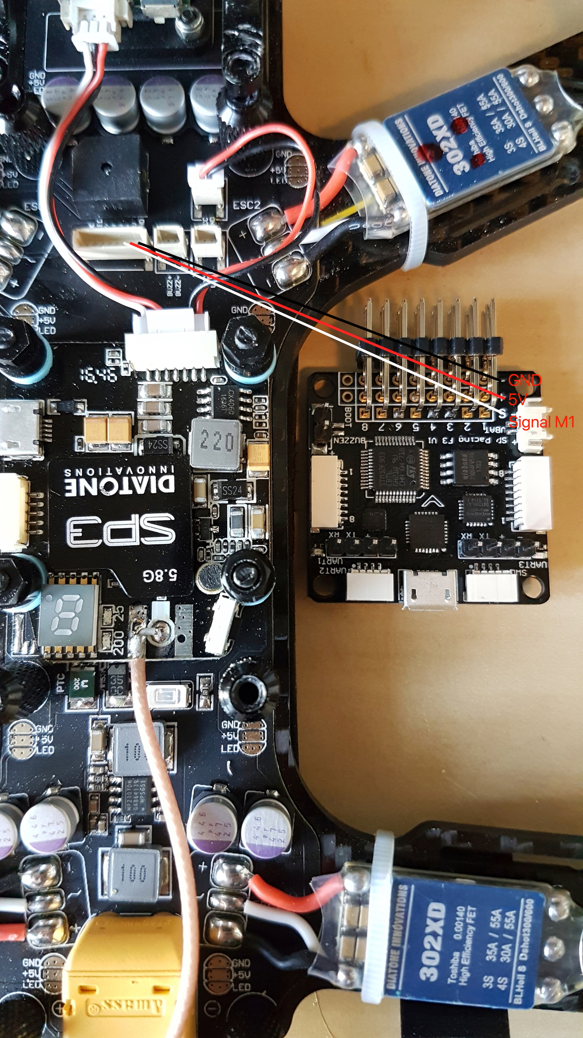

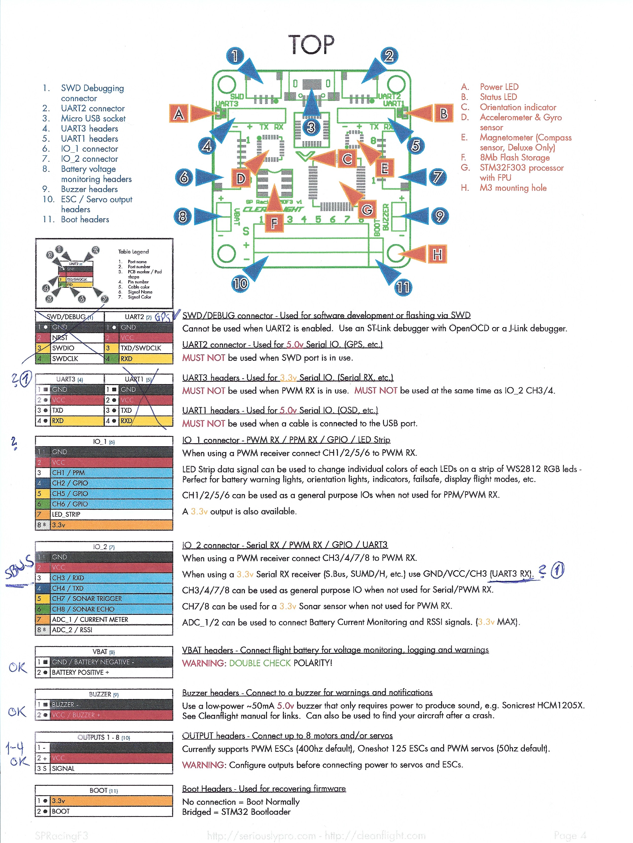

I´ve been drawing a connection diagram for this and that arrised a few questions. I have SBUS on IO_2 connector(7) and it seems like port 3 uses Rx from UART3.
I also want to connect OSD to the FC to see data from the board, but I can´t seem to find anywhere to connect it if i cant use UART3, Rx port for this?
If I understand the FC connection diagram right I can´t use the IO_1(6) connector for this either, or can I.

About the wiring, I have my SBUS wired to the IO_2 connector with GND on pin 1, positive on pin 2 and SBUS on pin 3 (serial RX is set on UART 3 in betaflight).
I have my telemetry wired to the TX pin on UART 2 and my OSD is on IO_1 with the RX on pin 5 and TX on pin 6.
For this to work you must have soft serial enabled in betaflight and enable telemetry on soft serial 1 so that the OSD can display it. You will then be left with another soft serial port which are pins 7 and 8 (TX and RX respectively) for another use.

If I understand this right… I´m setting the FC up with INav with a GPS on UART2. Can I then use port 7 or 8 on IO_1 or IO_2 for Telemetry with soft serial enabled?
Jorn
Hi Jorn,
Your GPS seems correct but I think you need to connect the telemetry to the TX pin (pin 8) on IO_1. This should work for smartport telemetry (frsky). OSDs can vary I believe.

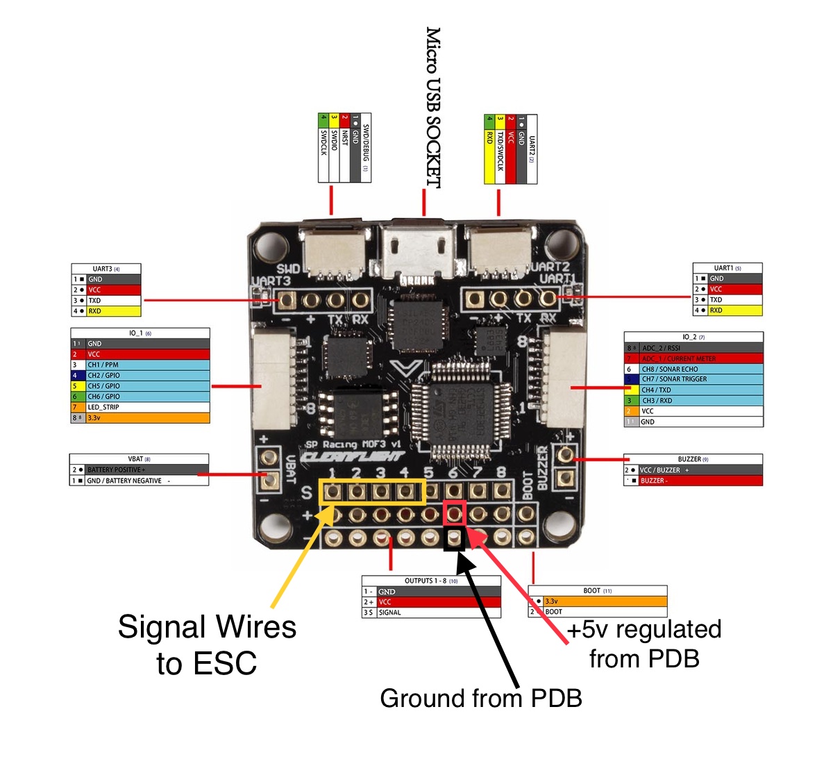

Have you powered the board with 5v regulated power from the PDB? I have connected this to an unused positive and ground motor pad. If you haven’t done this then it may explain why the quad won’t arm.

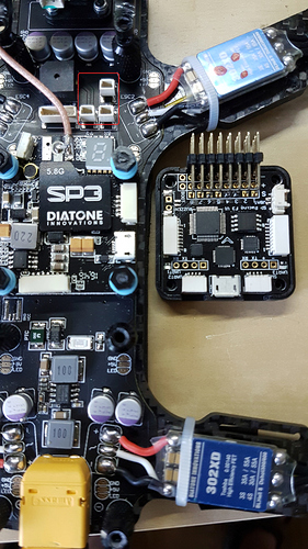

I´m powering the FC through the same 5V and GND as the old Diatone Fury F3 board was powered through as shown in the picture.
I´m not sure what you mean by an unused positive and ground motor pad? Do you mean connecting to a 5V on the solder point for the LEDs and the GND to the ground on the ESC?

I power my FC like the image show below.
In betaflight or whichever configurator you are using, have you enabled MSP and selected to correct bit rate for your OSD on the correct softserial port? I thought that I enabled telemetry on mine but it is the MSP that needs to be enabled.
