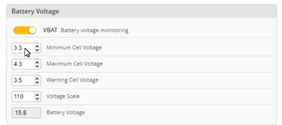

Its does sound like your FC is damaged and its not reading the correct voltage but its getting the correct voltage as the rest of your hardware works.
Betaflight is detecting a low voltage and stopping your from arming.
There must be a way to shut it off.
Check you settings… or try turning off VBAT
