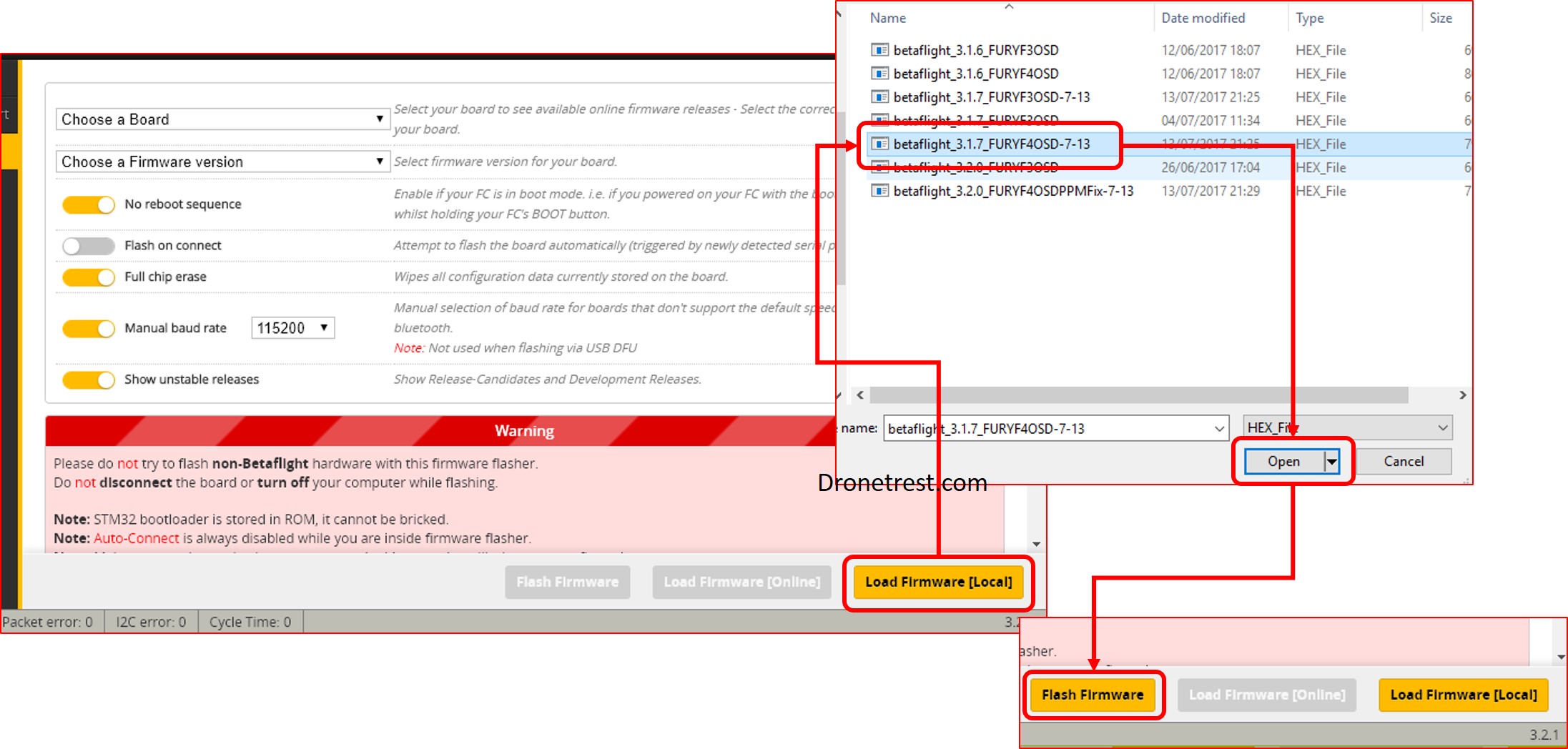

Flashing a manual Target if the built in firmware flash fails
  • For now you just need to download the precomiled firmware file (.hex) from diatone directly. While here you should also download the GT2 2017 settings file (for the custom PIDs etc..)
  • Download the Fury Flight control Firmware, within this file you will see a bunch of .hex files with the betaflight version.. at the time of this post you can flash either 3.1.7 (stable) 3.2 (cutting edge, but potentially has bugs)
  • In betaflight, on the firmware flasher tab, select (Load Firmware [Local]) and then select the .hex file you download before.
  • Once selected the Flash firmware button will turn yellow so you can start to flash it just like with any other FC.

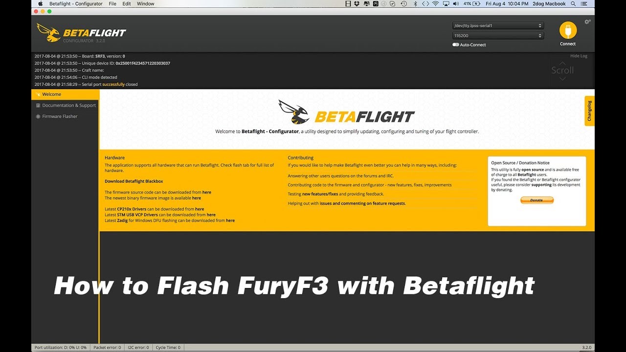

Update: just found a nice video showing this process if you prefer video format :slight_smile:
