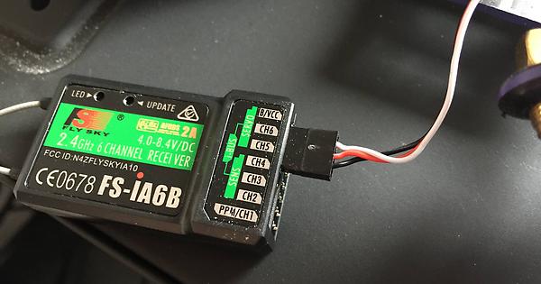

I have a Matek F405 CTR FC and I would like to hook it up to a FS-iA6B receiver. I keep getting lost in the terminology.

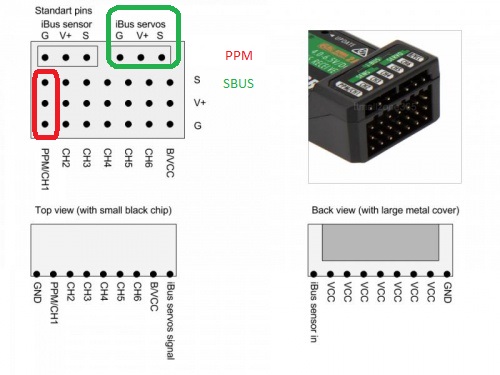

500px-FlySky_IA6B_pinout-f89eed4f

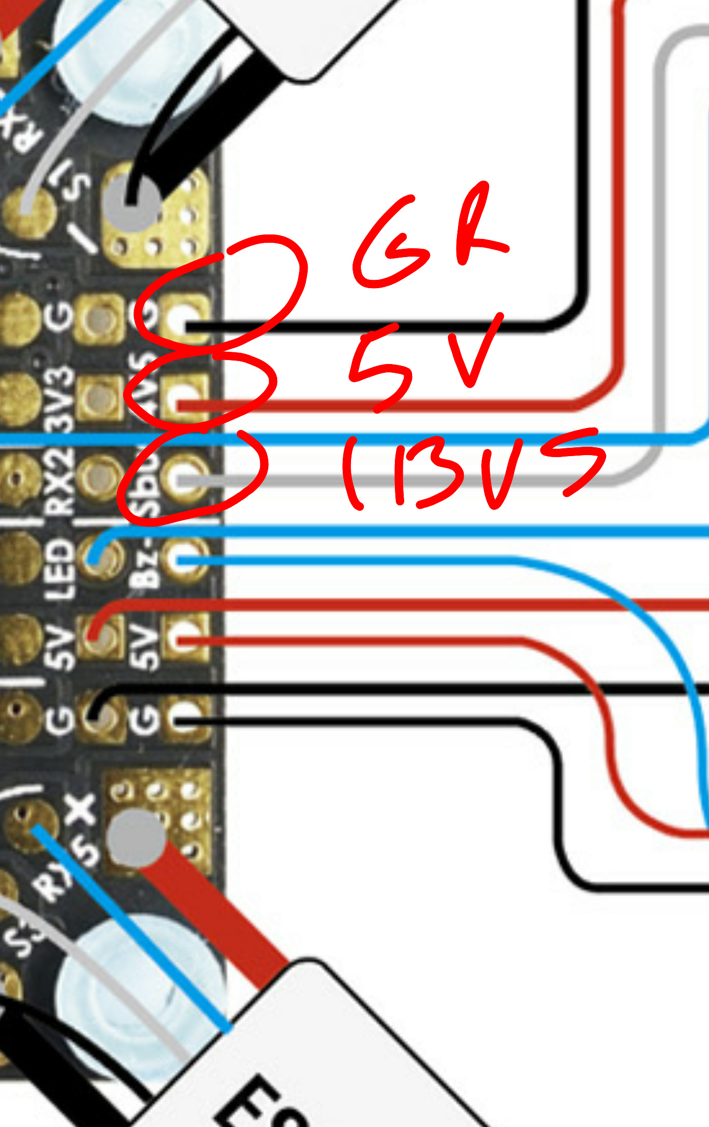

Just connect ibus from photo above to sbus on flight controller. Ignore sbus from photo
If now dont work you have to change settings in radio or betaflight

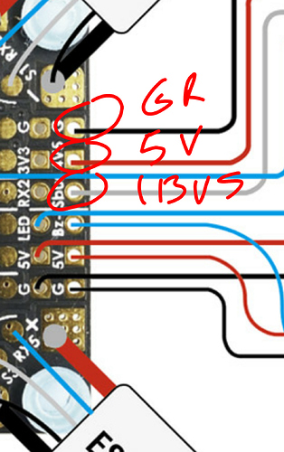

Soo receiver should be connected like this
vFvmp0c
To flight ctrl like on photo before.
If its like that its setup problem. And your setup looks ok for me .Maybe change in transmitter for new model, bind receiver again and check if this will make any difference.

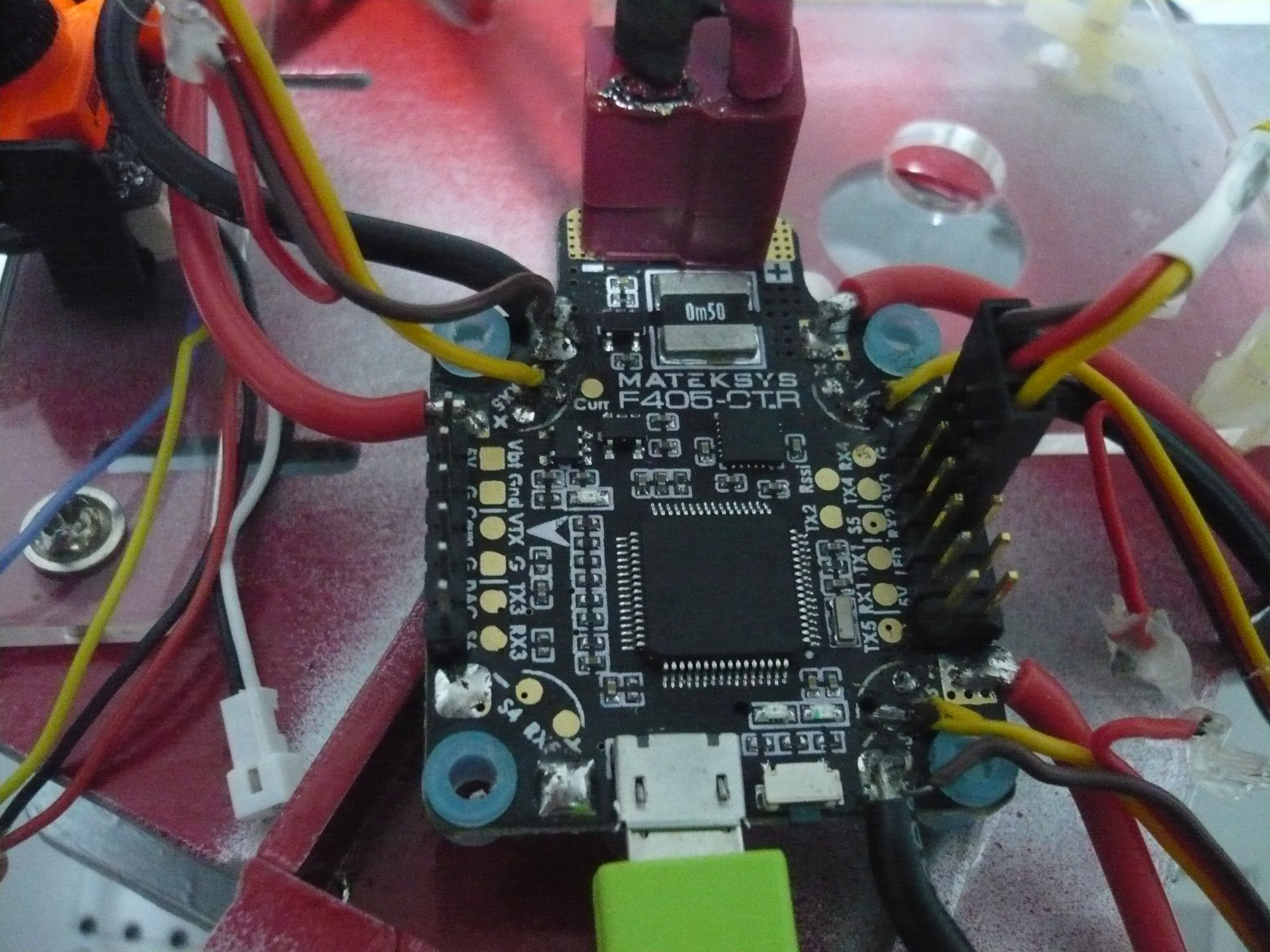

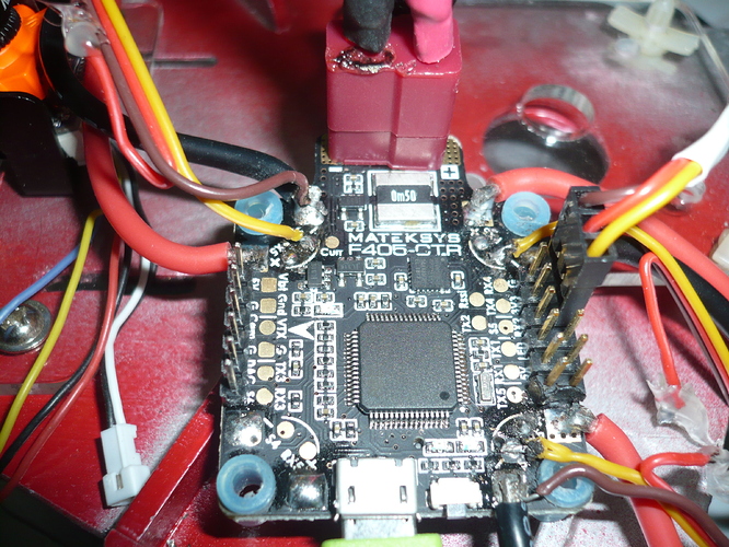

Here are a couple of pictures of the board.

  1. Is the led on receiver on.
  2. Led light on receiver is flashinh or its still ?
  3. In tranmsitter configuration Should be output ppm serial ibus.
  4. Is the transmitter see receiver ?
1 and 2 LED receiver on and solid red
transmitter set to ppm sbus
Yes, the transmitter does see the receiver.
