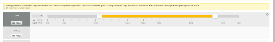

OK, I have set the ARMs tab to 1225 to 2000 and saved it. Now what?

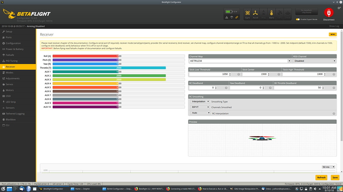

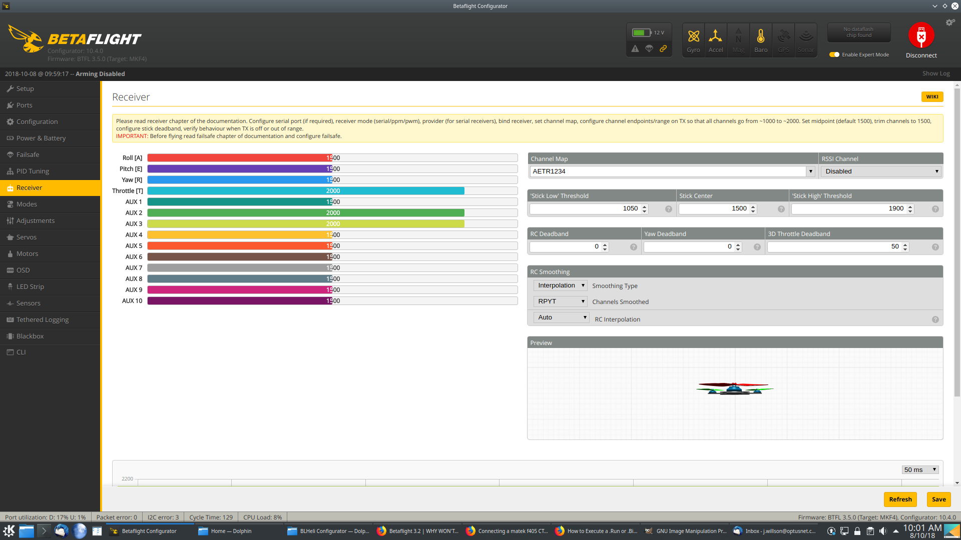

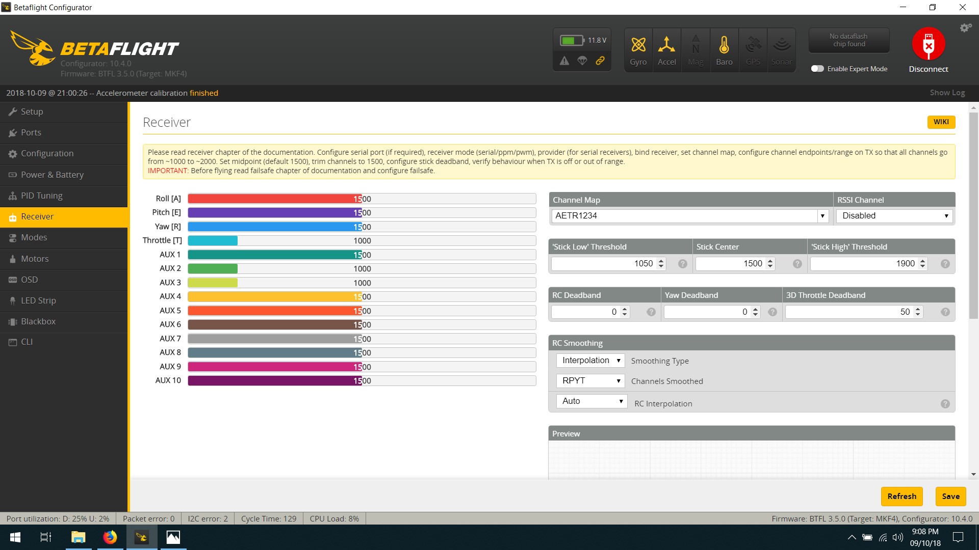

AUX channels are working as expected now⌠1000 - 2000 on the RX Tab
What about your - Roll,Pitch,Yaw and Throttle channels?
Can you do a screenshot of the RX tab and Modes tab?

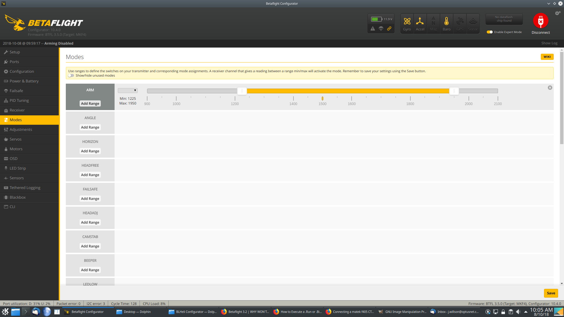

Here are the screenshots you requested.
I should point out that Aux 2 and 3 are only on full (as shown) when I flip switches âCâ and âDâ
The Yaw is actually a connection from a servo motor directly to the RX channel 4. That works perfectly and I can switch the yaw from side to side, going from 1000 to 2000 via the TX.

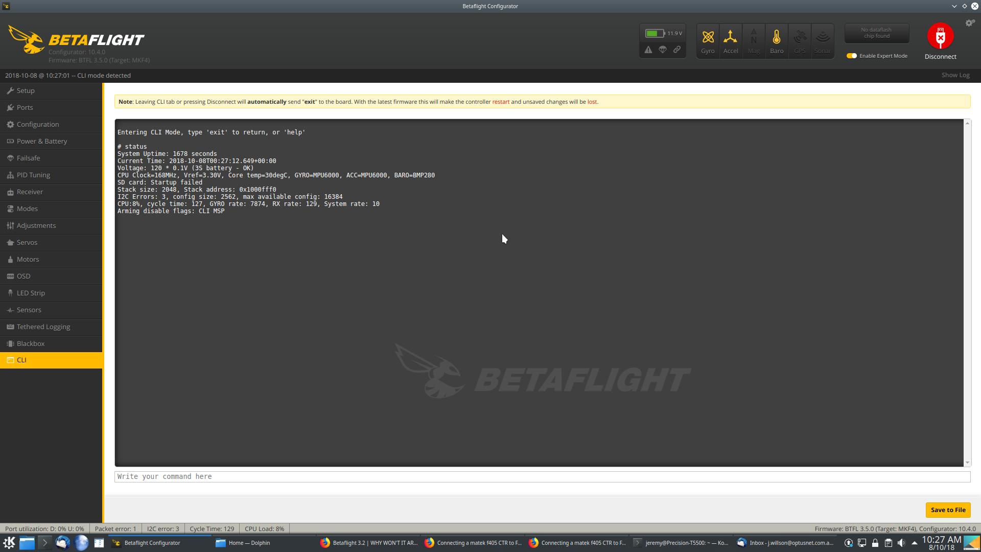

I also include a shot of the CLI after a STATUS query

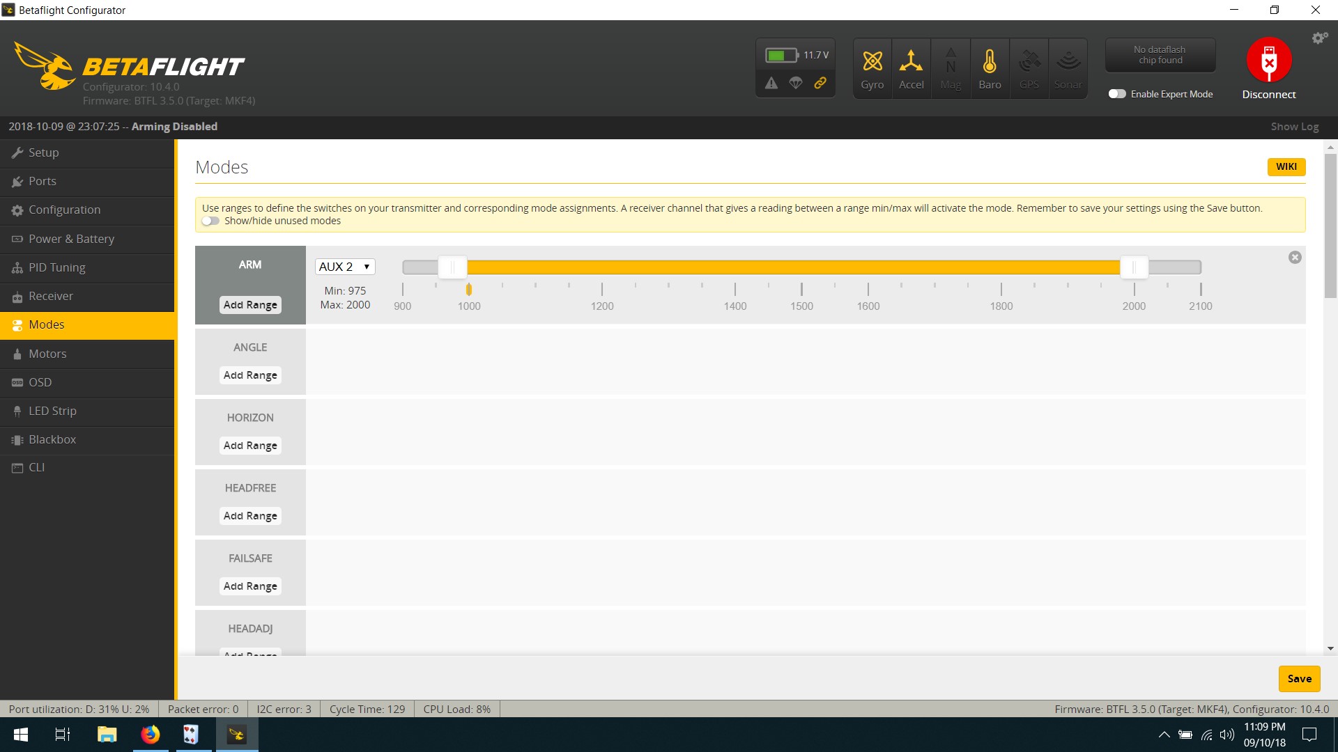

You donât have a switch assigned to arm.
Try setting it to Aux 2
and when you switch it⌠the yellow marker should move

I have set the arm switch to aux2.
The yellow marker does move and the centre point depends on the position of the switch âCâ On the screen with the switch off the marker is at about 1000. Middle position at 1500, 3rd position 2000.

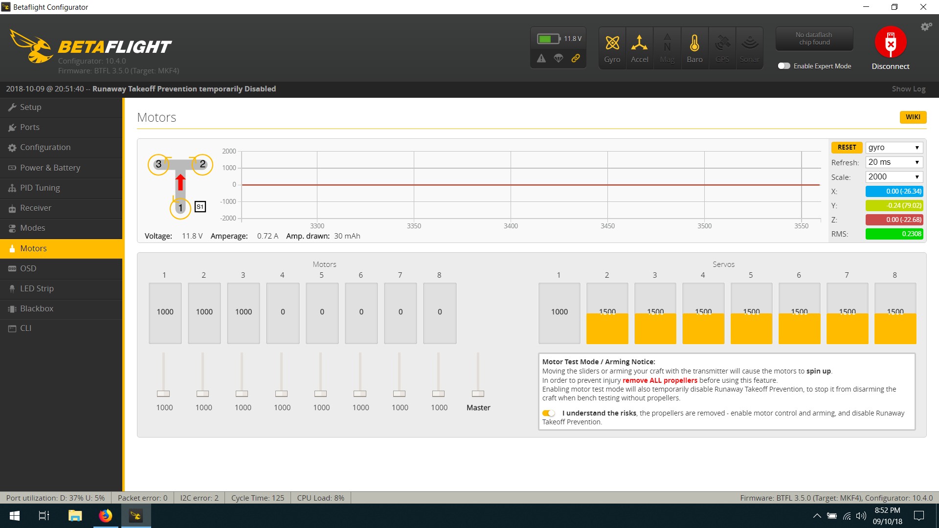

On the motors screen, I notice that the first block is now at zero; this can be moved with the throttle on the transmitter.
On the previous post, I put the throttle to 2000 to show that it works.

I donât really know why, it could have to do with my changing the arming range to 1075 - 2025 but I donât really know.
