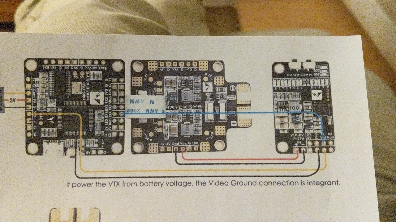

VTX or Camera problem or both :
I have striped it down and built it again, better this time, paying attention too the quality of soldered joints and board positioning on the frame. I have also decided to move from the 4in1 ESC I had to the, more conventional, one on each arm method (they haven’t arrived yet).
The problem now is the lack of video output. I have a Matek VTX-HV, Runcam Eagle 3 camera & Eachine 5.8ghz receiver (ROTG02). My only compatable UVC Android device displays a snowy screen but no meaningful camera image. Both the VTX & Camera are running extremely hot. I have put a small heart sink on the VTX.
I am stuck not knowing which way to go without some testing method that helps pinpoint which, if any, unit is going wrong. I have watched endless videos, done much testing for continuity/voltages etc. nothing!!

Do you at least see any OSD?
Only the “snow screen” as described (like your TV with no signal). No defining image at all.
Get BlueMail for Android
You could try hooking up the video from the camera straight into the vtx
That works!! which proves the camera & VTX are working. They still get hot though but I suppose once it’s flying around the air flow will keep it reasonable.
The next problem is why it goes wrong when built up with the rest.
I copied the Matek wiring to their picture, see attached. TX4, Uart4 setting in BF was set to IRC Tramp. I can only think I missed some settings somewhere.
I have a working camera now, I have moved the yellow wires from the FC, they went to the ‘cam’ & ‘VTX’ pads, and joined them directly. The result is NO OSD info, nothing. Not surprised really as there is no connection with the FC unless the TX pad on the VTX to TX4 pad on the FC connection is the data route. BF Port setting reflects ‘IRC Tramp’ on TX4.
I have attached 1cm heatsinks to the ‘VTX’ & ‘Camera’ in an attempt to reduce the heat produced.
