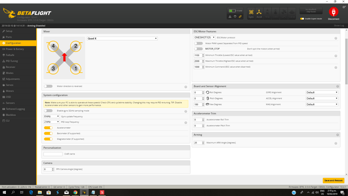

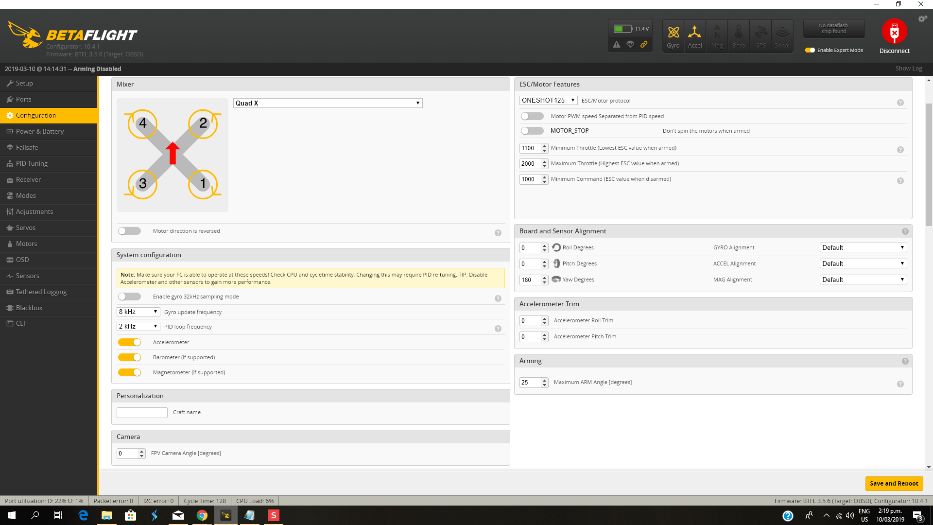

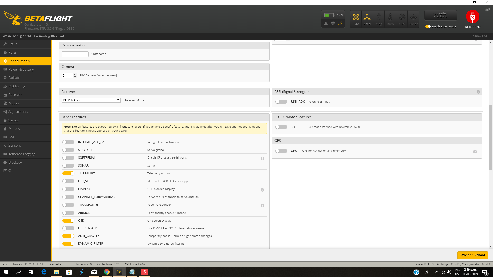

Alternatively can you post a picture of the betaflight config screens for ports and configuration?

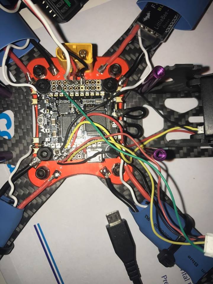

Also can you please let me know the flight controller make and model - and if you can a picture of how you have them wired up - the actual board if possible…

If you sort out please check your ESC signal wires, the one to motor 3 is SO CLOSE to shorting onto the FC ground

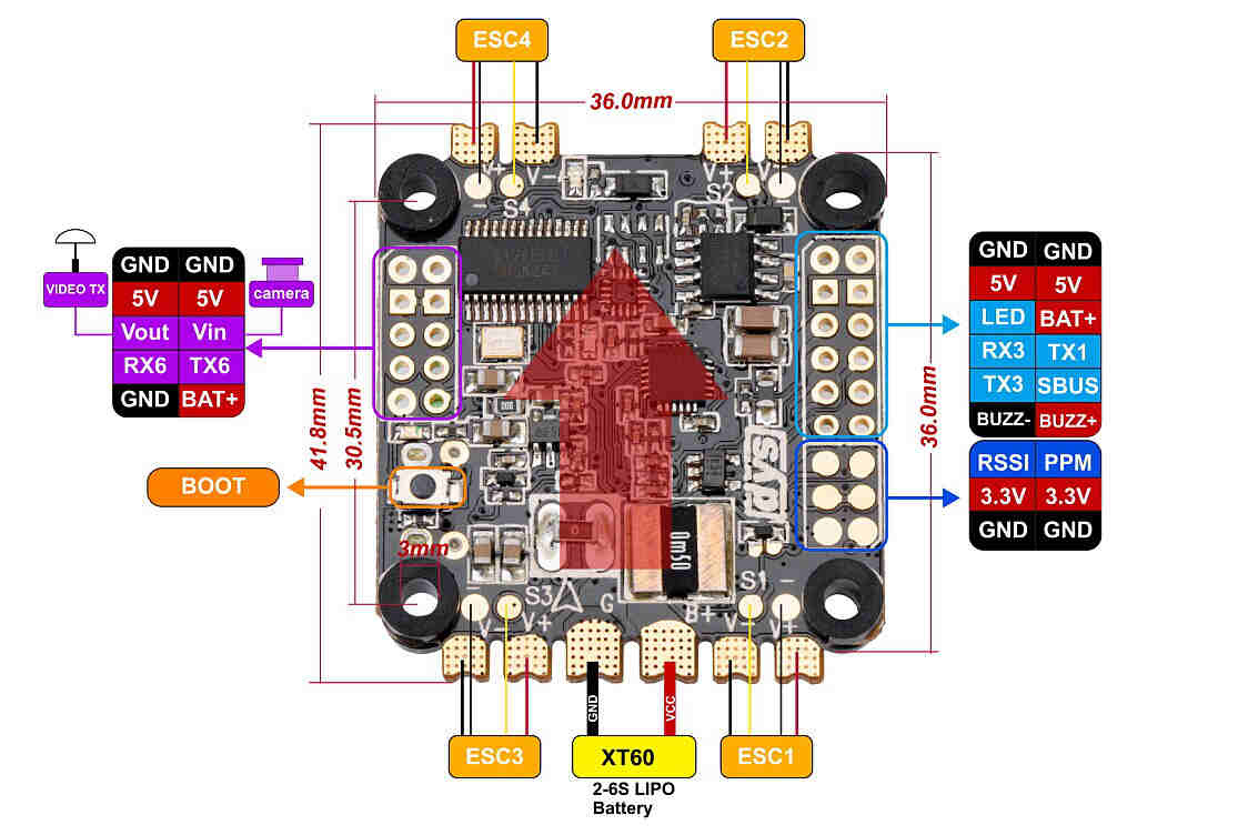

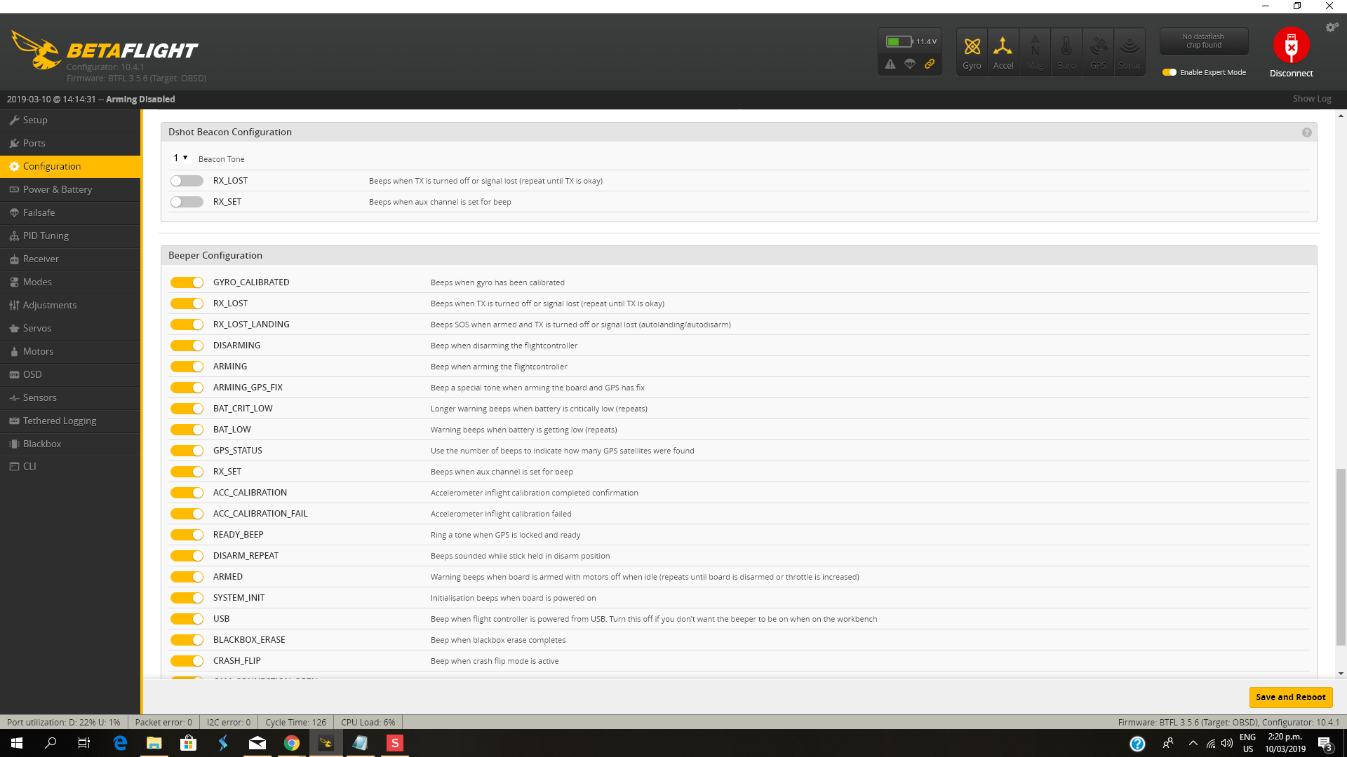

do you have a pin diagram for your FC and a screenshot of the config page you could upload.

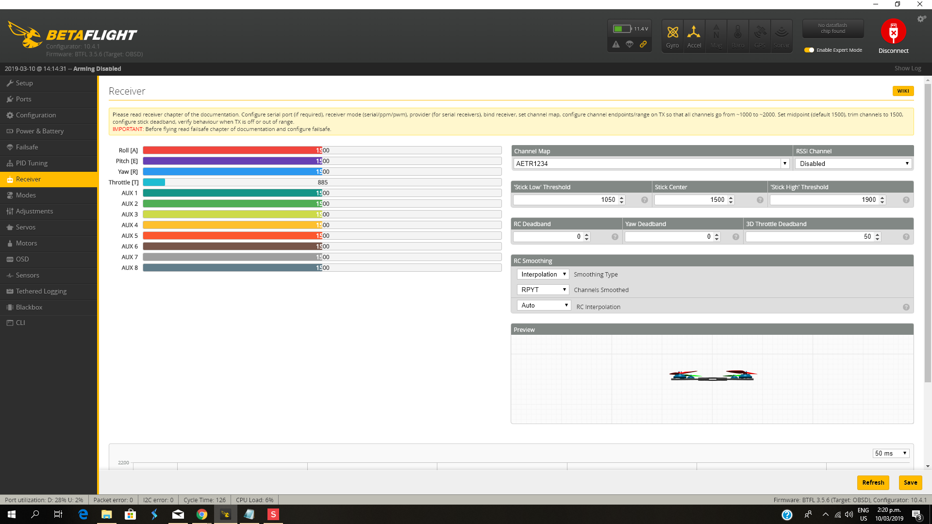

also you say you have no movement on the receiver tab in betaflight, do you have coloured bars that sit at 1500?
also double check your board align, 160 is strange, norm is 90,180 or 270!
Ha your absolutely right I don’t know why I put it at 160. I’ll change it to 180. I am pretty certain that it is bound but I think I will try it in one of my planes. Also I’ll get you the screen shoot next time I get a chance to get on

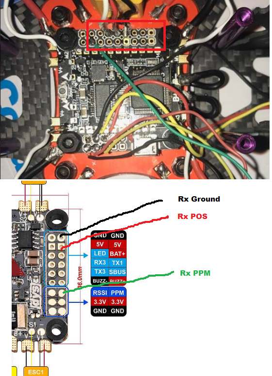

Looking at the picture of your FC and the Pinout of the FC you have your Rx connected in the wrong place.
Top is where it is
Bottom is where it needs to be
Give that a go
Also double check the pinout… the Pinout picture doesn’t match your FC… its close but not the same
Ok i have moved the signal wire from the receiver and i now have movement on betaflight. But i cant seem to spin the motors up with the remote, they are working when plugged into betaflight and move them on the motor page.
how have you got the FC to arm?
If on switch make sure when you switch to arm the slider moves to the set area.
If not you need to min throttle and yaw right to arm.
neither method will arm if throttle above 1000, make sure throttle is below 1000 at idle if not use menu on transmitter, use endpoint to set.
