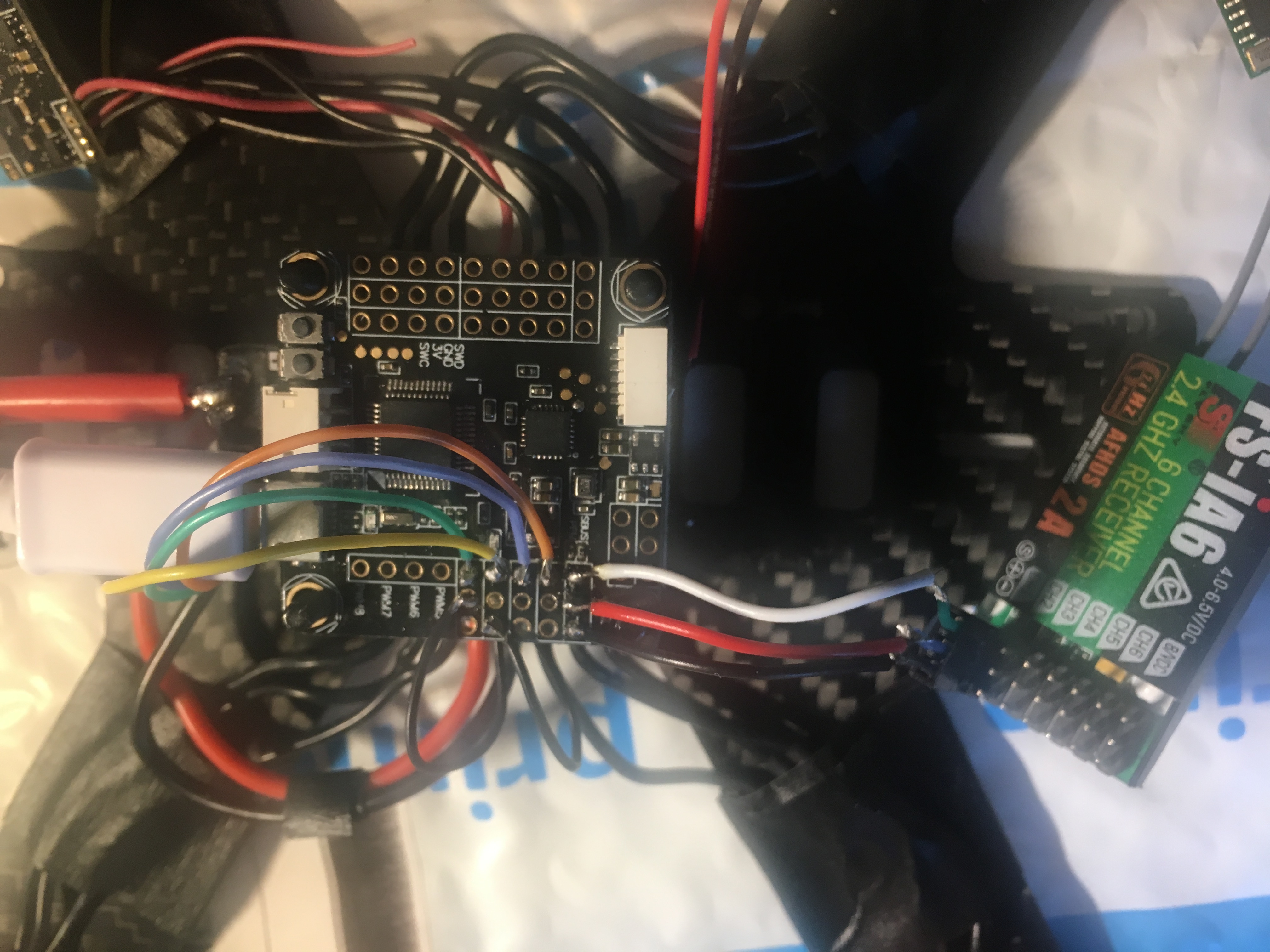

The FlySky ia6 receiver only outputs PWM meaning you need to use all outputs for all channels, not one. It doesn’t do PPM or Sbus/Ibus. If you are looking for 1 output for all channels, you’ll need to change your receiver.
Info here Flysky Radios 🎮 and Receivers 📻 for FPV Quadcopters - Which One about 2/3rds down the page.
Omg okkk thank you so much!! I’ll try that!

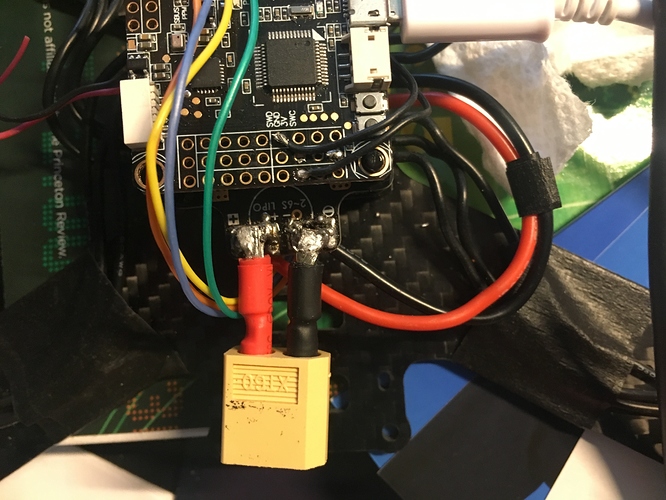

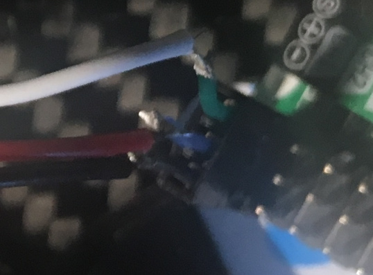

Carefully of those wires… I would redo them and get some heat shrink around them
If they short out against each other your will have a bad day…
Well spotted! Bad day indeed if they short out
Oops…LOL got it thank you!

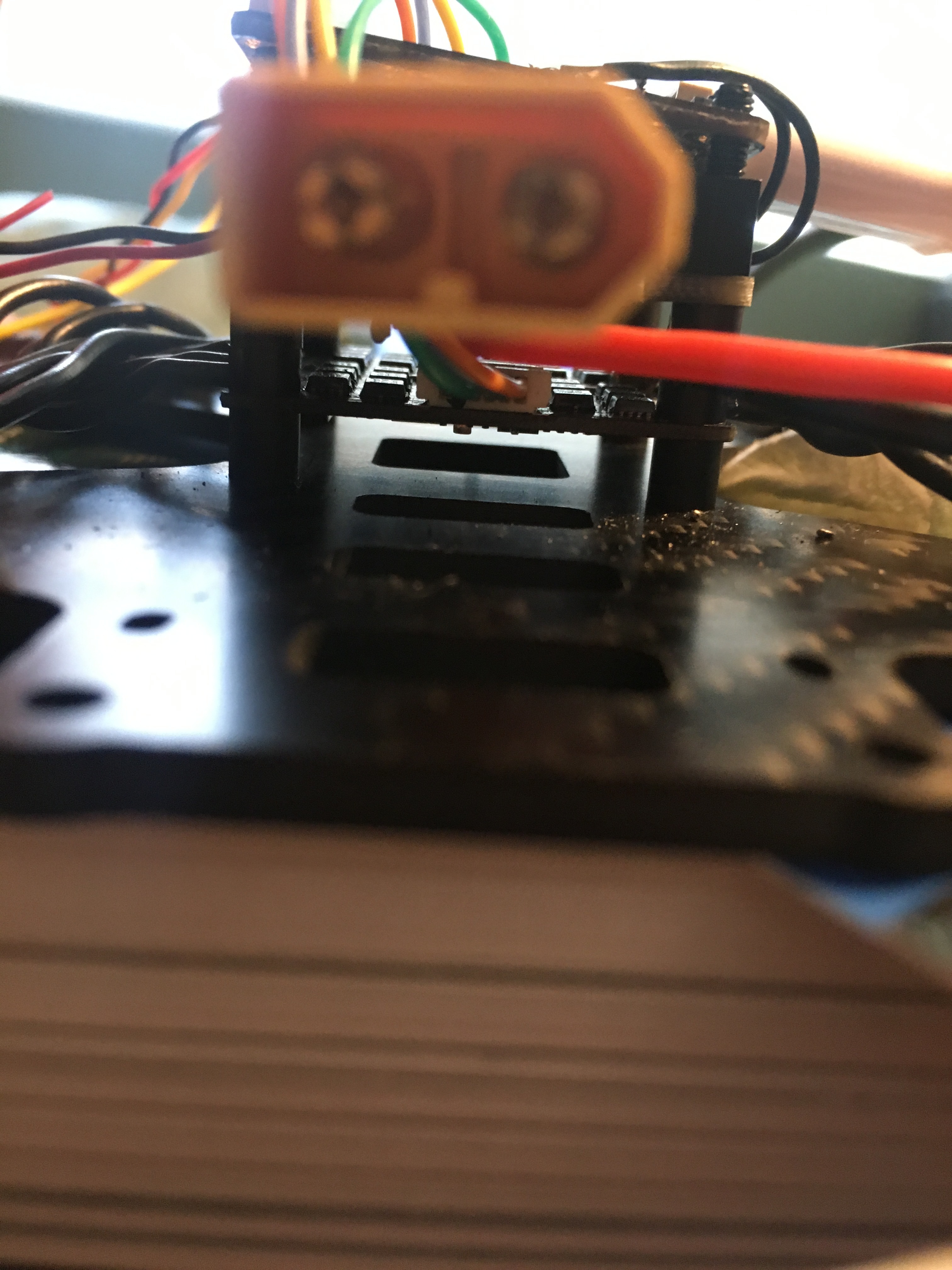

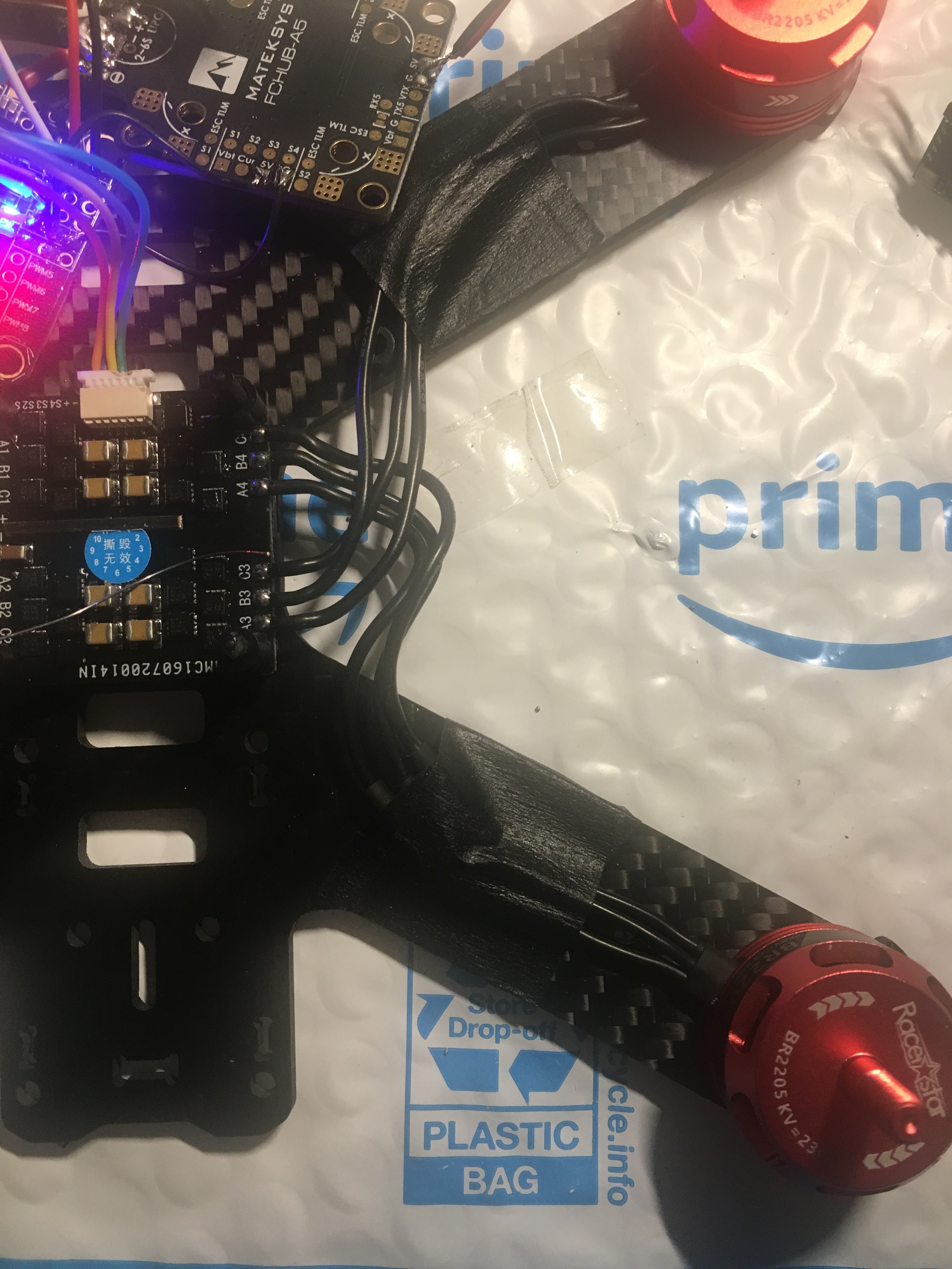

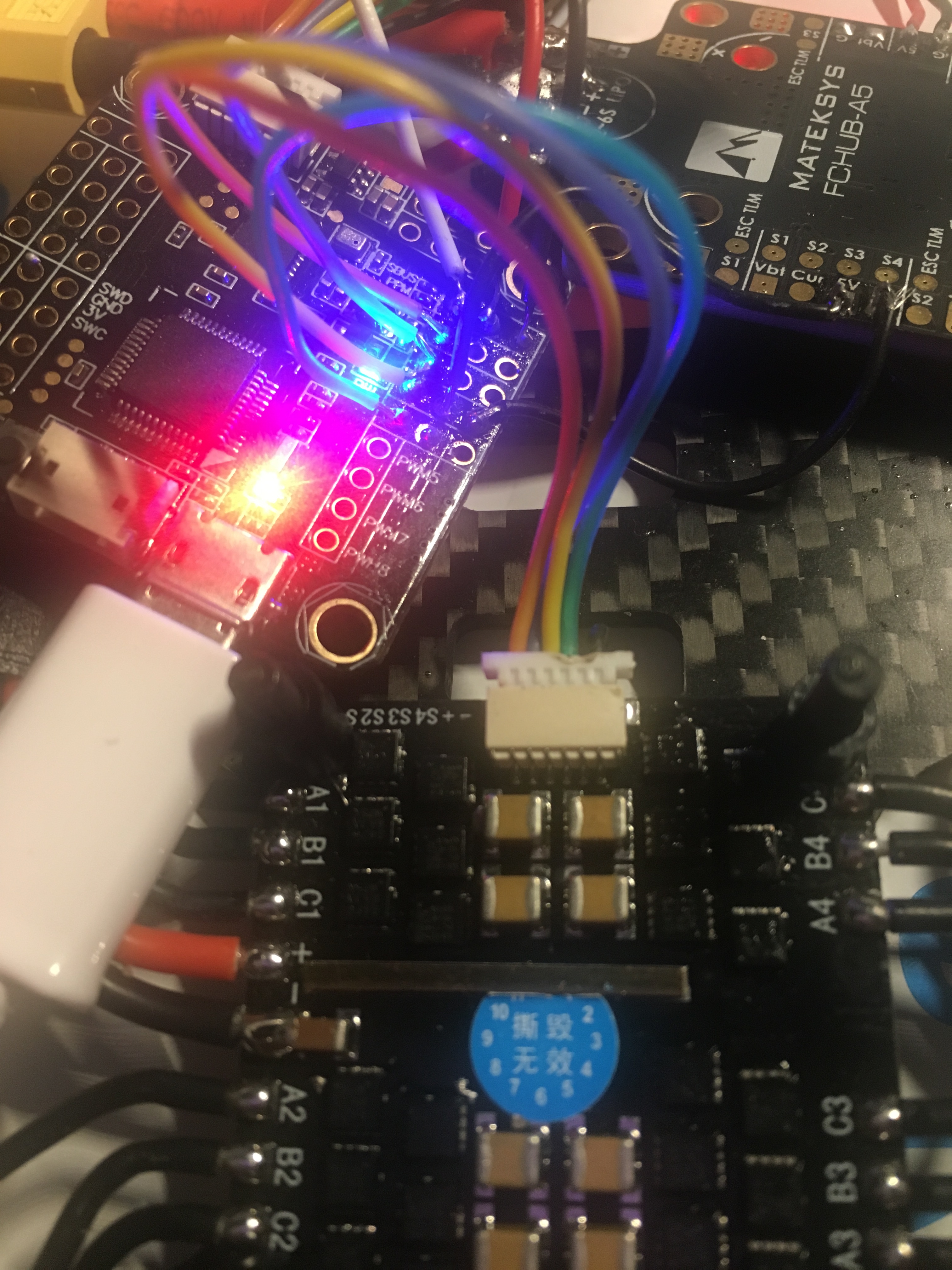

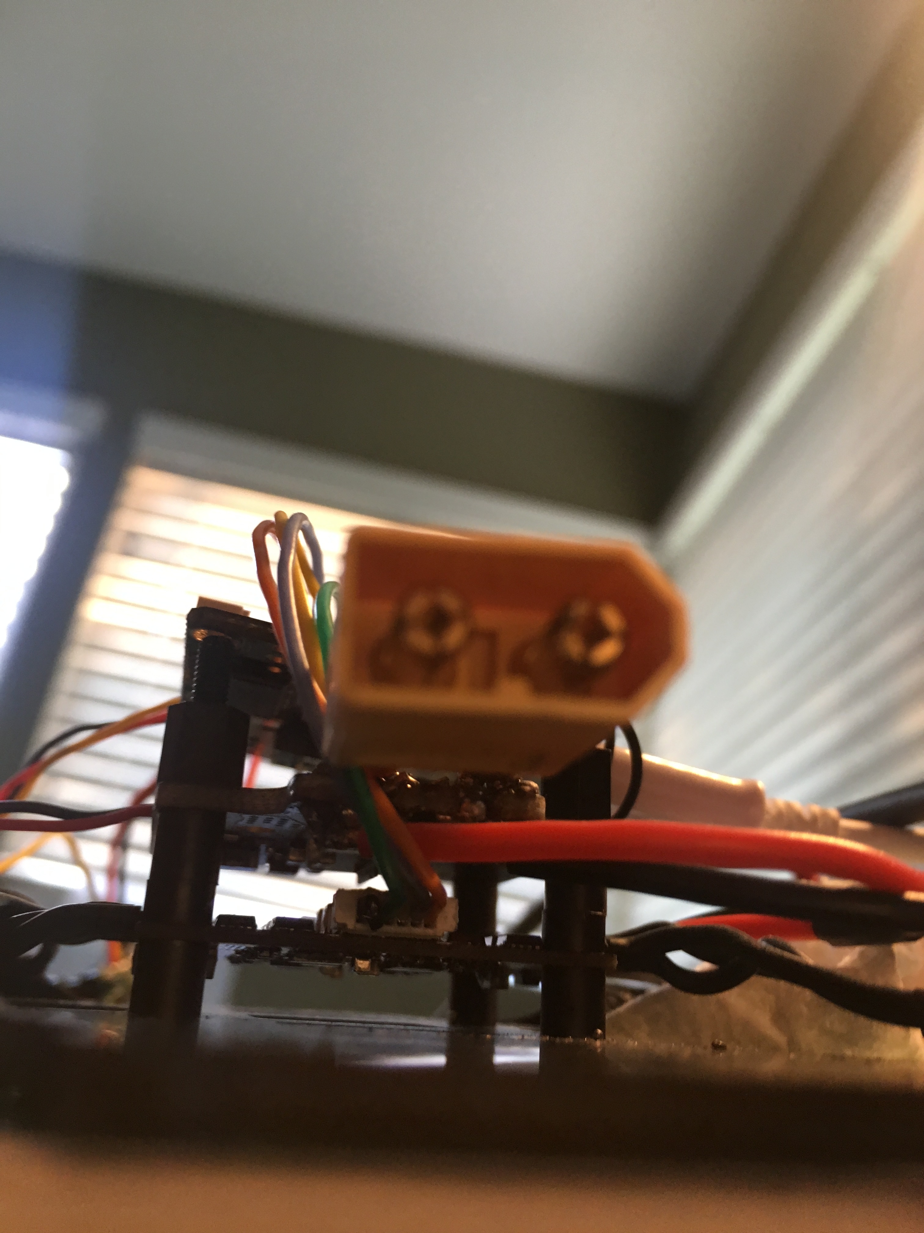

I soldered pdb’s grand and voltage to both esc and the battery wire, one on top the other one on the other side, hope that is not a problem??
Can you take a photo of what you have soldered what to please?
Also, have you changed the receiver yet?
You can’t arm you motors via the transmitter when connected to betaflight its a safety feature.
You need to take your props off, - Go to the motors tab - and click “I have removed my props”
Then you should be able to arm from the transmitter.
Not sure what you have done there… Can you post a picture… ( little worried here)
