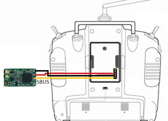

You dont need to desolder it as you can just hook/solder some wires onto the smart port connections. Whirlybloke on youtube had a nice guide showing you how to do this
Here is a diagram to help
