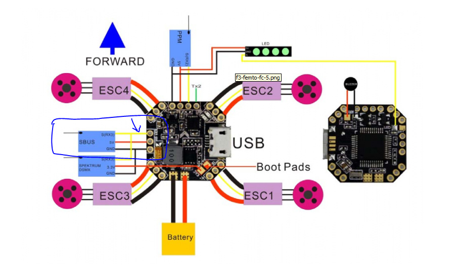

@sletrc42
you connected up like this?
※UART3 (RX3)
Use for Spektrum Satellite RX, Spektrum 1024/2048, SBUS, XBUS, SumD and SumH RX, etc.
https://www.unmannedtechshop.co.uk/emax-f3-femto-flight-controller/
Could not flash XM+ firmware taranis has not recognize the device.
Yes, exactly. Also on some FC firmware versions i get solid blue and flashing red, but could find what does it mean.
