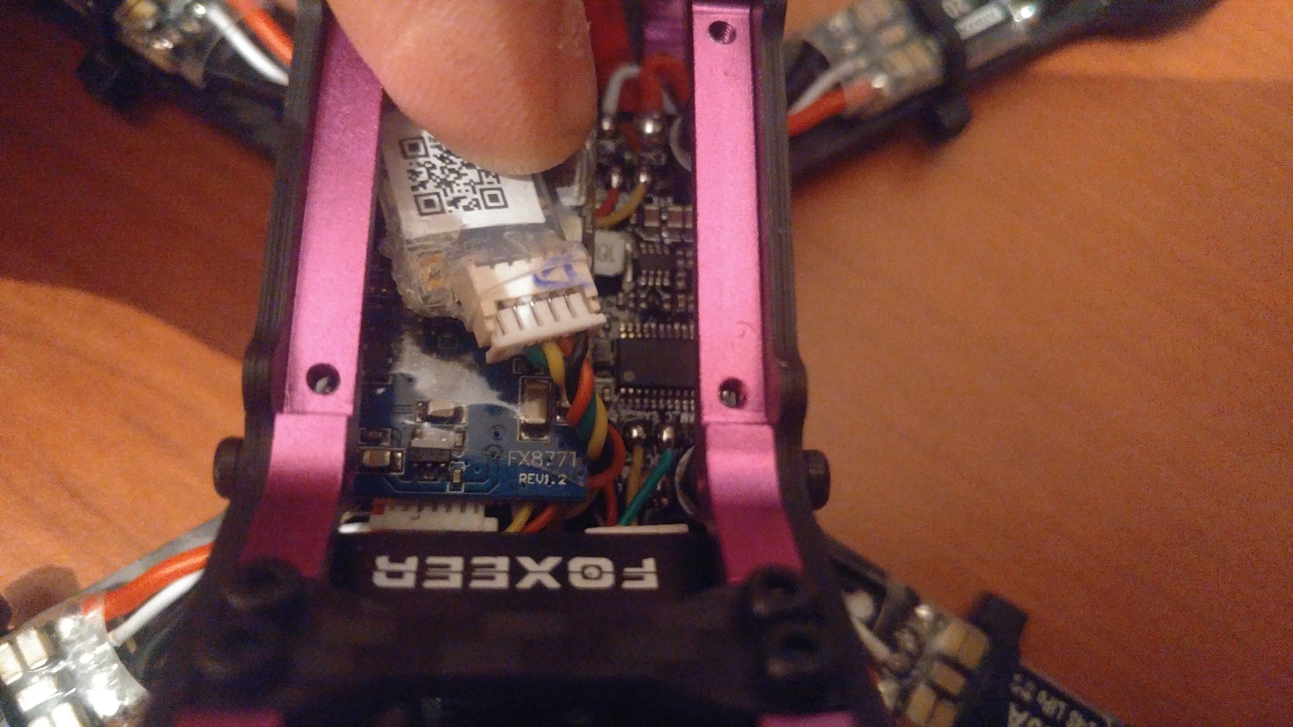

Can you show us a picture of how you connected the r xsr.
Its either connected wrong or you need to select it in BF
Thanks for responding. I didn’t set it up. It came with the reciever installed. Will this picture help at all.

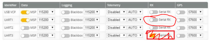

Check these settings… the uart number wont be right.

you may have to try trial and error on the UARTs.

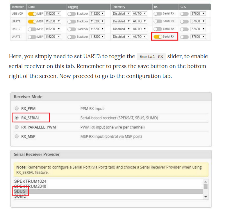

I’ve had dig through the manual try this…
Set Rx Serial on UART1 and then save and reboot

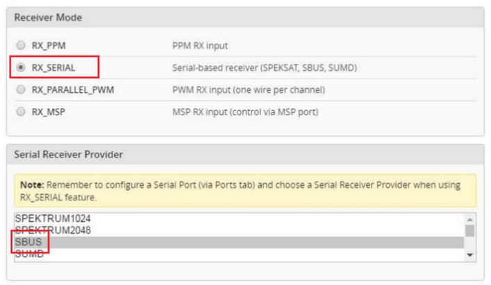

Then configure the RX on the configuration tab as same as the image below and save and reboot.
According to your manual that should do it

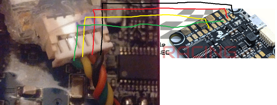

Check you connections as well
I would also try and push that connector in a little more as well if you can…
That was the one thank you so much for helping me get that working. Its all set up and ready to go.
