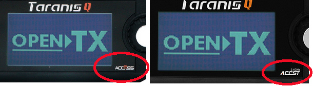

Do you have same protocol version on both? ACCESS or ACCST?
I do not know what that is.
How old is your QX7? Here are 2 different models Taranis Q X7 ACCESS - FrSky - Lets you set the limits or Taranis Q X7 - FrSky - Lets you set the limits , check in the lower right corner of LCD plastic protector what it says there, it’s either ACCESS or ACCST
oh it is the Taranis access

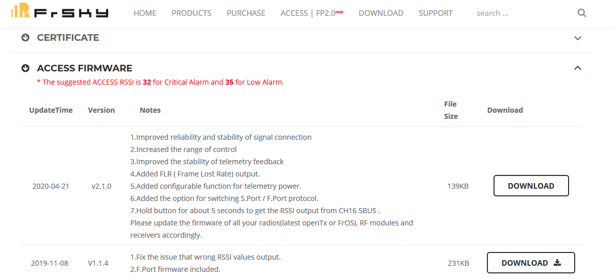

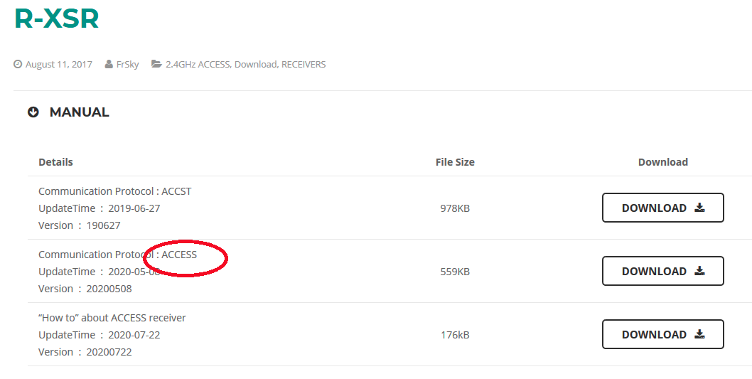

Did you download access firmware for r-xsr ?
is that not the manual download? or the one i have to get?
sorry wrong paste, here is access firmware
Oh yes i did download the latest one and flashed it as well

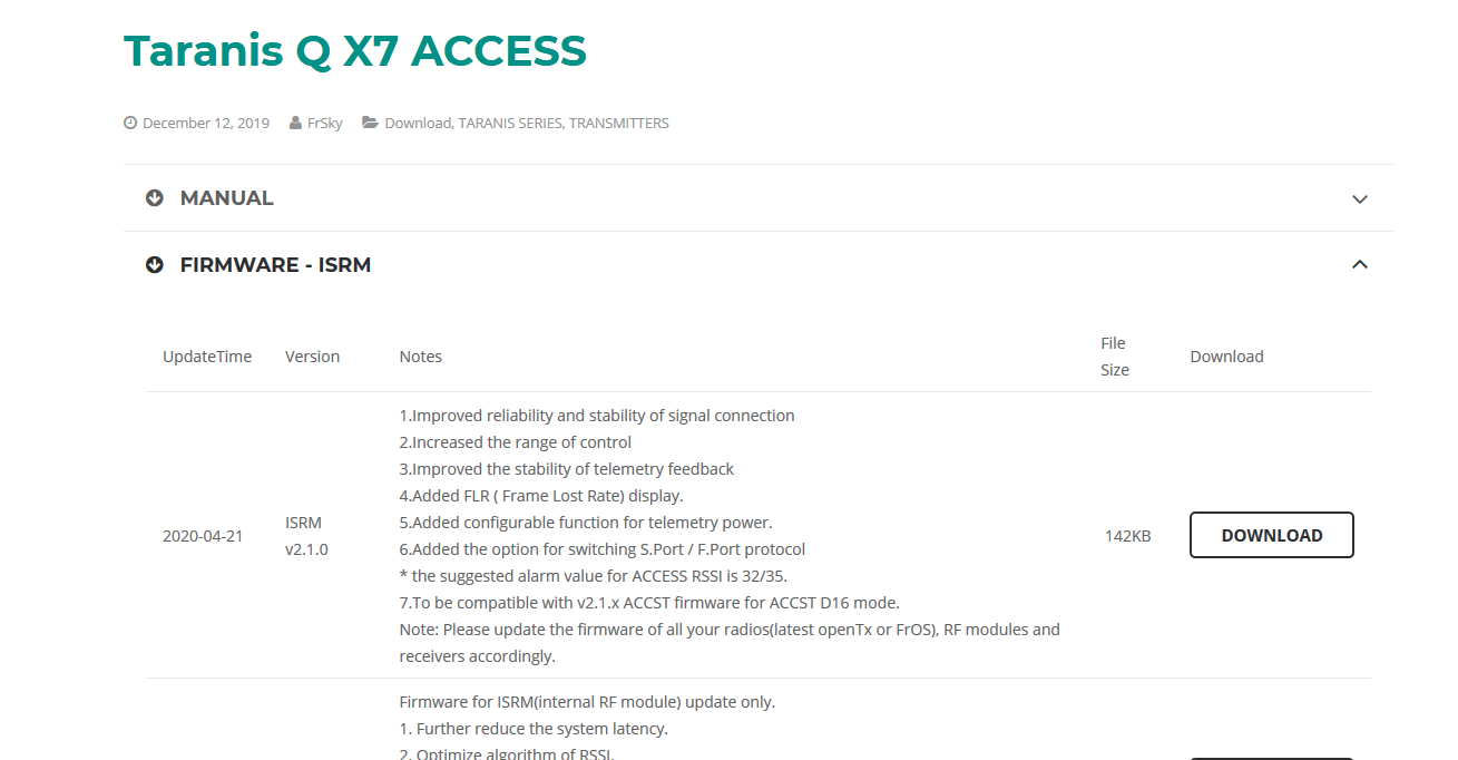

Also you will need to have same version firmware in integrated radio module on qx7
Yes i also did that as well.
