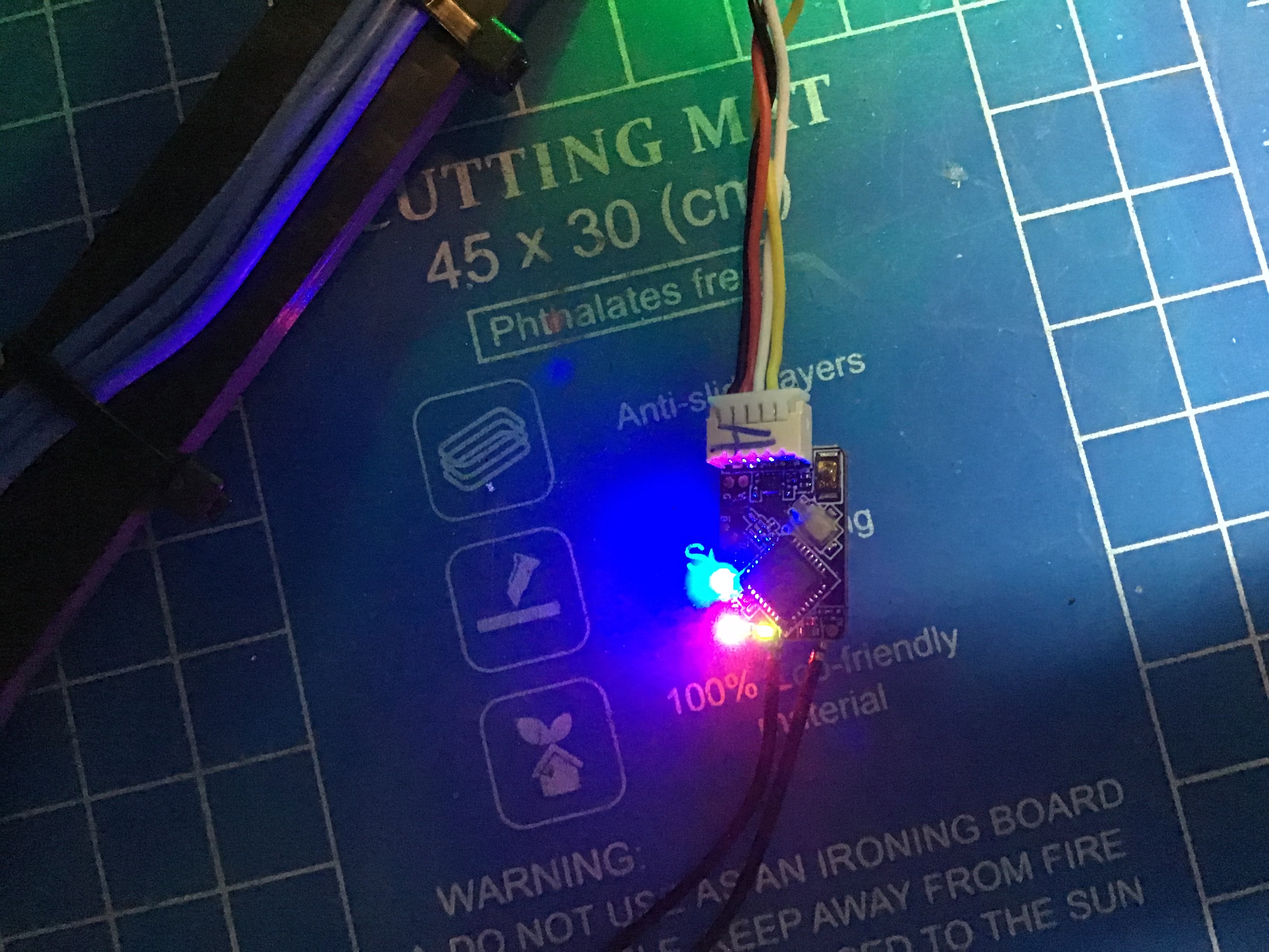

I’m finishing my first FPV build and I’m stuck in a very frustrating issue :frowning: I have the Mamba F722 Mk2 and the RadioMaster TX16S. I have bought the Fr-sky R-XSR receiver and the TX at my local store (North America) hoping I would get this drone up in the Air before snowfall… Now my issue is that my receiver when I try to bind it will literally be solid GREEN, RED and BLUE and no successful bind. If someone can help me solve this issue I would really appreciate it!

Dont have TX16 but most likely firmware issue, check this out will save a lot of questions back and forth.
Thank you for the suggestion, I have updated the firmware on both the TX and RX and I still no luck :frowning:
Thank you so much for sending me that reddit link! they had the solution there (Fr-skyX2 - instead of Fr-sky in the Tx) Thank you so much! NOW I CAN FLY MY BUILD!!
