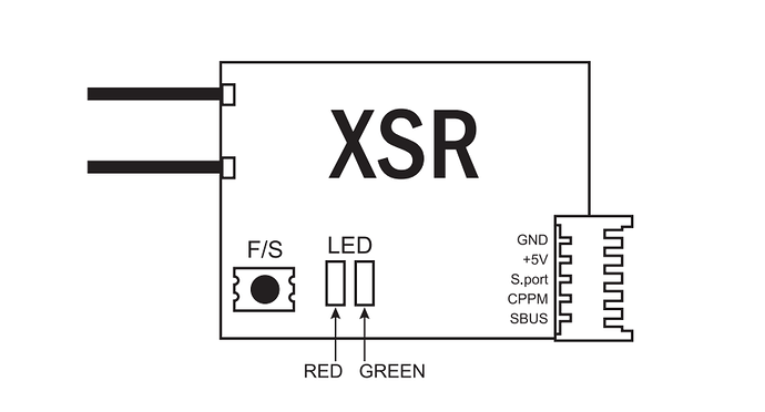

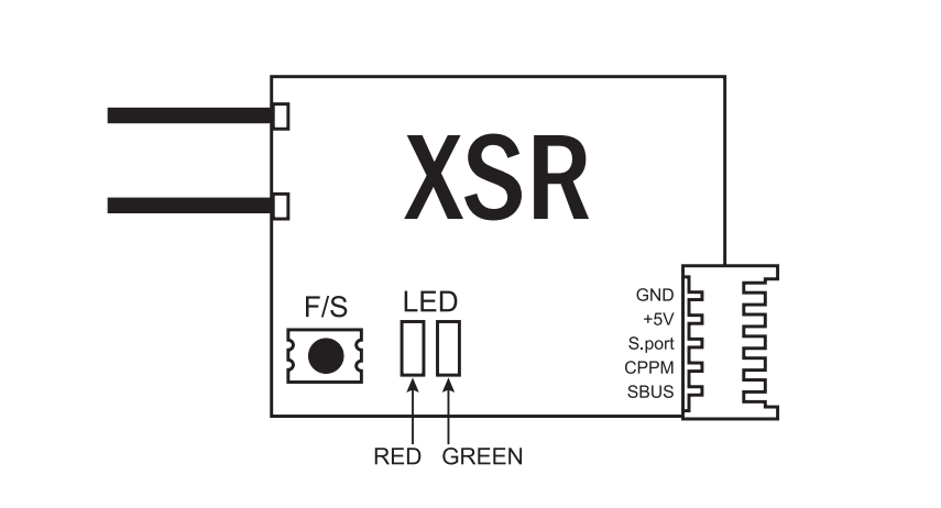

Thanks for the link. Do I connect it to the ppm or sbus? :confused:
You need to connect the Smart port (S.port) pin to your radio, so in the case of the XSR it’s the middle pin
