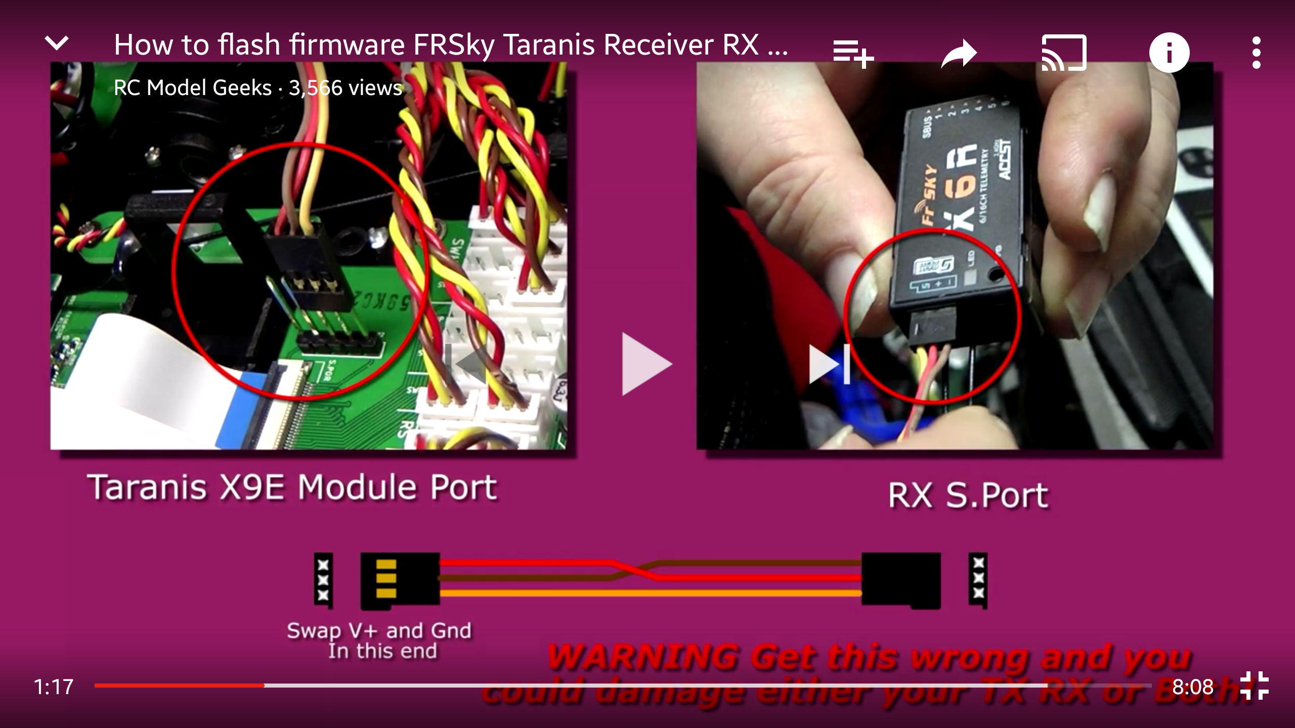

by making a lead to plug from taranis to x8r and plugging it into the back of your taranis
Lead setup and how to plug into taranis pins see attached image for wire pic
Taranis side X8r side
Pin1 > unused < pin closest to arial
Pin2 > unused
Positive > negative
Negative > positive
Signal > signal < pin closest to battery
There is a video on YouTube showing you how to build the lead and how to do it also copy of the x8r firmware
