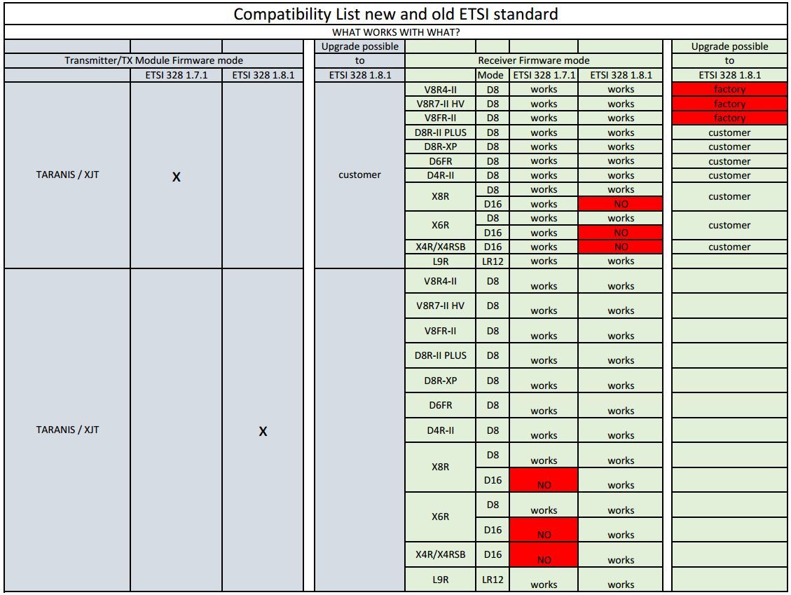

FrSky EU Firmware
Recently FRsky has introduced a new EU versrion of the firmware to comply with regulations ( ETSI EN 300 328 certification). Overall this firwamre is exactly the same as other firmware, just that the TX module had an added setting to listen before talk to comply with the regulations. You will need to update both your X9D Radio firmware and the receiver firmware to the EU version in order for them to talk together. However if you prefer to use the regular version of the firmware by manualy changing the firmware as discussed below.
All of our FrSky products now ship with the EU version firmware.

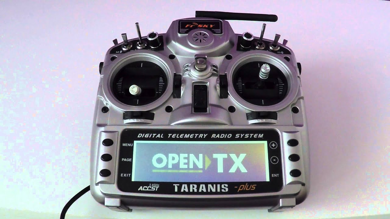

First remove the SD card from the battery compartment of the Taranis. If you have a micro SD reader, use this to read it via the computer. If not, you can select the USB mass storage option once the Taranis is powered on for mass storage and use the USB cable instead. To enter this bootloader mode, with the taranis turned off, while holding both trim buttons inwards, turn on the taranis, more details in step 4.
Download the firmware from the FrSky website and put the file (either mode 1 or mode 2 depending on what you’re using) into the ‘FIRMWARES’ folder
Please make sure the firmware filename is less than 8 characters long, otherwise the taranis can’t read the file, so you will probably have to rename it
Now put the micro SD card back into the slot in the battery compartment.
Turn on the transmitter in the ‘Bootloader’ mode i.e. push T4 to the right, push T1 to the left and switch on the power button, all at the same time. (You can now connect the USB cable if you do not have a SD card reader.)
- Then select ‘Write Firmware’, select the .bin firmware file you would like to upgrade to and then press and hold the enter (ENT button).
- Once complete, turn off your transmitter. You should now have upgraded your Taranis.

If you have any issues just let me know. Otherwise at the end of the day either firmware is fine, its just important that you either have EU firmware on both your Taranis and receiver, or non EU firmware on both Taranis and Receiver.
