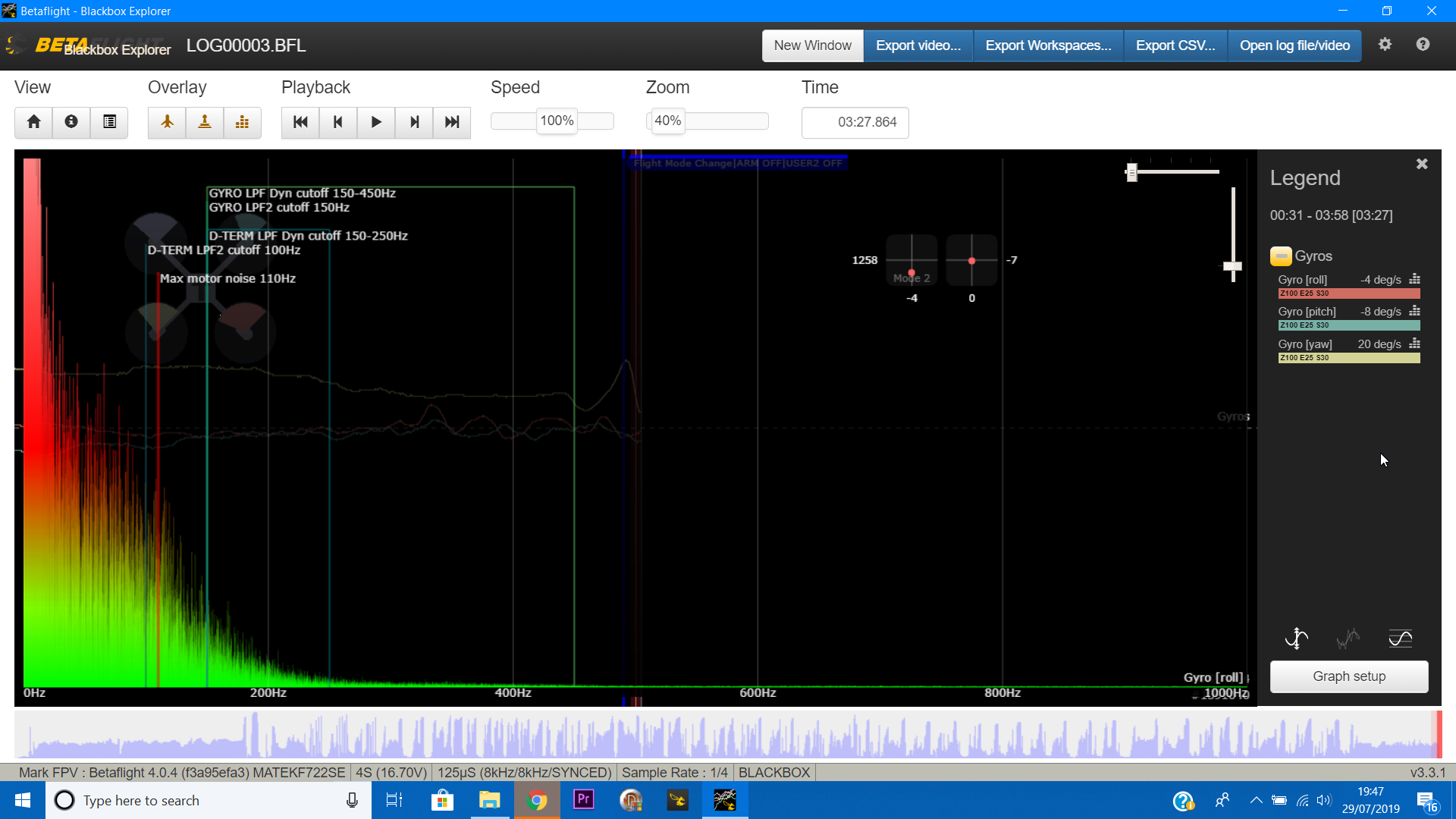

Hello, guys recently I have started to learn how to tune PIDs and read/analyze BlackBox logs simply because I wanted to squeeze a more performance of my Quad. I have a general knowledge of how PIDs work and how they translate when values are not optimal. I decided to look at a couple of BlackBox logs and I found that sometimes chaotic and random spikes occur with and without RC command on the gyro roll trace(debug and pre gyro). At first, I thought it was prop wash oscillation but later I found Joshua Bardwell’s vid on prop wash oscillation. In the video he stated oscillation have some sort of sinusoidal form, therefore, my first suspicion is incorrect to give you guys a better picture I will include screenshots of a specific log/trace.
A spike on all three axis at the same time, could be a sign of a bad gyro.

It looks like your twitch is on roll and on a throttle up, you also seem to have noise on your roll axis.
It could be D gain getting a little bit over active on Roll.
