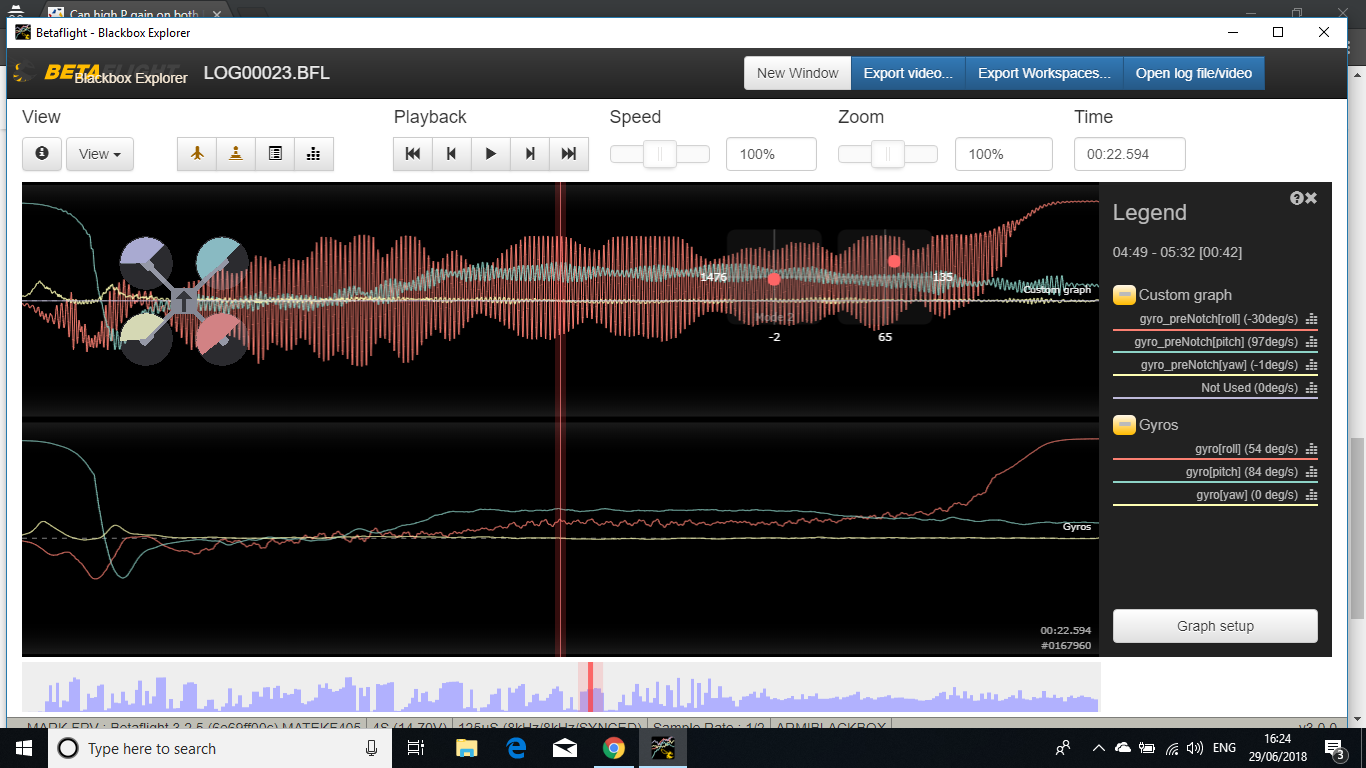

is this bad?
too much noise?
Can you attach that log file…
My blackbox is rusty but that does look like a lot of noise. you maybe able to fix some of it with filters.
Attach your log file and if I get time I’ll have a look.
no promises I can help. last time i did a full tune it took over a week until I was happy.
The first picture that I sent you contained a before and after a filterLOG00023.zip (1.4 MB)
