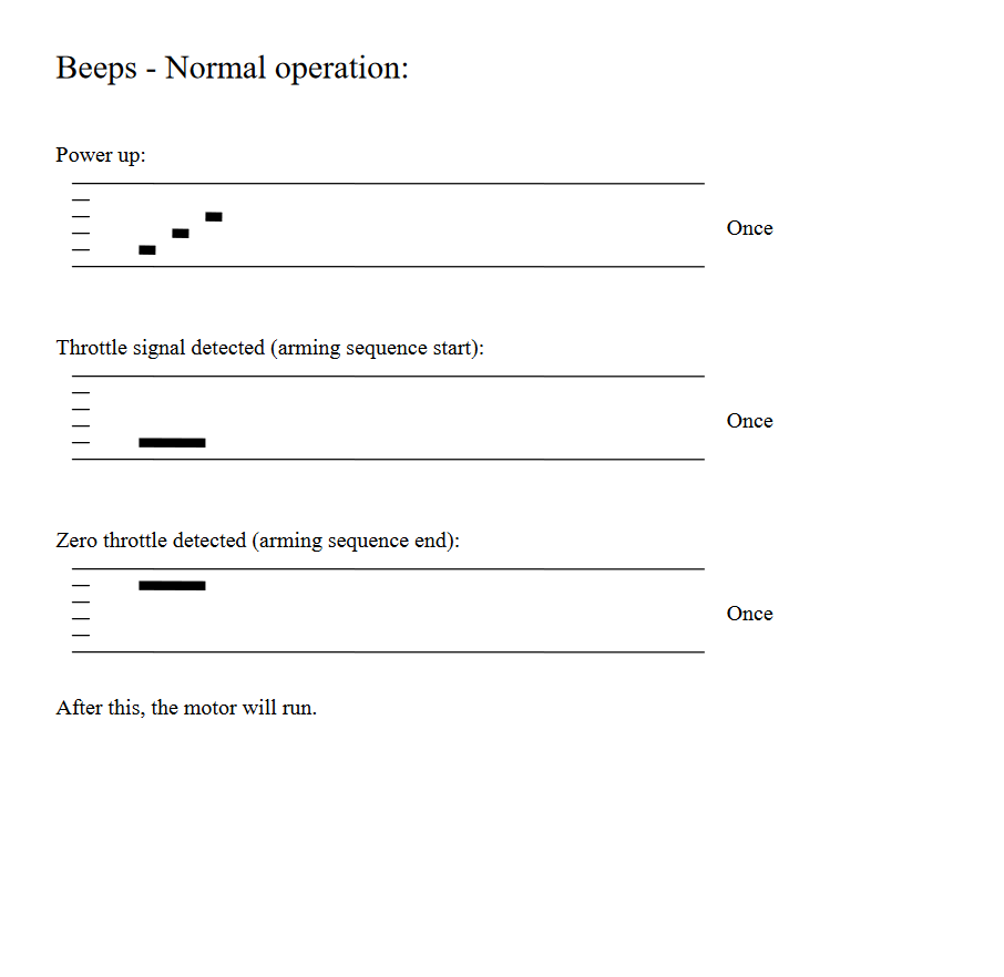

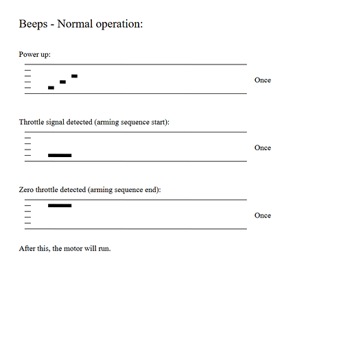

Maybe this Diagramm will help you ![]()
Here is the Link, where you can look at “other Beeps” : http://www.blheli32.com/wp-content/uploads/2017/05/BLHeli_32-manual-ARM-Rev32.x.pdf
Luca
The last two tones are missing; just tried to connect to beta flight and it says failed to open serial port and no leds light up on the flight controller.
The FC was working fine, ESC blew due to a busted bearing in one of the motors. Quad has been out of action for a month or so and as far as I know there’s no reason for the board to be fried but I’m starting to think it is. Someone on another forum mentioned it may be down to different software on my replacement ESC but surely I would still be able to connect to the FC?
