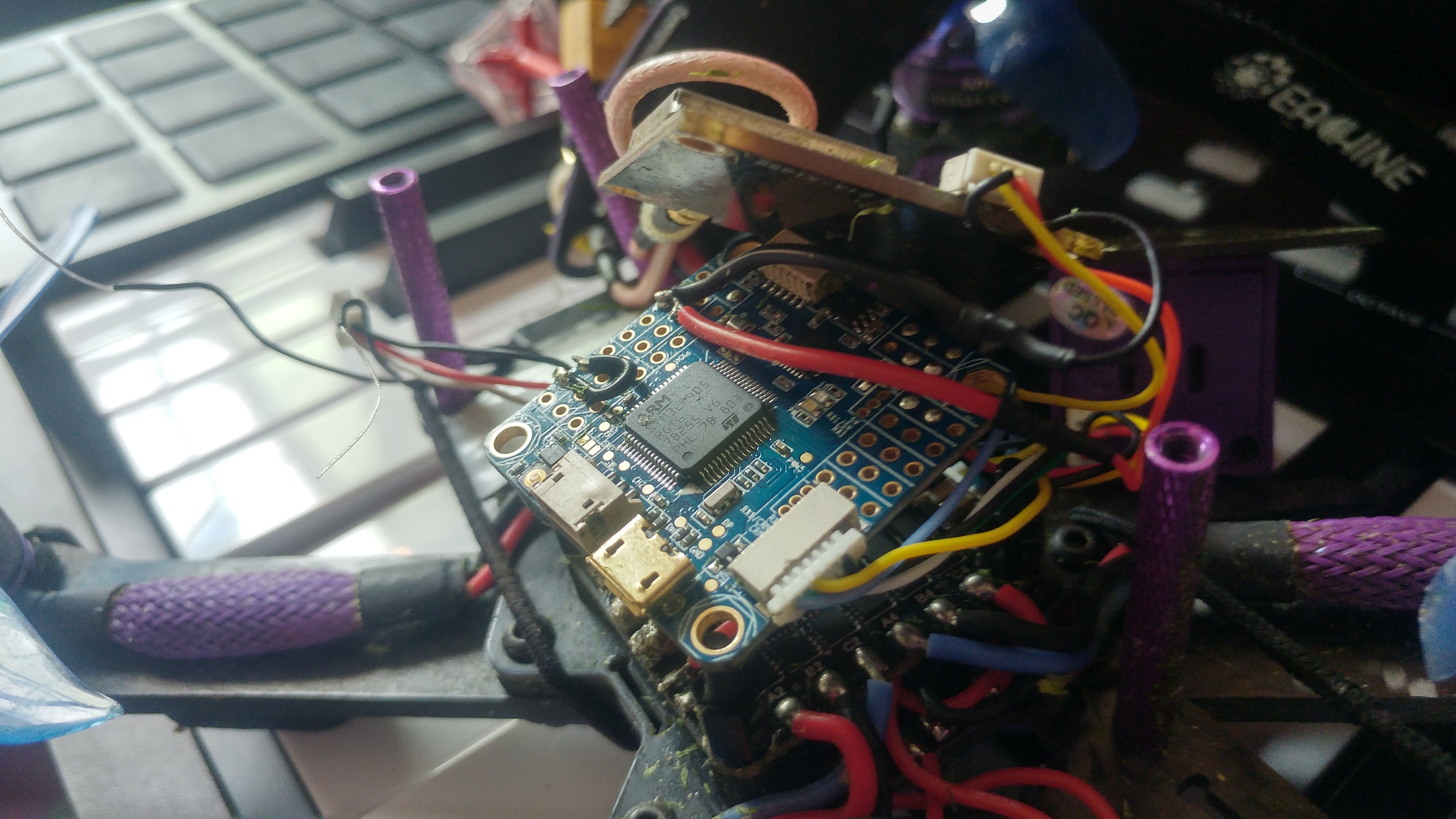

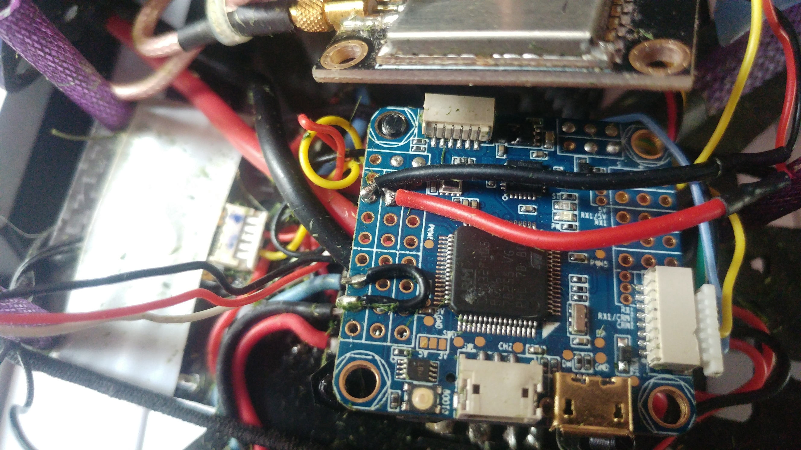

Hi im missing the last two beeps when i plug in the lipo and the receiver leds dont light up. But when im in betaflight the reciever leds come on as nornal and i get the full( blah blah blah beeep beeep). All the stick inputs show up in the receiver tab. Im not sure what is wrong with it
I have a eachine wizard x220s with a fysky r xsr receiver and taranis qx7. Please help
Also no lights on the fc when not plugged in by usb
Sounds like the 5v BEC that converts the lipo voltage into 5v for the FC isn’t working

It could be a fault FC or a fault with power to your FC from the lipo.

I think what you need to do is.
Remove props
Remove the top plate
Plug in a lipo
Test for 5v on the board.
I cant remember if thats 5v or lipo voltage
Be careful not the touch the pins together with the probes

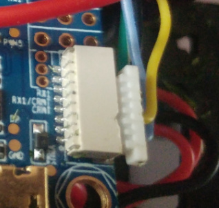

Can you get me a better picture of this
