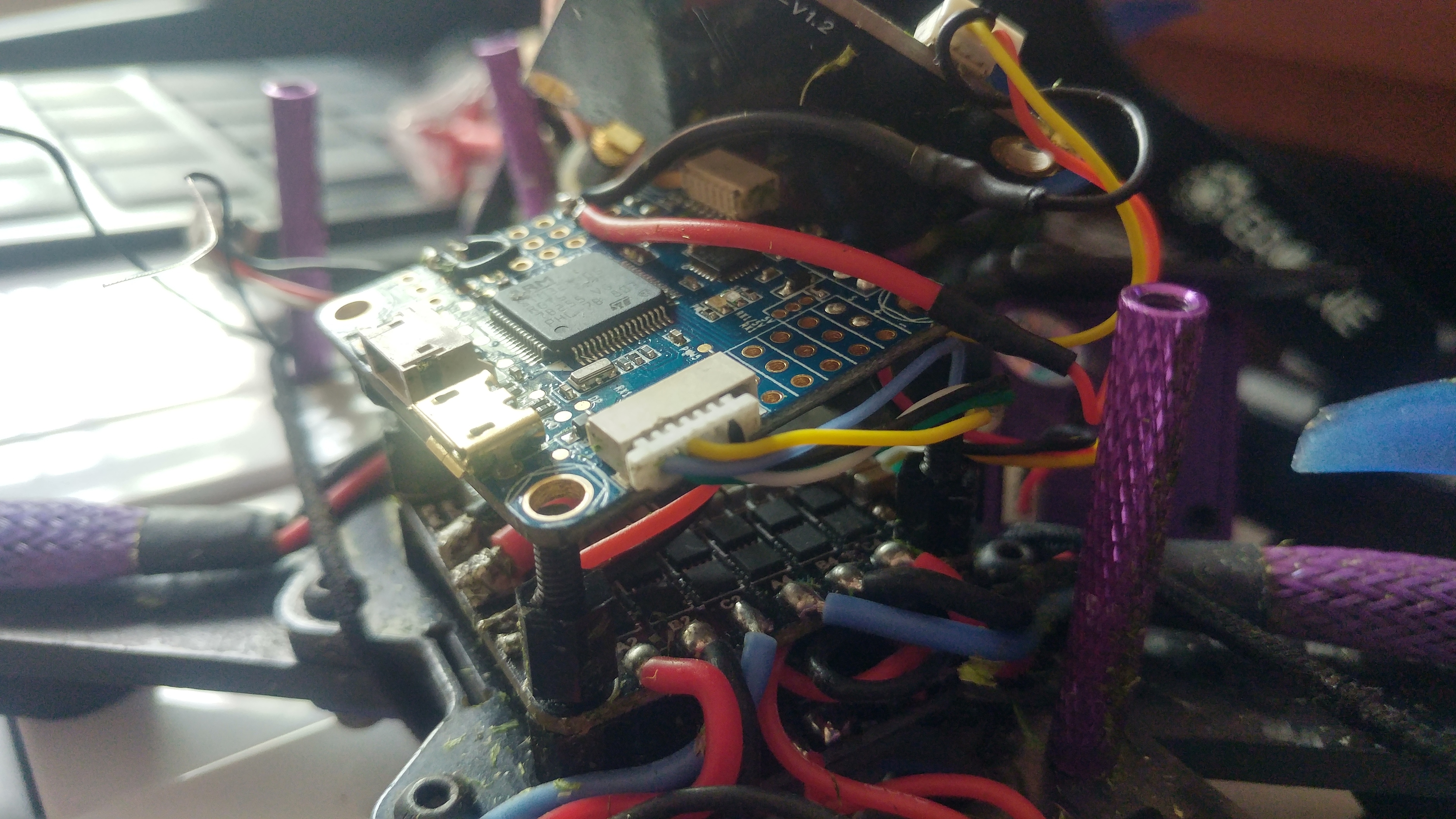

Im missing rhe last two beeps when not in betaflight
Sorry that wasnt the best picture. Ill try again

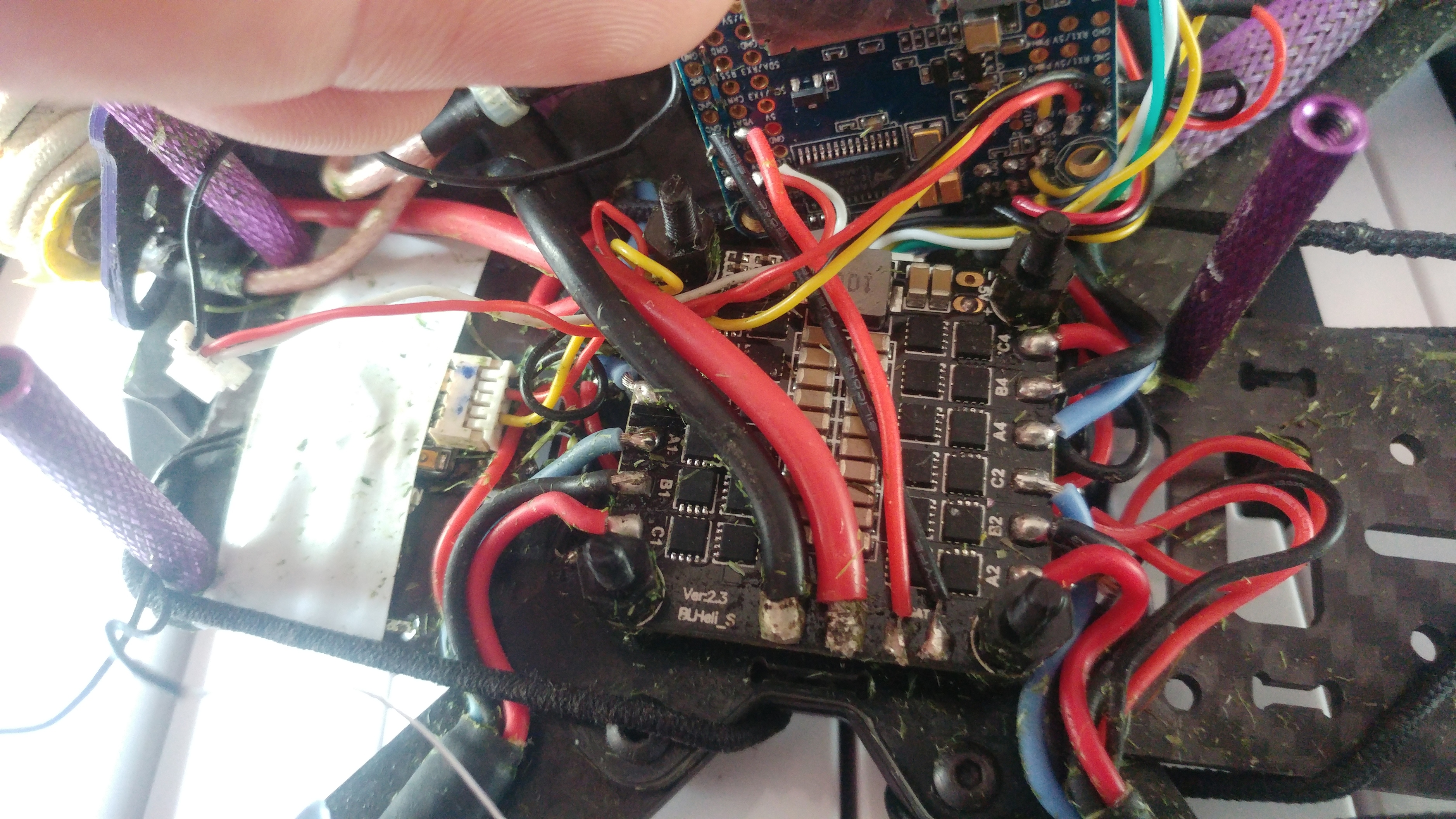

Not sure thats any better.
That cable also plugs into the ESC can send a picture of that.
All picture help… your doing good.

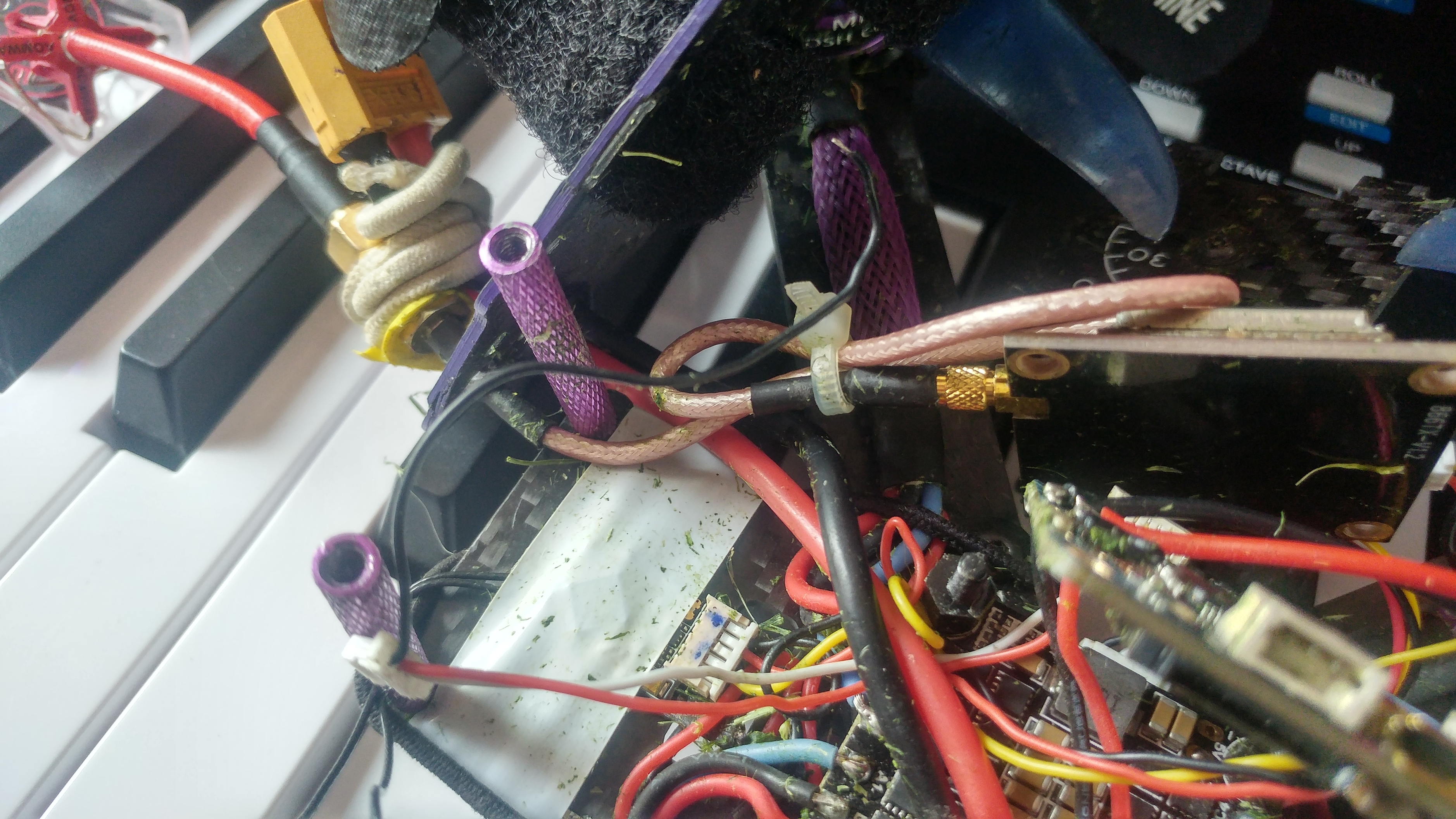

I just noticed the black cable that would normally go to the back led has come lose. Im not sure if that has happened whilst taking it apart ir not

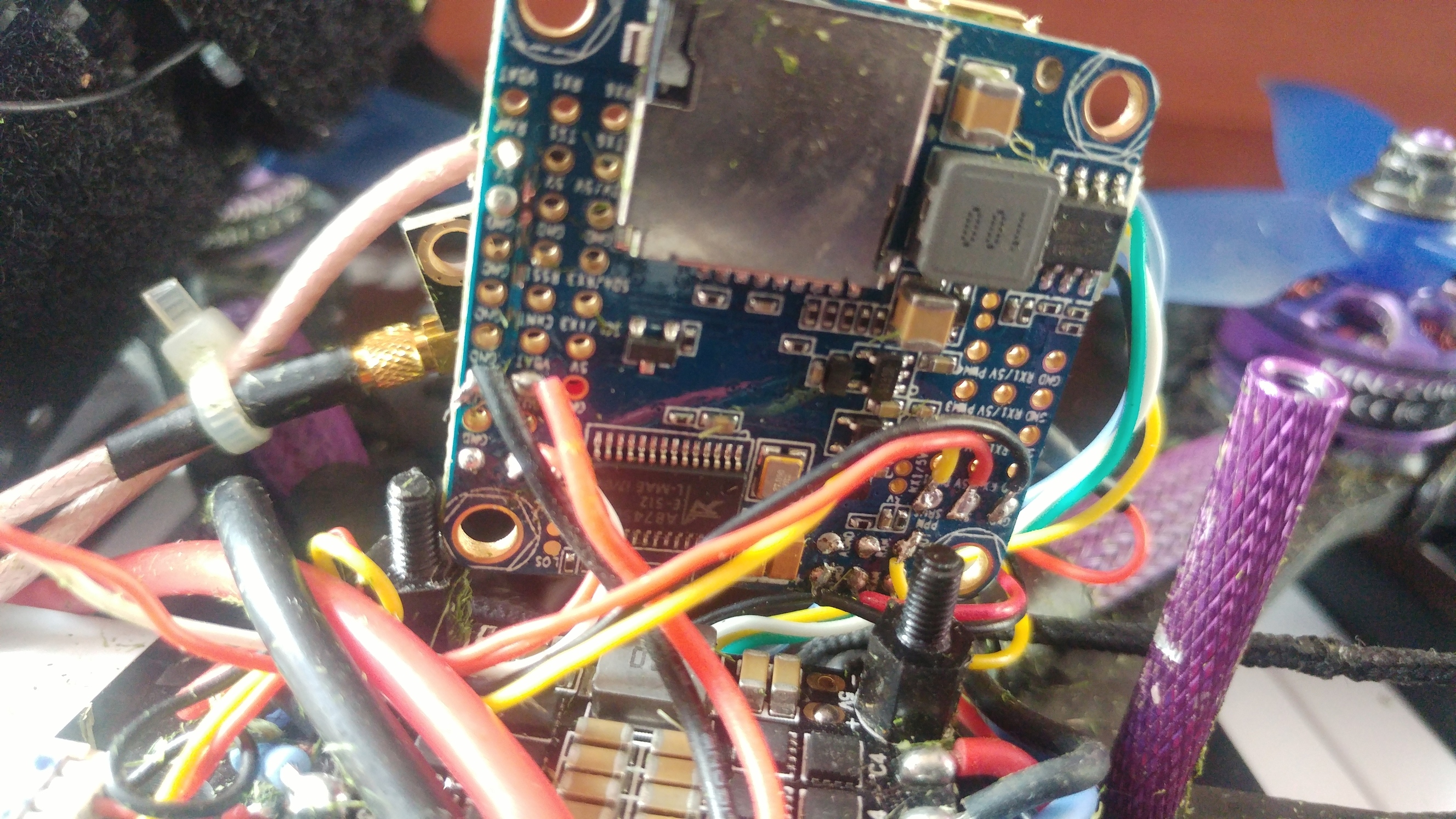

I just placed it onto the board and plufged in the lipi but no change
could you show me the cable
The black one coming from the little white plug
that won’t stop your FC from powering on.
I think something has died.
guessing the power between the ESC and the FC
