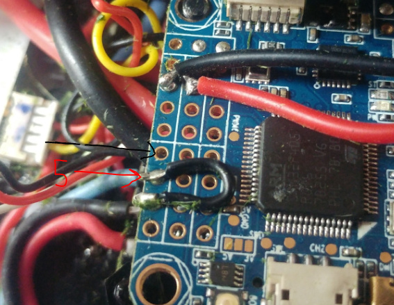

Sorry that first picture wasn’t very easy to work out here on the board

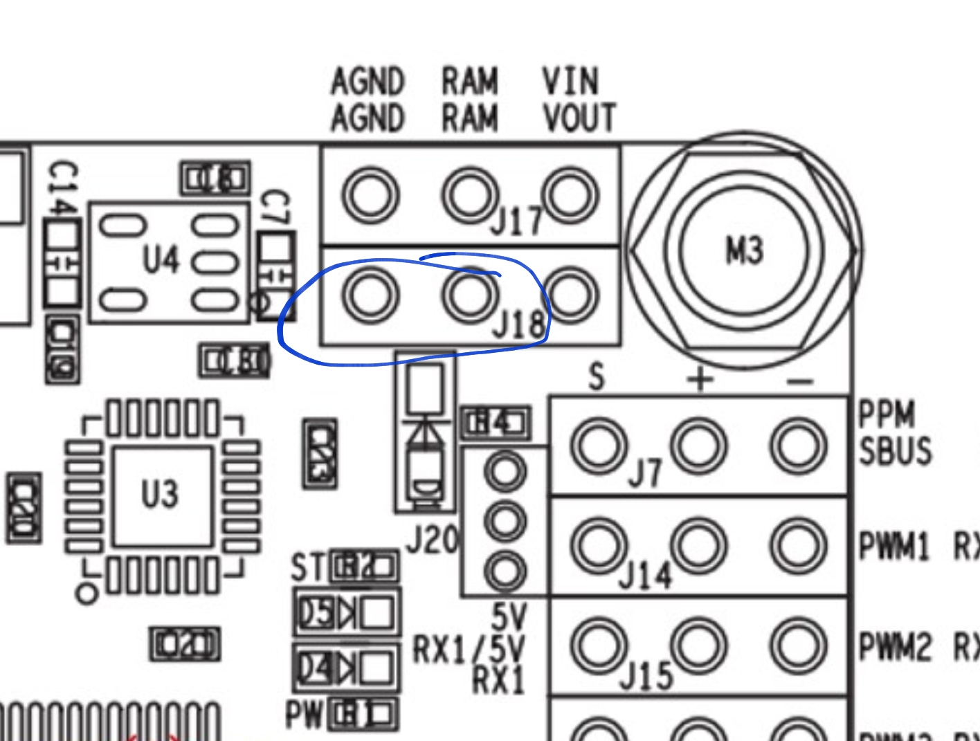

Im getting nothing on the 5v

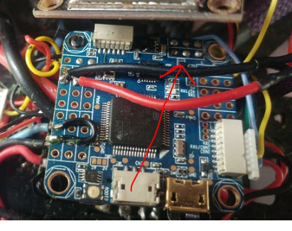

What about here?
Still nothing is showing on the meter
I think the 5v regulator on the FC is toast then.
It all works from USB cause its 5volts and doesn’t go through a regulator.

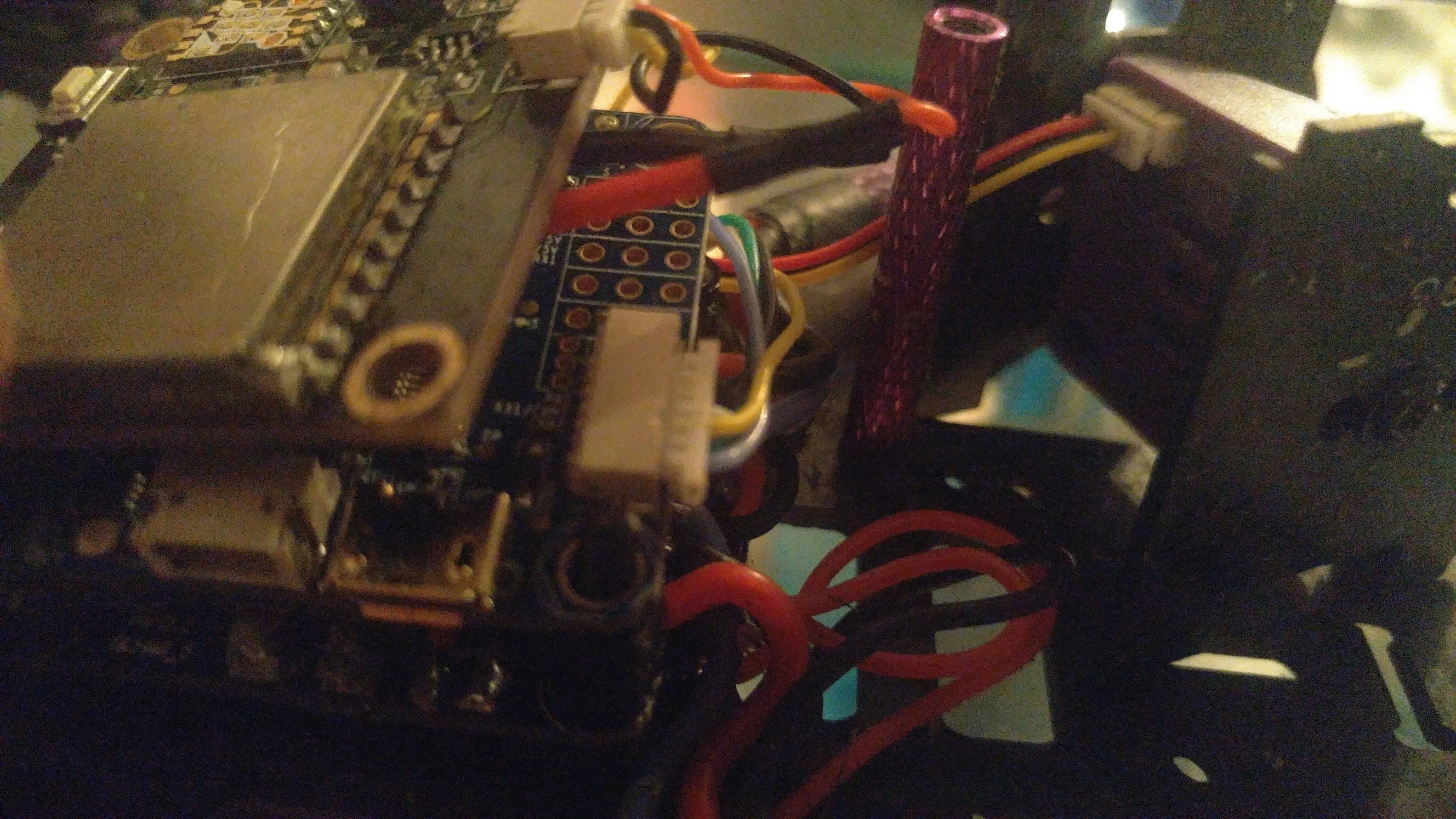

When i was flying i could hear dogs and landed abruptly but nothing that heavy. The cable in the photo with the blue and yellow came lose i pushed it back in and it was fine. i tried adjusting the pids it after watching a tutorial for smoother footage as i was getting jello in the gopro but i realized then i was only getting 3 beeps but didnt think to much of it and i took it out and wouldn’t start. I thought it was something i had done in betaflight. So i put it back to the settings profile i had saved but it still wouldnt do the full start up without being in the usb. Hope that makes some sense
Could it be that cable that’s the problem. One of the wires is loose maybe ?.
Thanks for that, I suspect that maybe when you plugged it back in, either one of the pins could of gotten bent, or something shorted, or it was not lined up correctly, as that could definitely explain the issue?
