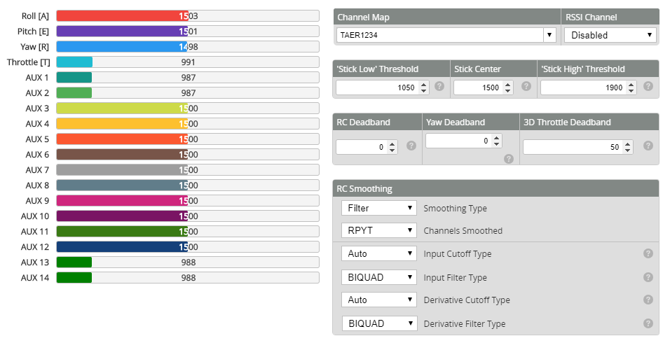

also make sure your throttle moves from 1000 to 2000 in the receiver tab and min
your ‘stick low’ threshold should be higher than the low throttle… so
My channel goes from 1000 - 2000
My ‘stick low’ threshold is 1010
Give that a go and let us know how you get on…

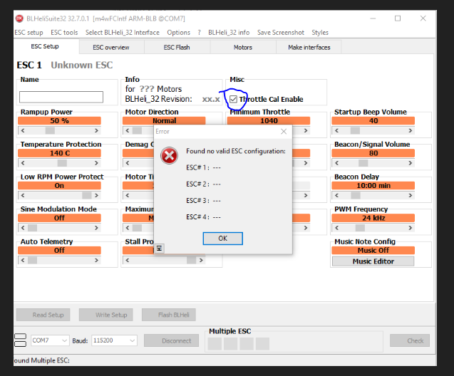

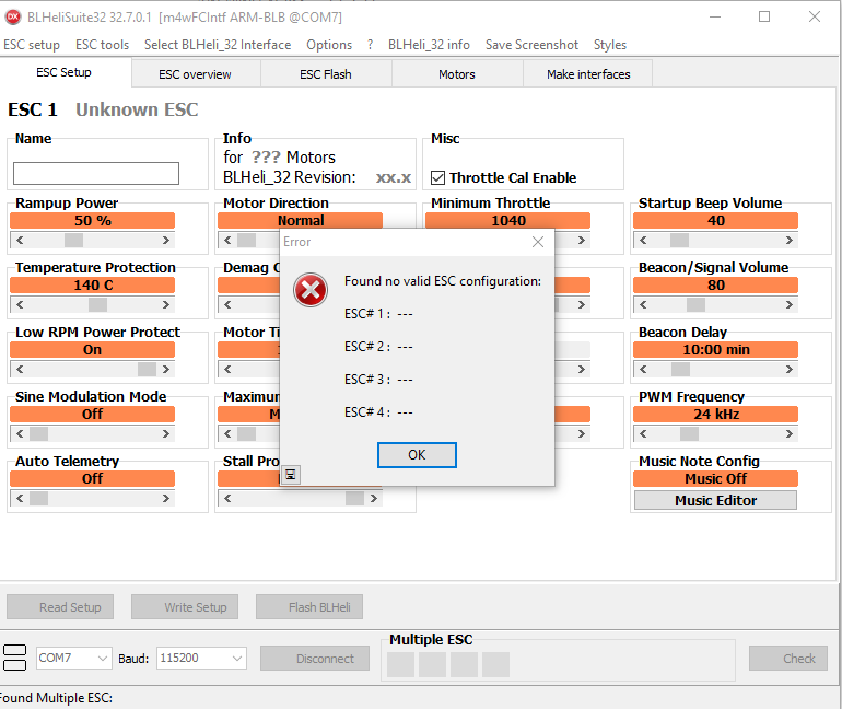

I have been using BLHeliSuite32, here is the message I get when trying to ‘Read Setup’ or ‘Check’ inside BLHeliSuite32:
Where is ‘Program of Tx’ found, and what does it do? I was not able to locate it when I searched around…

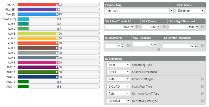

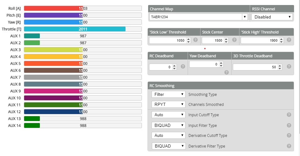

Here are screenshots for throttle low and throttle high:
Low (throttle is in this position upon startup):
High:

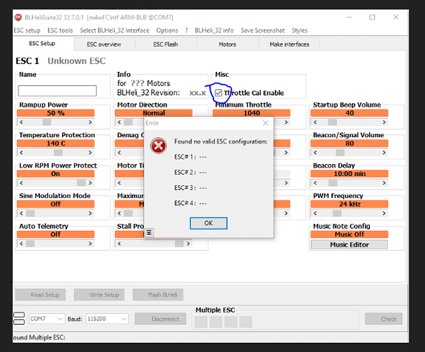

Sorry I was wrong… untick Throttle Cal Enable
I tried this, but it doesn’t seem to make a difference. When I click ‘check’ or ‘read setup’ the checkbox gets re-ticked again.
