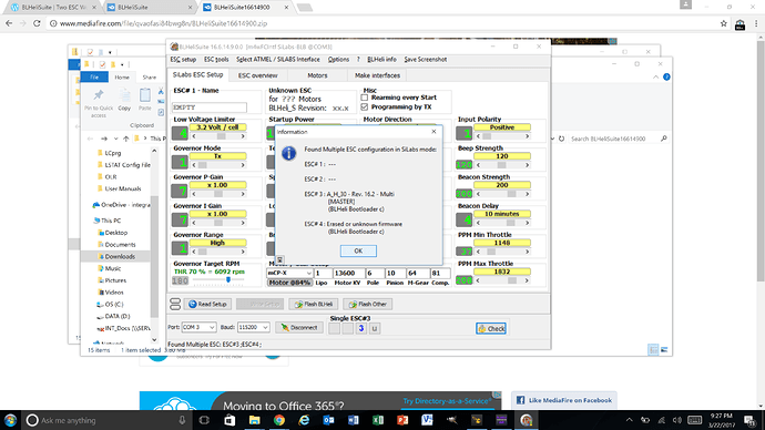

I am using a diatone dlink f3 v2 flight controller with diatone oneshot 42 heli S Max 60A ESCs. My motors respond in betaflight when I use the slider. When I try connecting to BLheli suite only esc 3 reads. ESC 4 says erased or unknown firmware while esc 1 and esc 2 show three dashes. I also tried connecting using the chrome app blHeli configurator and only esc 3 shows up. My battery is connected and like I said in betaflight the motors spool up with the slider. They also spool up inside the blheli suite in the motor tab using the sliders.

Yes they are AH30. I actually read that there was a change to the newer betaflight firmware. After version 3.0.1 there was a code change that disabled passthrough from the flight controller. I downgraded to version 3.0.1 and now am able to see esc 1 and 2. I ordered two more escs thinking I might have bricked esc 3 and 4. I hope thats the case as pnce I replace the two I will see all 4. If I’’ still having problems I might have to resort to buying 4 new ones like you did.
