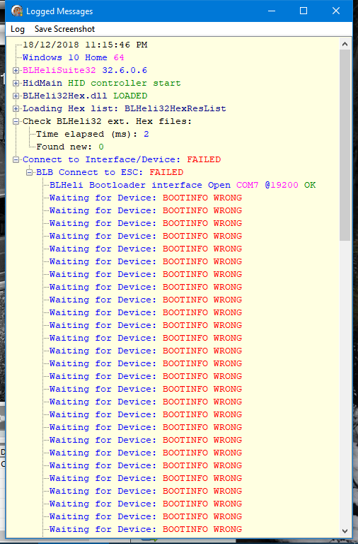

I have a pixhawk with the xsd30 esc;s during setup all goes well until when in BLheli suit I try to connect to the esc’s using the passthrough option and it wont connect, I get a window saying to check power and usb connections.After some research I learnt that there are some some bootloader issues with blheli esc’s so I bought a usb linker to connect directly and still no luck. The log reports “boot info wrong” So where to from here, is there a way to make them work,

From the “boot info wrong” message reported in the log it appears that boot loader is incorrect for whatever reason but I’m only guessing. I have 8 of these so I’d to get them going.
Can you link your linker and send in some connection pictures and screenshots.
Screenshot and pictures can make all the difference
Here is the log sreenshot
your using the wrong version of BLHeli
BLHeli32 is for 32bit ESCs
you need BLHeli 16

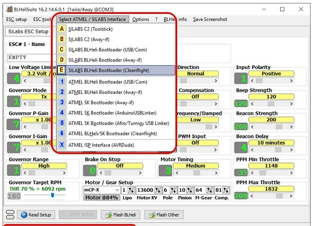

I was hoping that would explain why passthrough doesn’t work with the Pixhawk 4 V2.4.8 as well . Blheli see’s the FCU on com 3 ok and I tried both atmel and silabs interface options but it just times out saying to “check port and power connections”

When flashing all 4 ESC through your FC you need this option.
