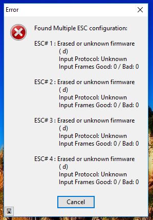

I have just tried to connect to the ESCs with BLHeli but getting the below error messages:
BLheli%20errors

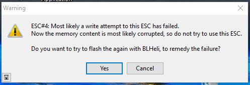

Then it tries to flash the memory in each ESC #1, #2, #3 & #4 see below:
Flash%20Memory%20ESC

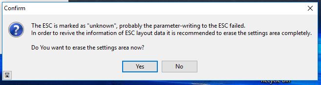

Memory Flash fails so it tries to erase the ESC completely.

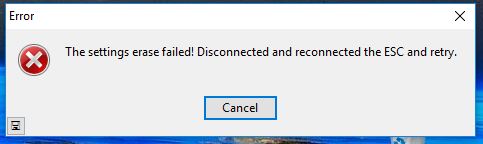

Erase%20Completely%20ESC
But it fails:
Erase%20Failed%20ESC
