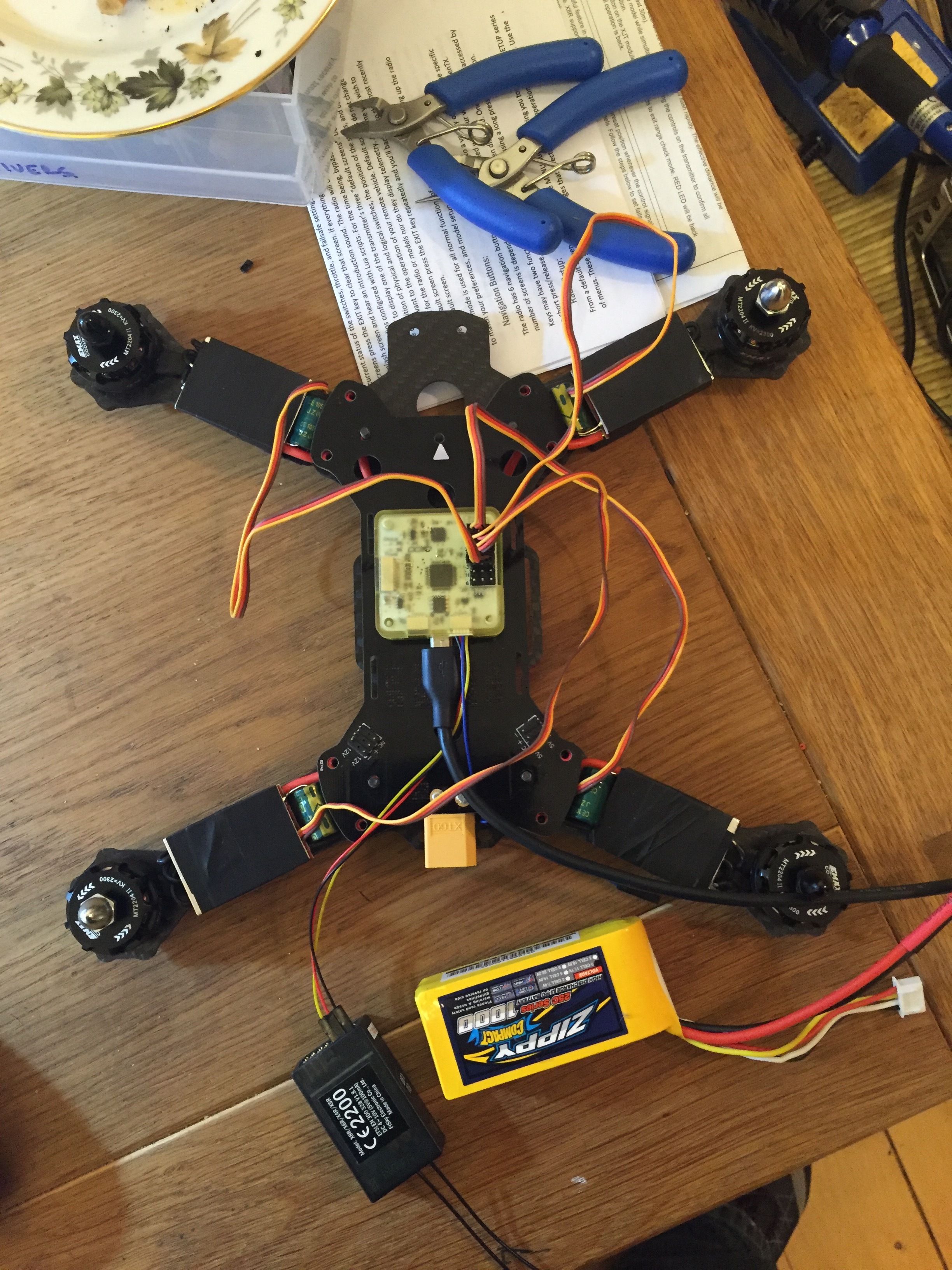

I bought the 20 amp version - removed the various adapters and soldered the engines directly to the ESC’s. (EMAXcooling 2300kv) - the motors etc are running fine - except they all spin the wrong way - I’m using a CC3D flight controller - Flashed with Boris Betaflight and I’m now using Cleanflight - and an X8R / Taranis Receiver/transmitter.
I don’t really want to remove the ESC/Motor units, exchange wires and solder things again - I would rather just reverse the engine directions on BLHeliSuite… Sorry for being so slow off the mark !

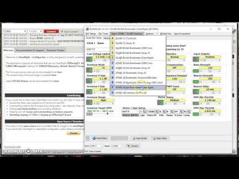

This shows how to do it on blheli suite
http://zmr250build.com/2015/12/20/reversing-motor-directions-bl-heli/
And here’s the video
Hope that helps you not get soldering iorn out lol

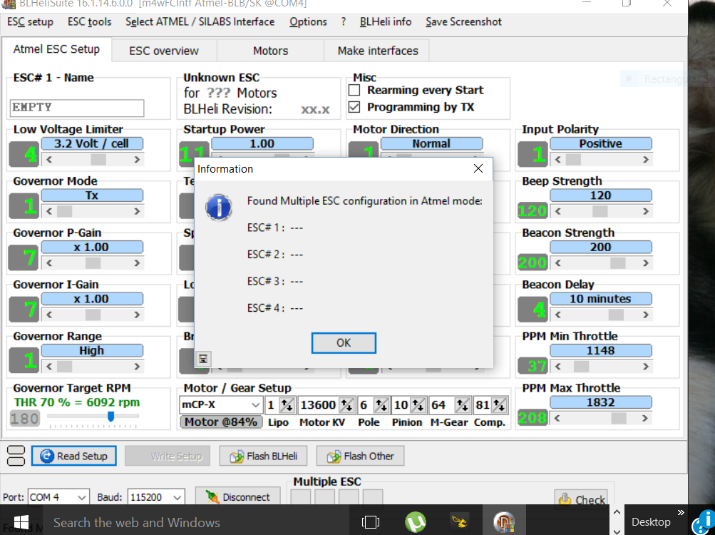

I’ve watched the various Youtube videos and followed all the instructions.
I’m not having much success:
I’m unable to proceed any further - as the ESC’s do not appear to be recognised.

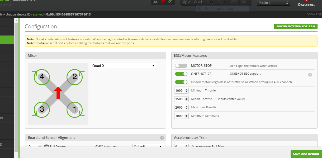

Cleanflight Setup
Do you have any suggestions ?

Is it possible to swap the whole arm and esc from front to back, or side to side without the soldering. in the video the man mentions about having to solder a wire on esc to flash the bootloader that’s maybe why you can’t get esc’s to be seen.
If not I could only suggest the soldering option unless you have bullet connectors on motors
if not I’m sure @unmannedtech1 know how to doit
