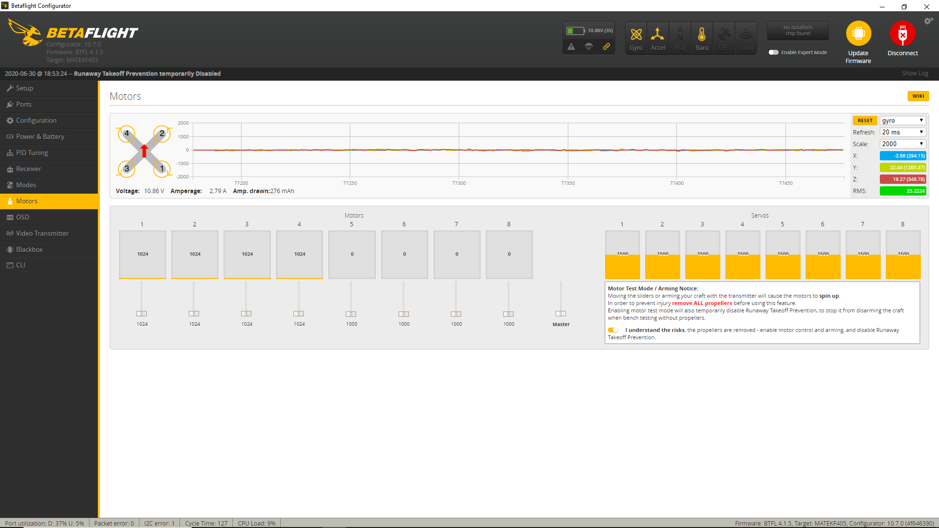

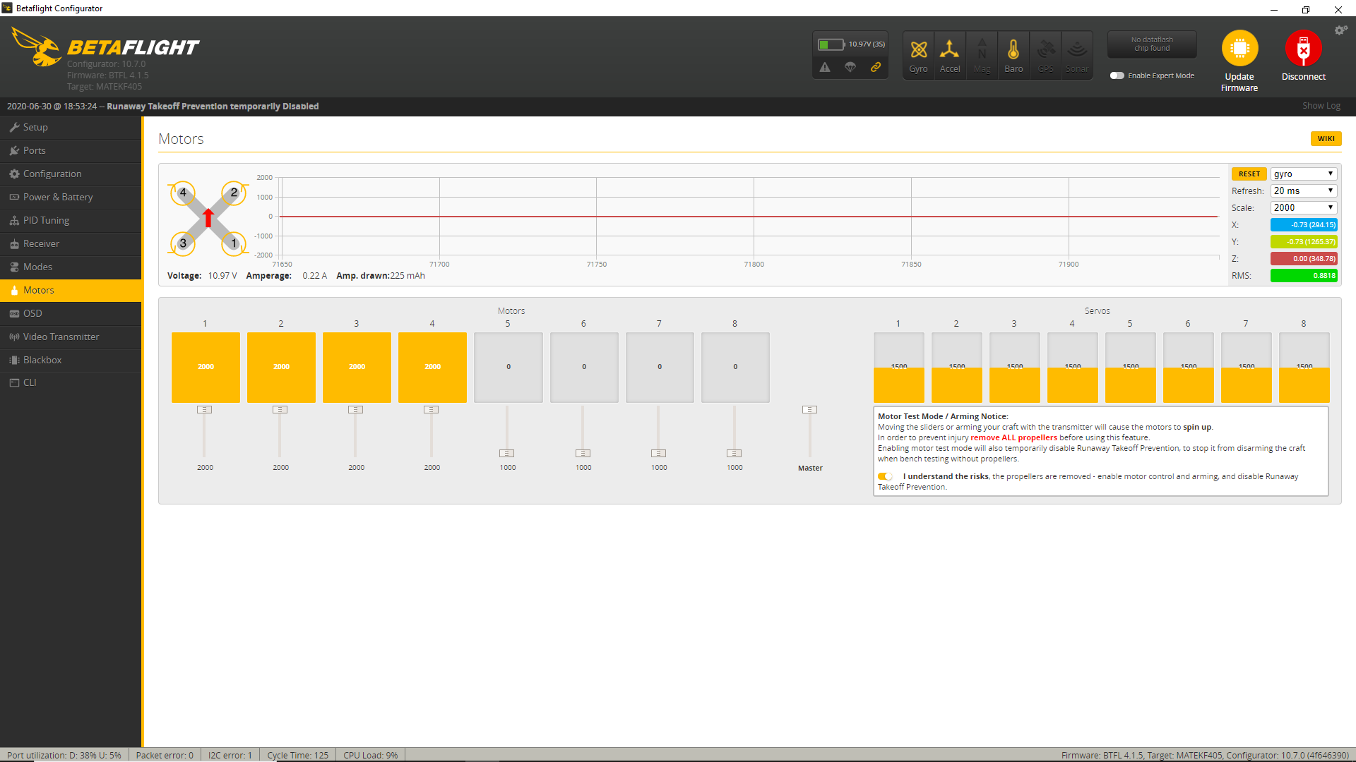

in betaflight at 2000 and at 1000 they start beeping every 1 sek, but when moved in between the beeping stops, and when it is in 1024 or sometimes at 1040 the motors start to rotate but with jerking(see scrennshots below).

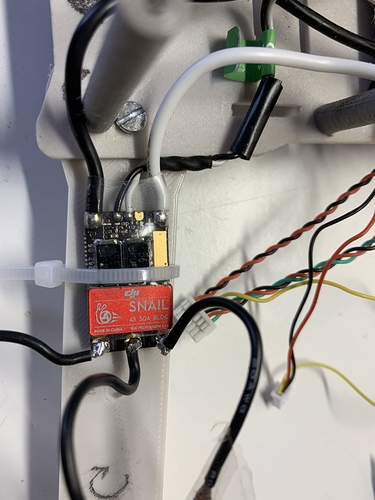

Another annoying problem is that one of the ESCs the 4th motors esc, beeps like the other ones when in position 1000 and 2000, but like the other motors 1,2 and 3, this one doesnt rotate or even jerk it stays quiet,??
I checked by connecting it to motor 3s esc and it seems to be working fine(meaning it jerks likewise), but when connected to it own esc, there is no movement.
Why is this happenening? is the esc broken, did i get a faulty one? but if it is broken then why does it beep every 1 sek when in motor mode 1000 and 2000?

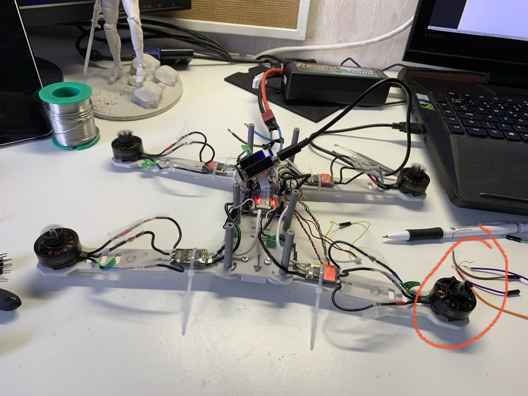

By the way u can also see in one of the pictures how 3 of the 4 motors rotate jerkingly, but not one of them, why i dont know.

See pic bellow to see more pics of my drone and how the soldering point look and specific pic of ESC 4 and how its connencted to the PDB(FCHUB) - power distribution board.
