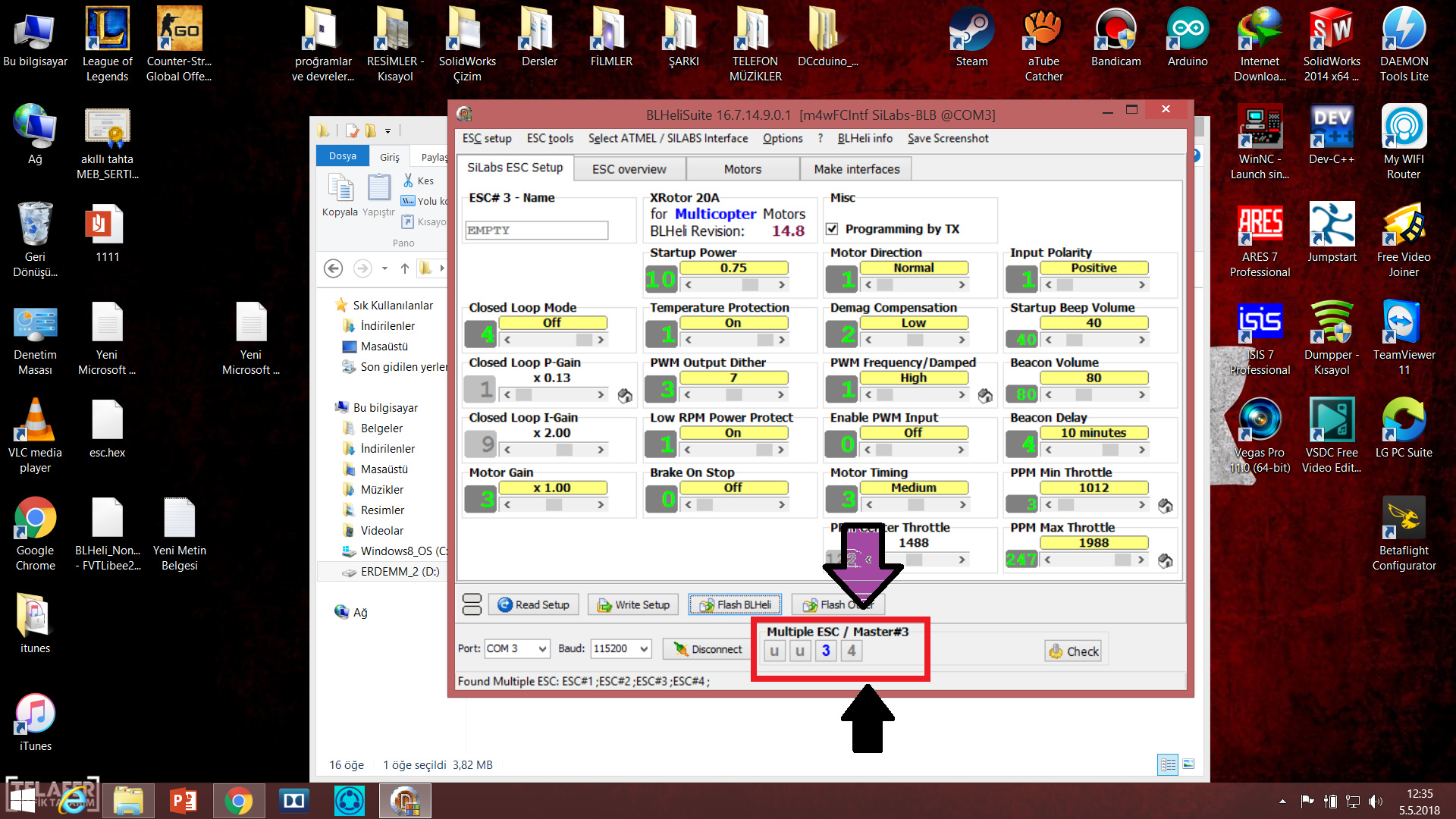

You do that by connecting your Drone to BlHeli suite
I did the calibrating process yesterday. But the third and fourth ESC are calibrating. The first and second ESC are not read.
There are ESC errors. One and the second ESC were not found. No updates. HELP ME
May the signal wire of your Escs be faulty or did the connection came loose?
We found the cause of the fault on the Bf3 card. There is contact at one and two data pins.
