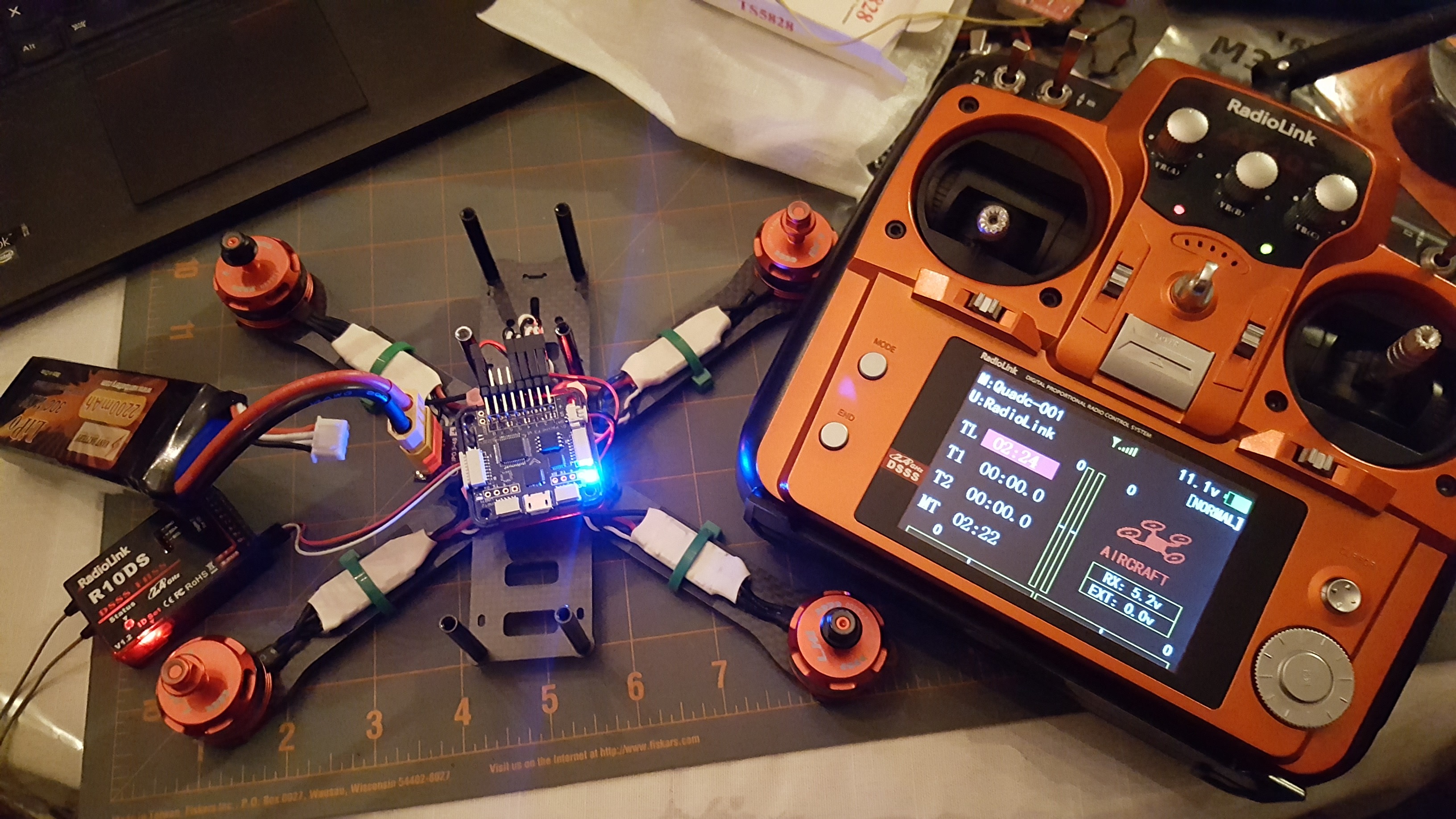

Ok… have most everything together. It was a bit tricky getting the R10DS bound to the AT10…somehow it happened and no indication beeps or flashing led to say so. I only knew for sure through CleanFlight. Weird (to me)… the throttle had to be set reversed on the AT10 in order to function properly. Now, all motors arm and function in their appropriate directions. Next I’ll install the camera and button everything up. This has been quite the education, especially for someone who has only played with “toy” type RC systems…no settings, no options, plug and play type things…
Happy to hear you are making progress. That is weird for the binding with AT10… I know on the AT9 and AT10 II you see a little antenna icon on the screen once it has connected to receiver to show the signal strength, but I have never actually used the AT10 v1 radios before but dont see why this would be any different?
The antenna graphic is there, it just didn't make any noises or flashing or color changes like other binding processes I've seen...not that I've experienced a lot.... we use some RC at work occasionally, but, for puppetry and animatronics...
So looking forward to the coming weekend … should be able to get airborne and finesse the settings… thanks so much for your input, it really does help.
