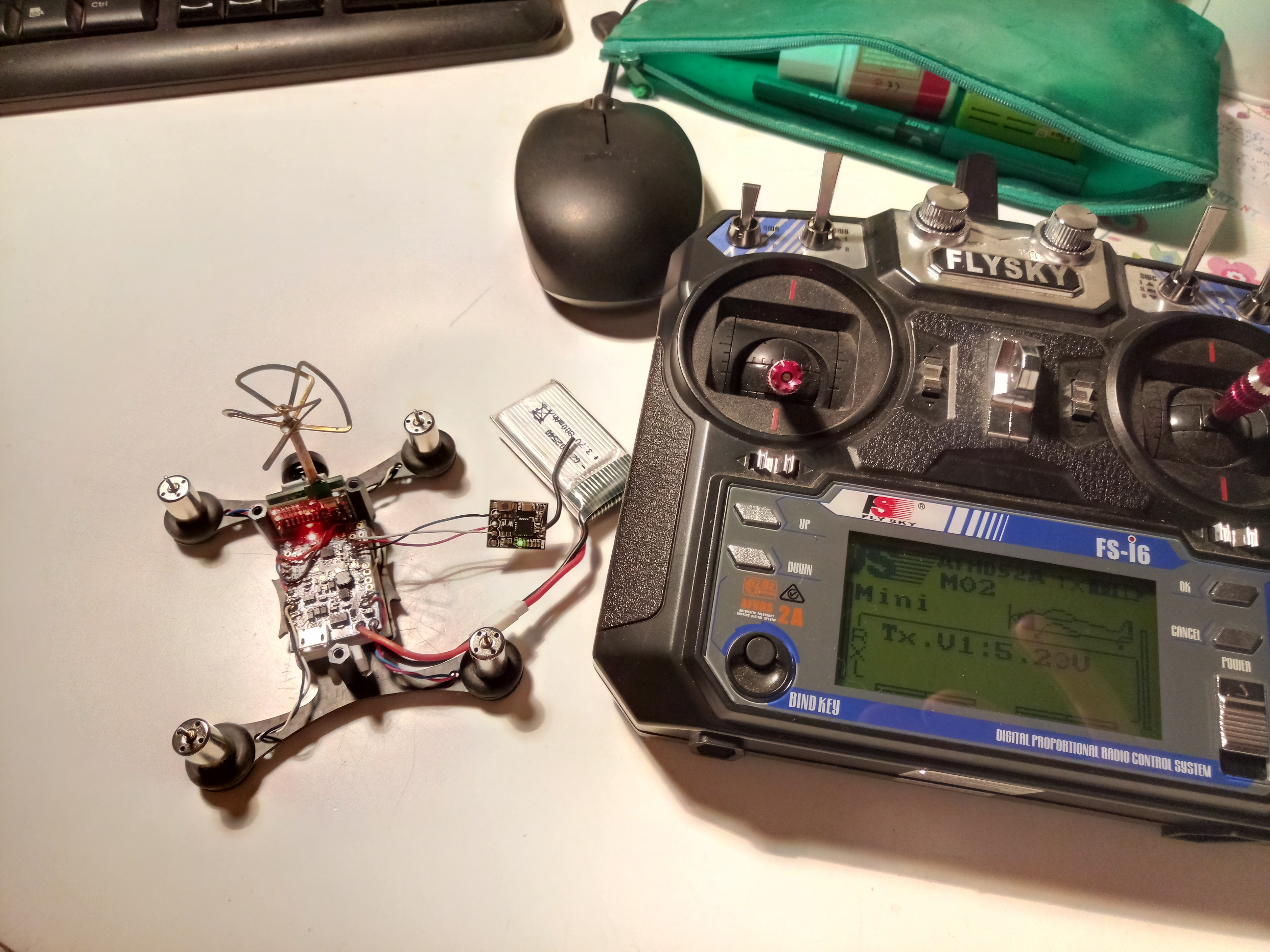

Hi i need. help - sp facing f3 evo brush
how i wier fs rx2a pro receiver to sp facing f3 evo brush, ibus,ppm?
and how i binding it to fsi6

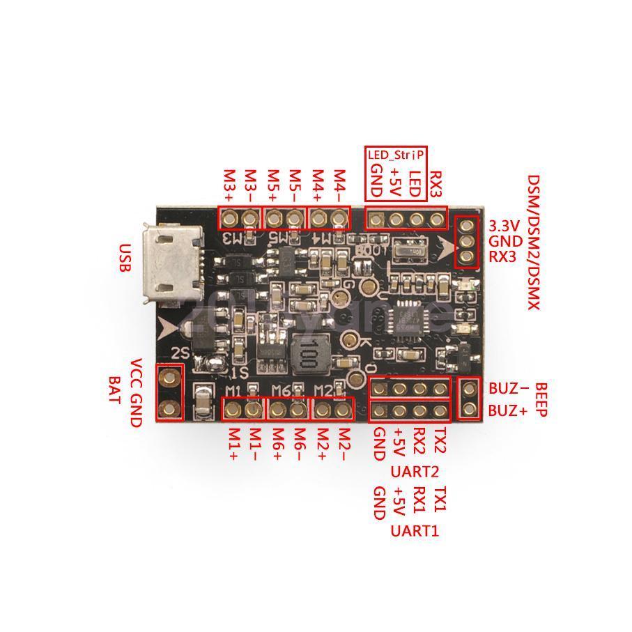

Wiring:
If you want to use IBUS then you will have to use the yellow wire of the Receiver.
Connect that to a UART Port that is not beeing used. (RX)
Note: Failsafe will only work on IBUS
If you want to use PPM then you will have to use the white wire.
In case you do not have a wiring diagram:

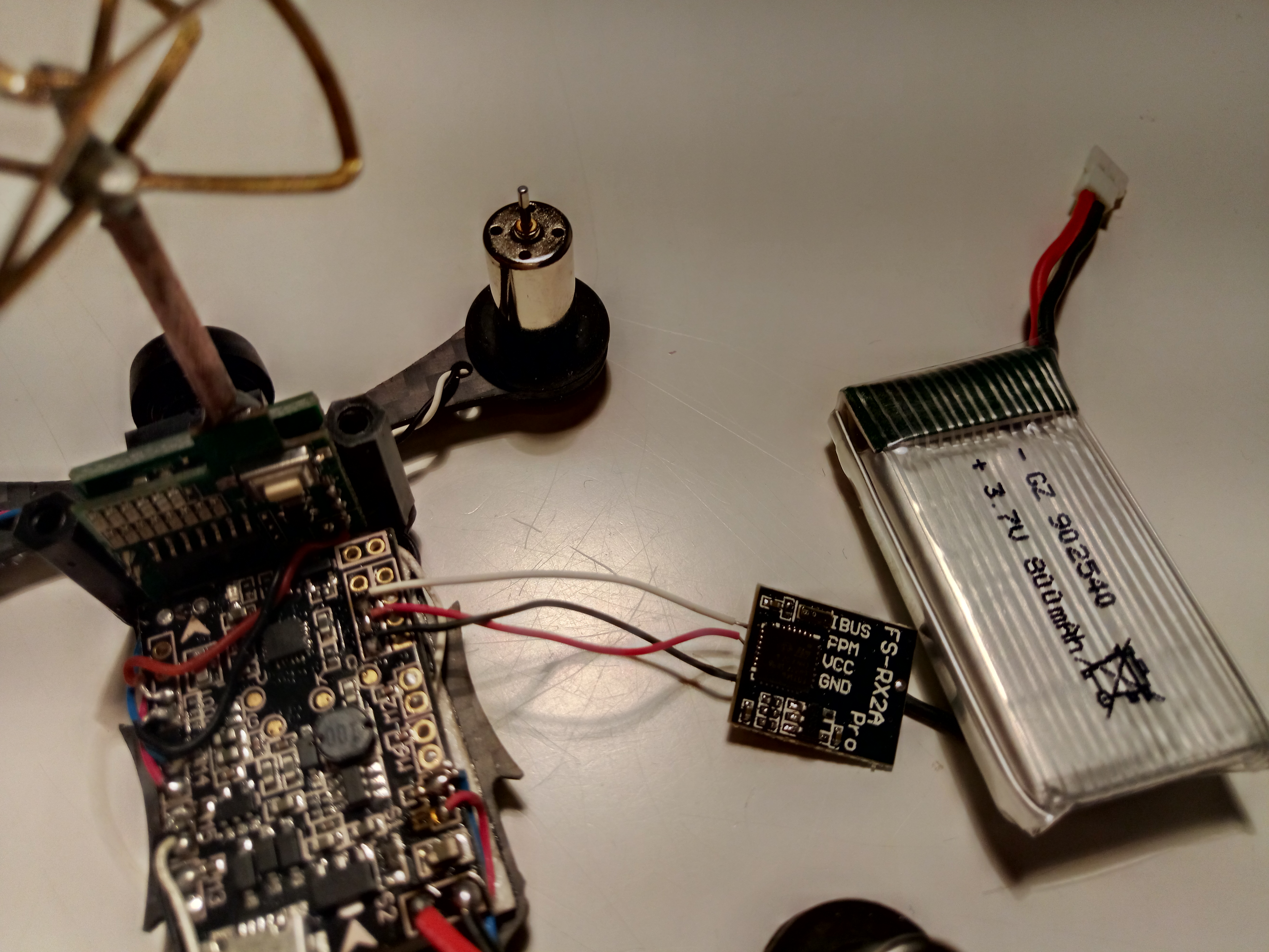

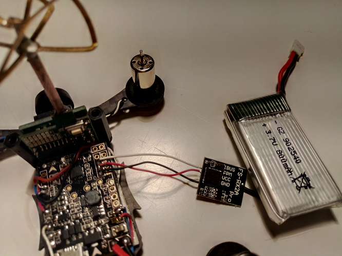

hi did i connect it right?
because nothing happen when i moving the remote control.
The wiring looks fine to me.

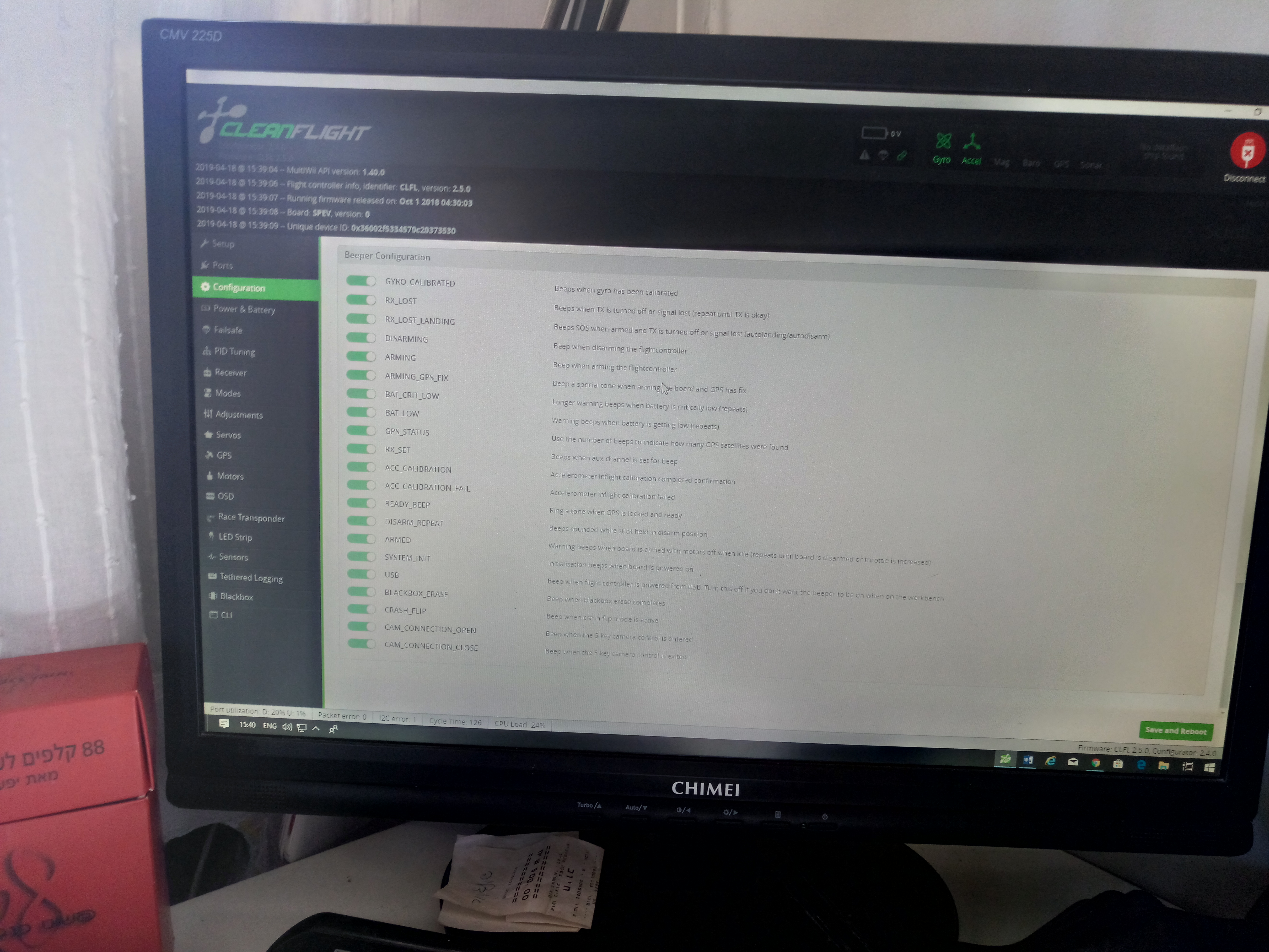

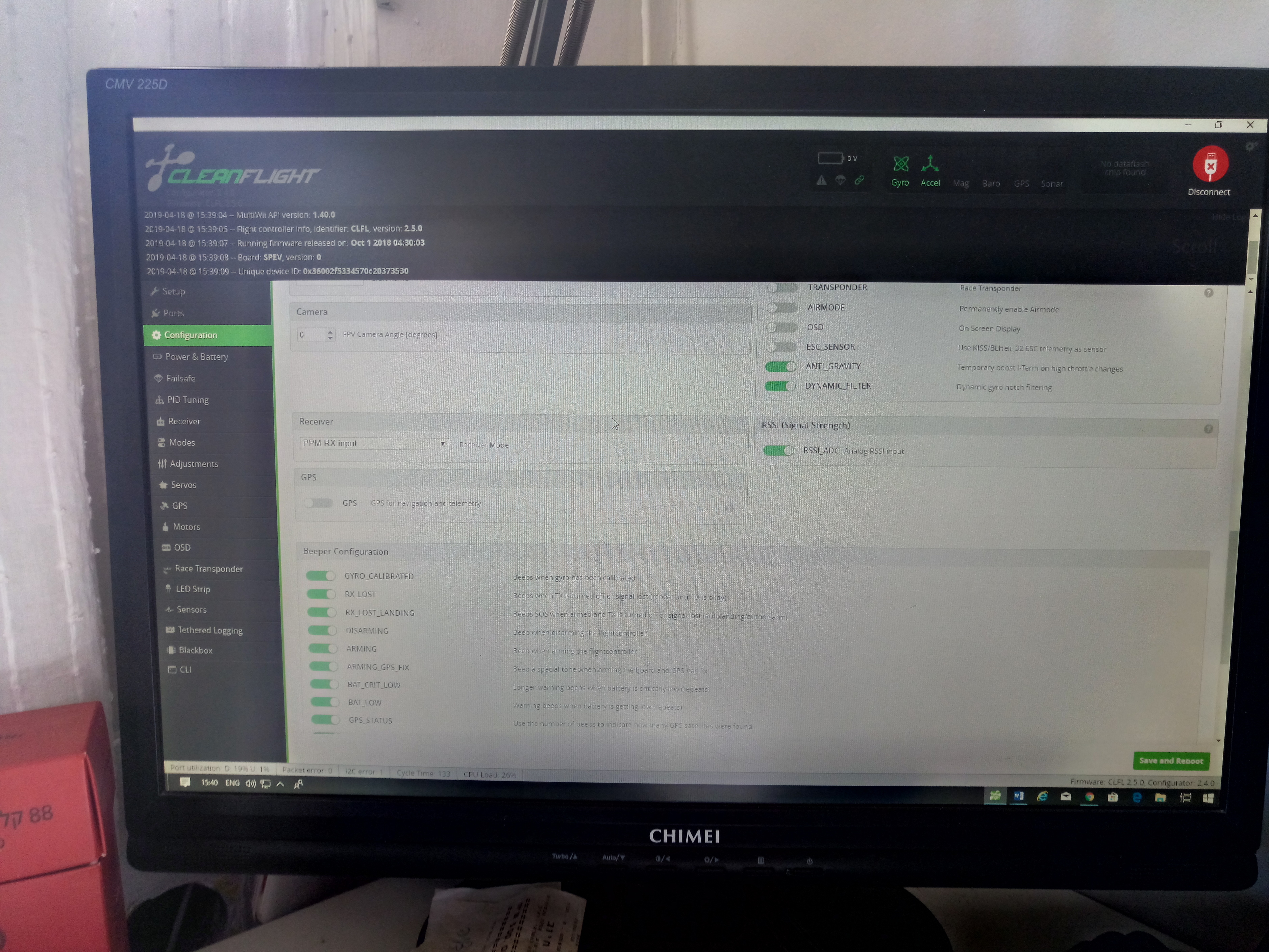

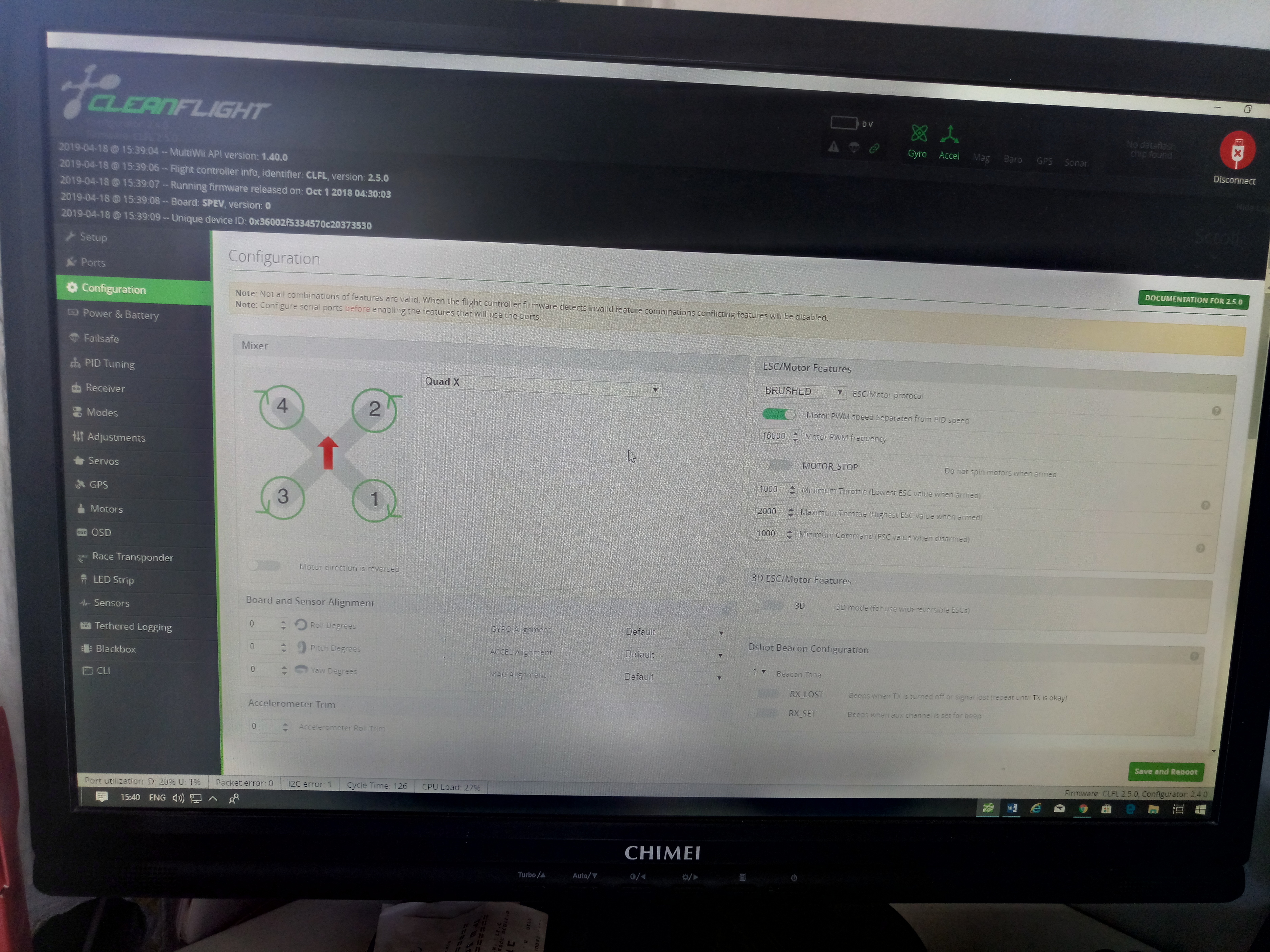

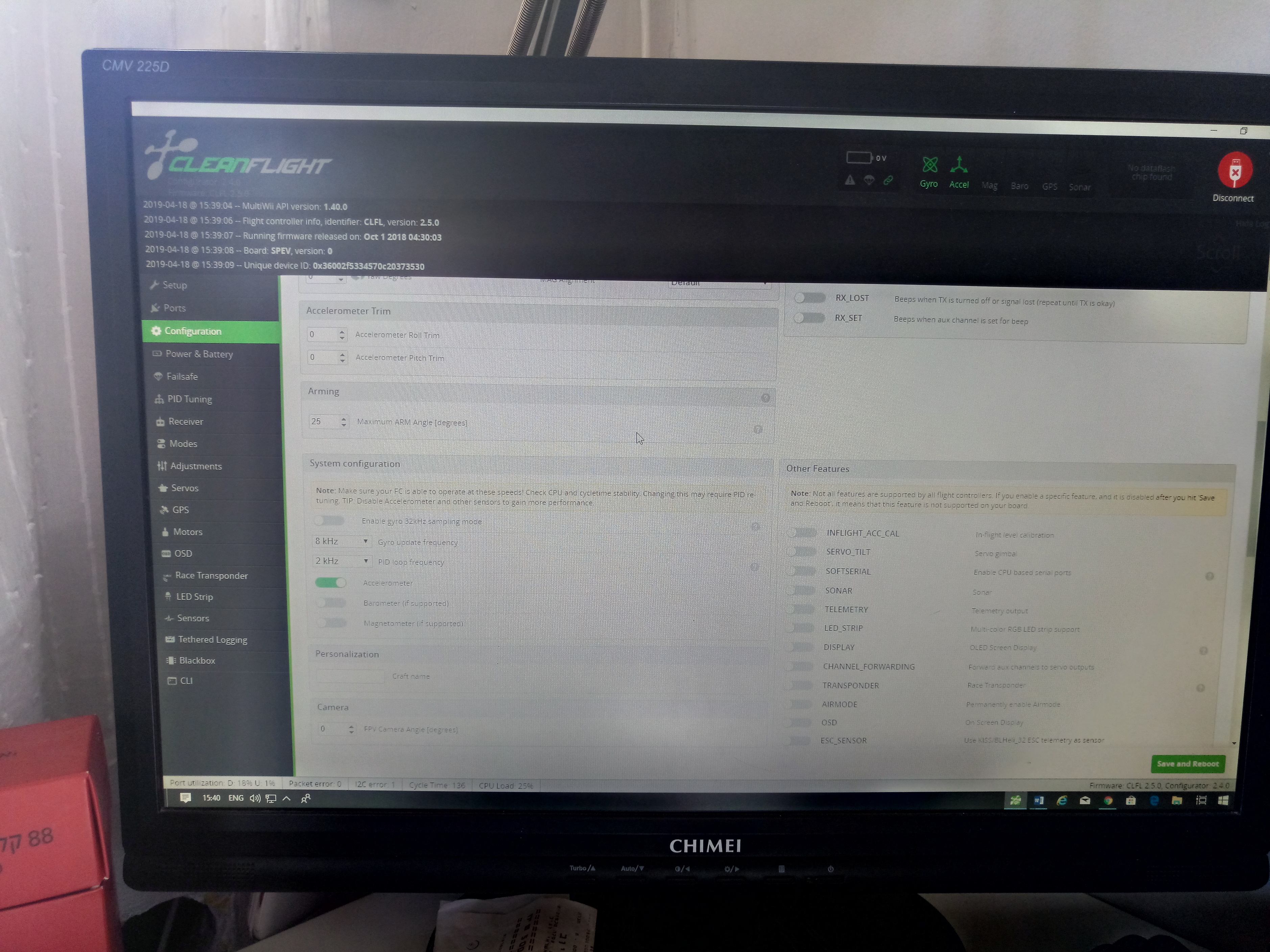

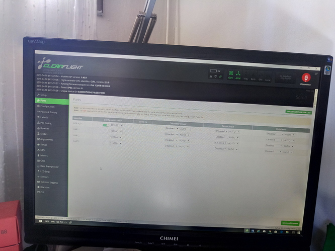

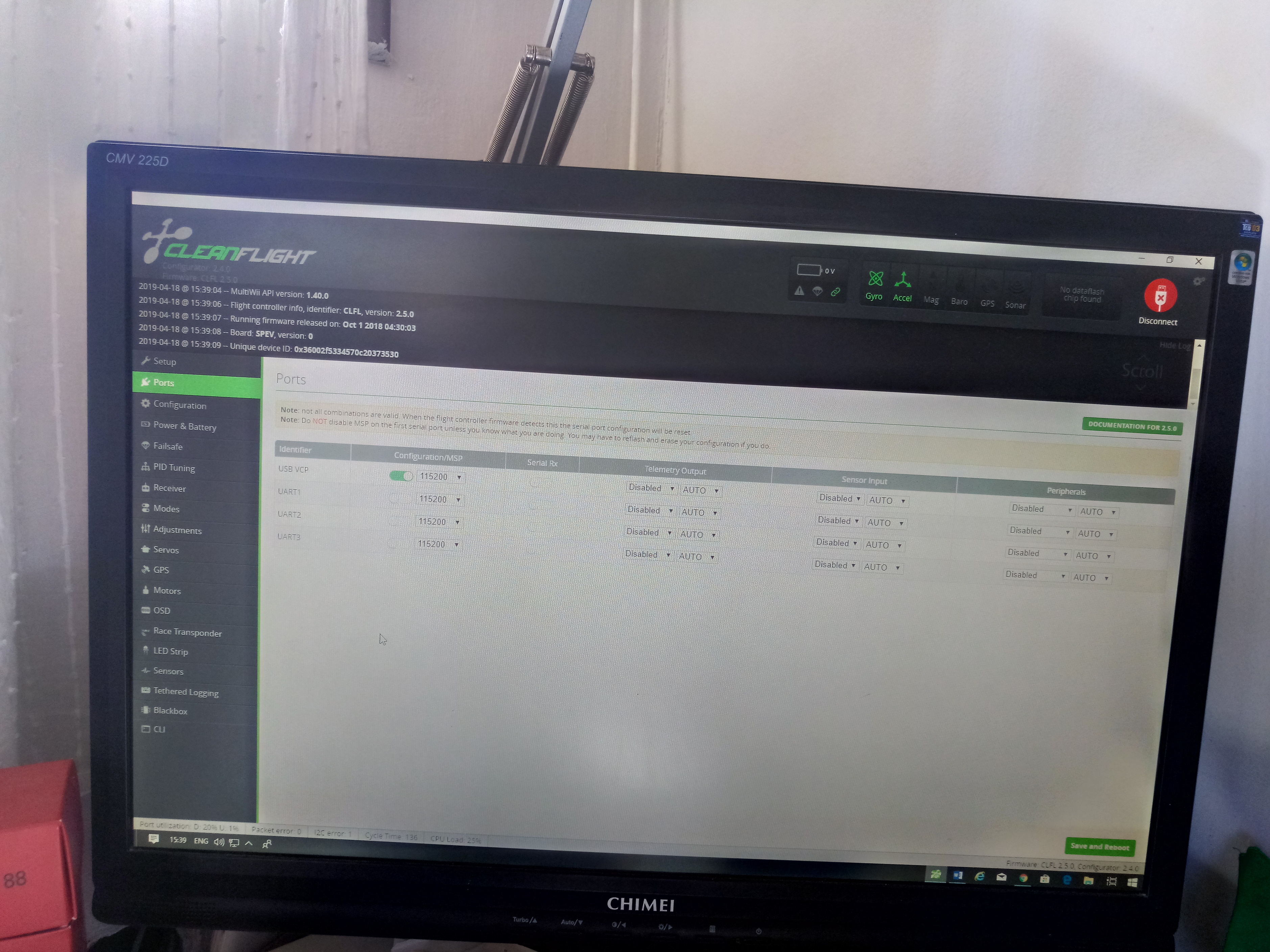

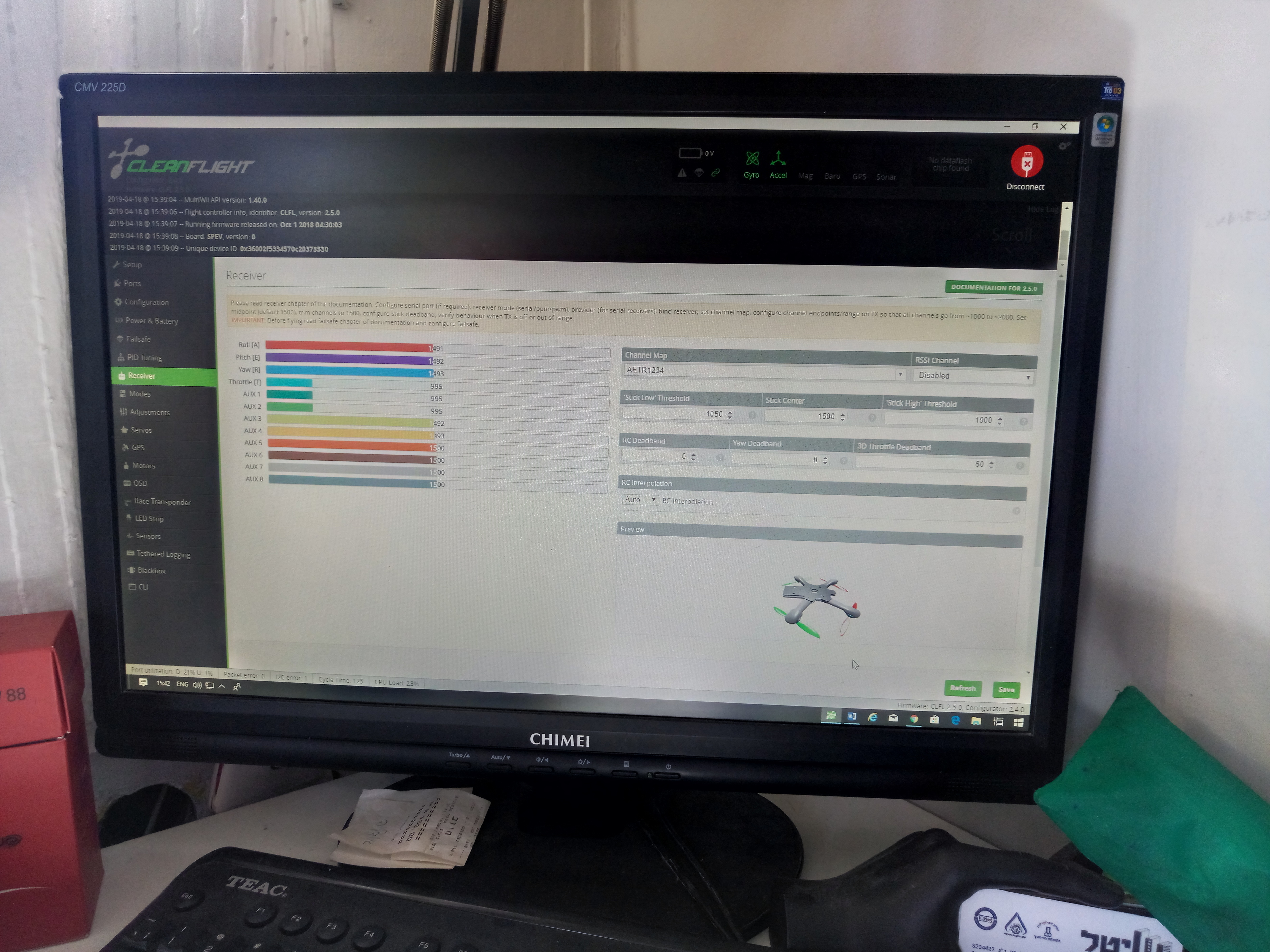

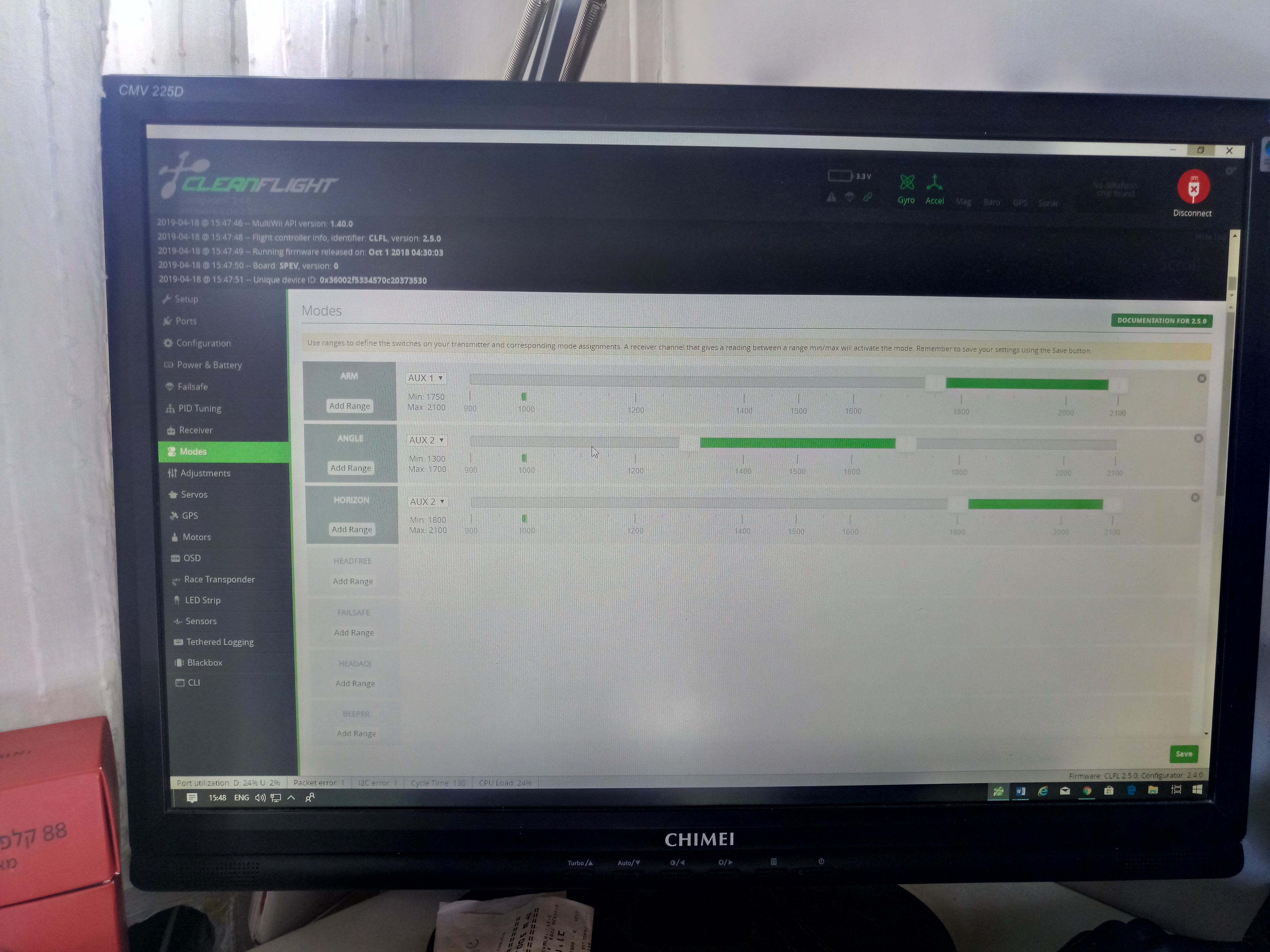

Please upload a screenshot of your Betaflight Ports,Configuration and Receiver Tab.
