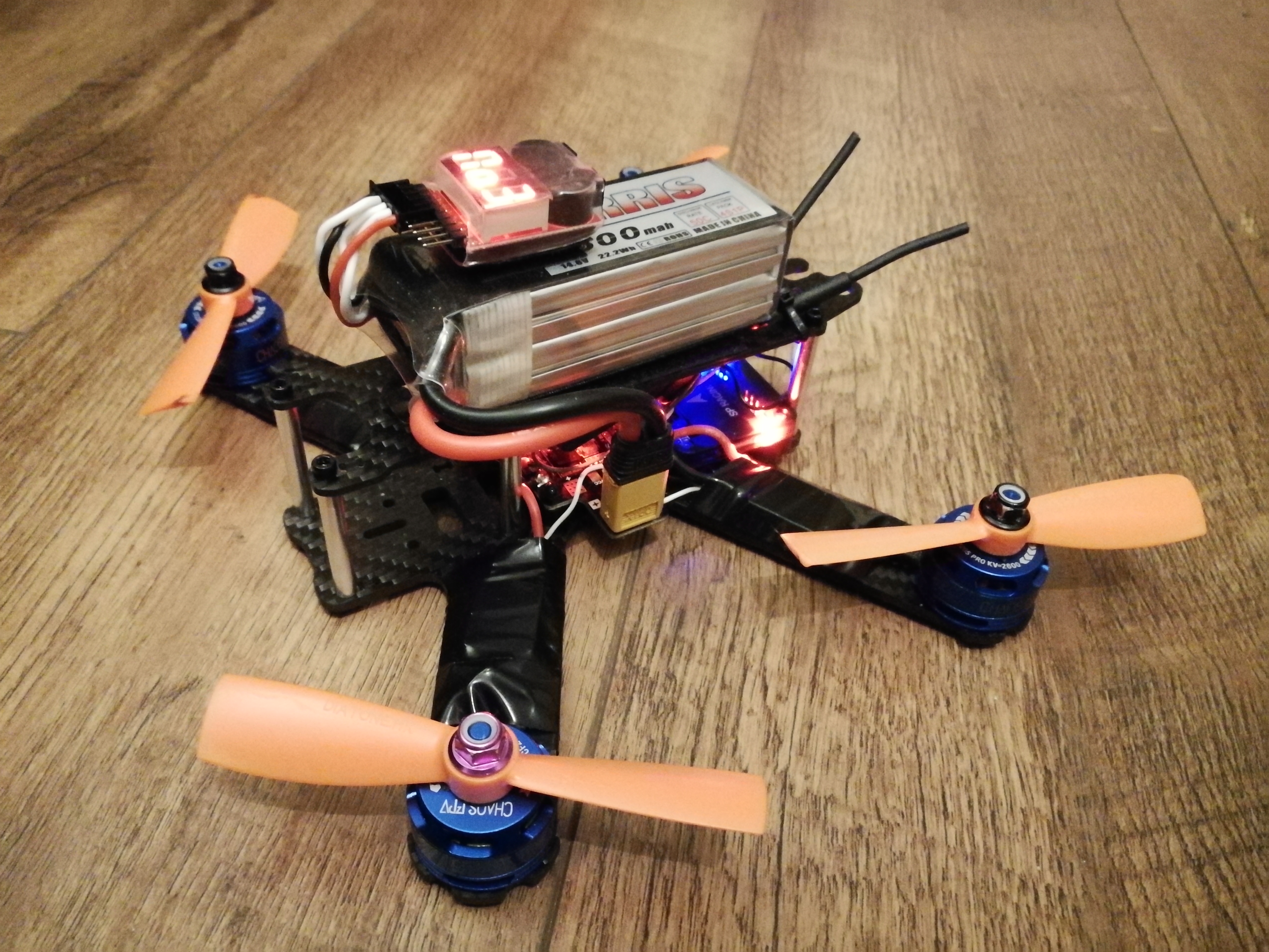

Show us your quads and specs :slight_smile:
Chaos ESCs running Dshot 600
Chaos FPV 2600KV Motors
4" Bullnose props
1500MAh 4s battery
Flysky i6 receiver
F3 Flight controller - running cleanflight.

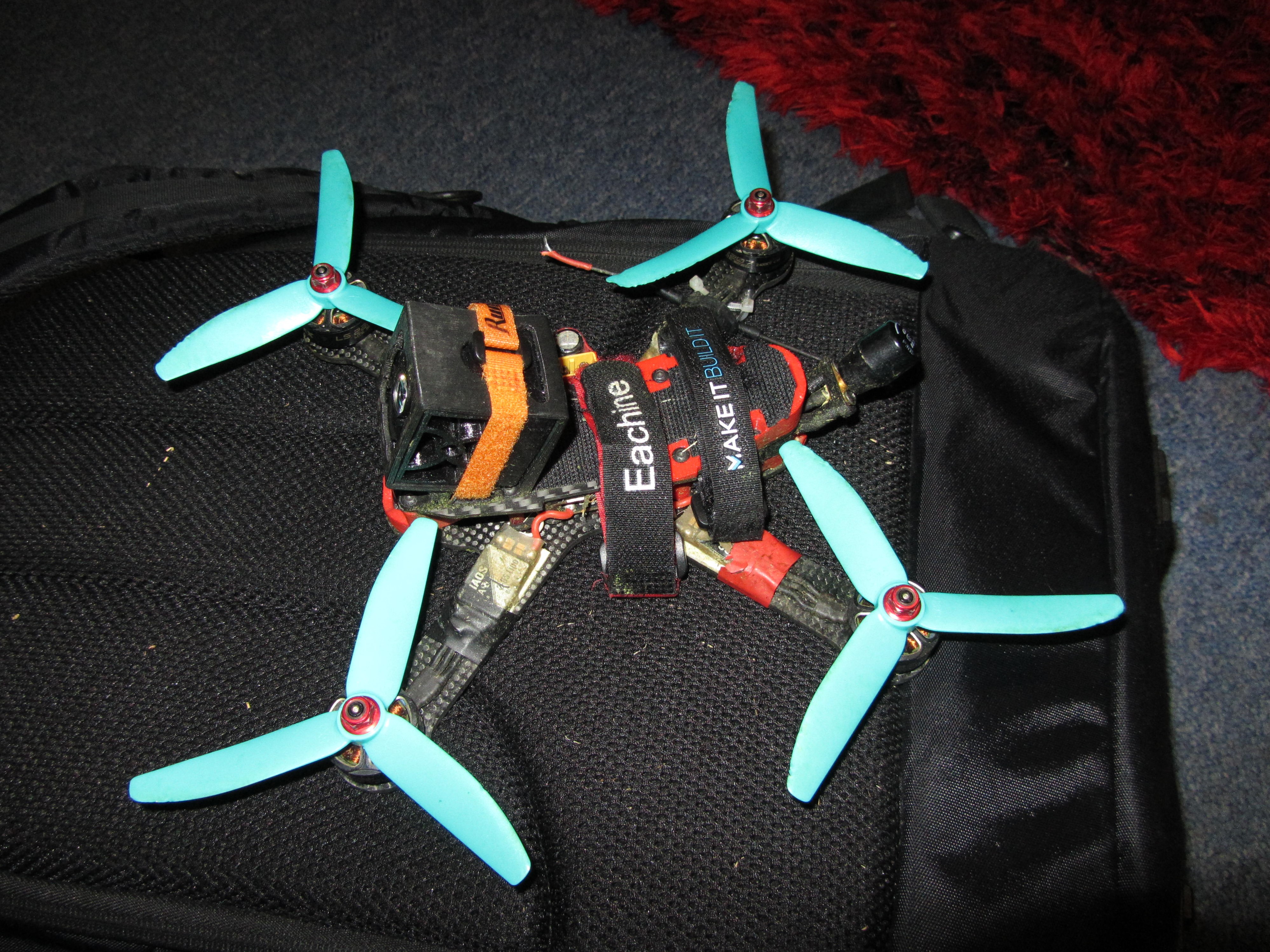

Quadcopter - DoomedFPV v2
  • Camera tilt 25
  • Frame — Doomed V2 (Custom frame designed by me)
  • FC — Matek F405-OSD v3.5.1
  • Motors — Emax LS2207 2400kv
  • ESCs — Chaos BLHeli_S 30amp (Dshot 600)
  • FPV Camera — RunCam Micro Eagle
  • FPV Tx — Unify Pro HV FPV
  • FPV Antenna — Lumenier AXII Stubby
  • Rx — CrossFire Nano
  • HD Camera — Caddx Turtle (Custom case)
  • Lipo — Turnigy Graphene 65c 1300mAh 4S
  • Props — GEPRC 5040 Triblades
    AUW - 597g

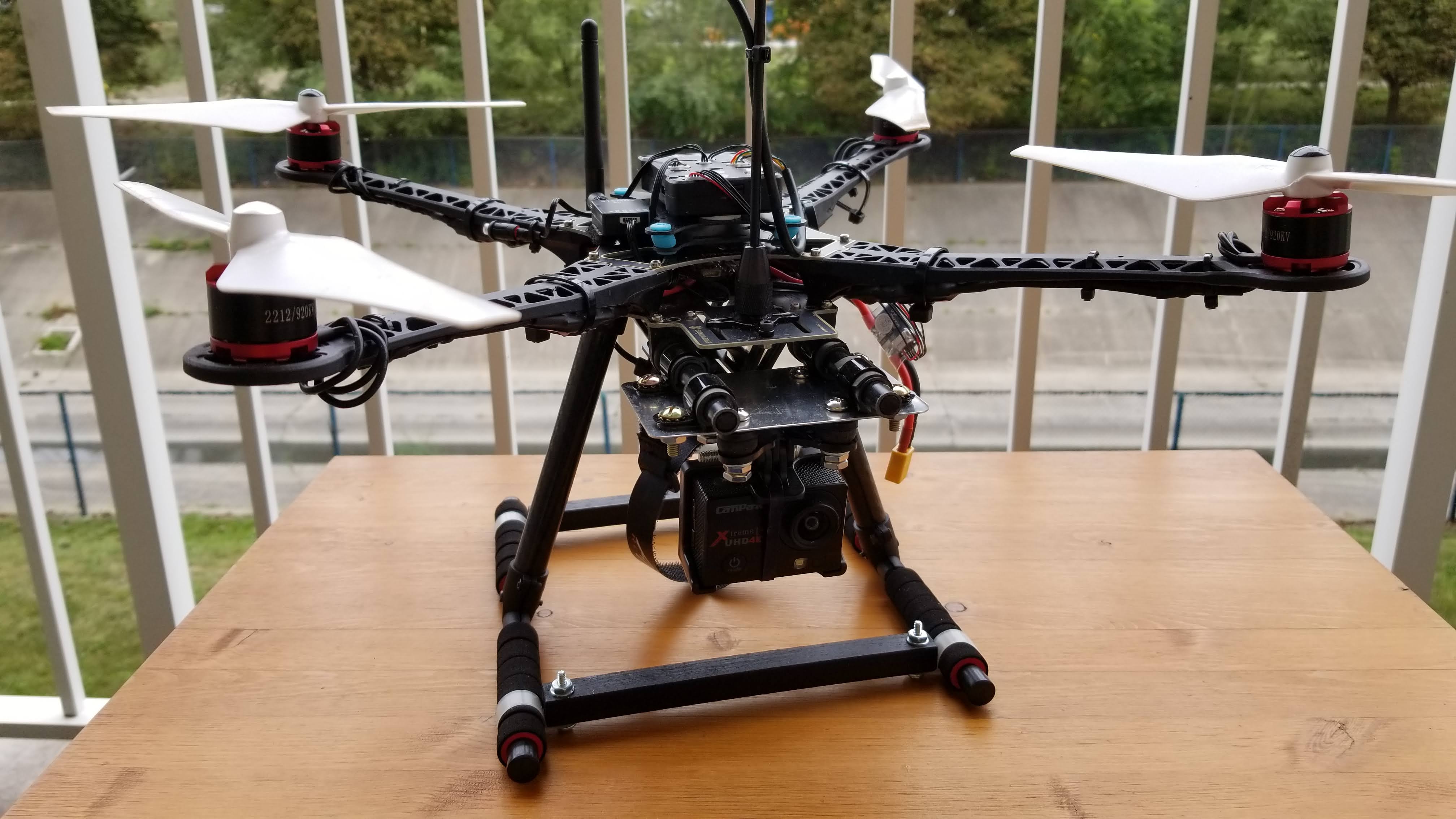

Main components of my Quad:
  • S500 Quadcopter frame
  • XT60 power distribution board
  • Pixhawk PX4 Autopilot PIX 2.4 8 32 bit Flight Controller
  • Power Module for Pixhawk Flight Controller
  • LHI 2212 920KV brushless motors (4)
  • 30A engine speed controllers (4)
  • M8N GPS module
  • 3DR Radio Telemetry
  • 1045 props (10”)
  • FlySky FS-i6 radio and FS-iA6B receiver
