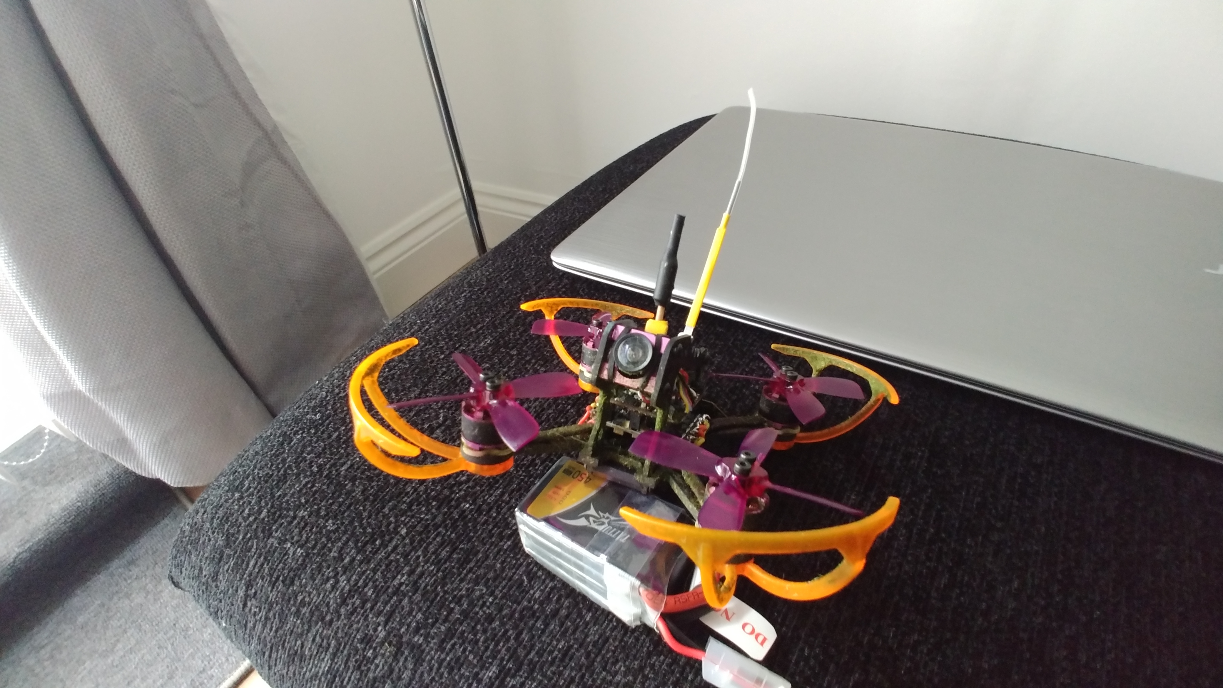

Hi all i have changed my tower in my lizard95 to the f3 emax magnum as its 4s capable its all in, bound up working but it wont take off the motors are spinning the correct ways and the props are on the correct way.
After fitting i did update the fc to the latest version and changed the directions on the motors in bheli to the correct way but thats all i have done.
If any one can help i appreciate it
Thanks
