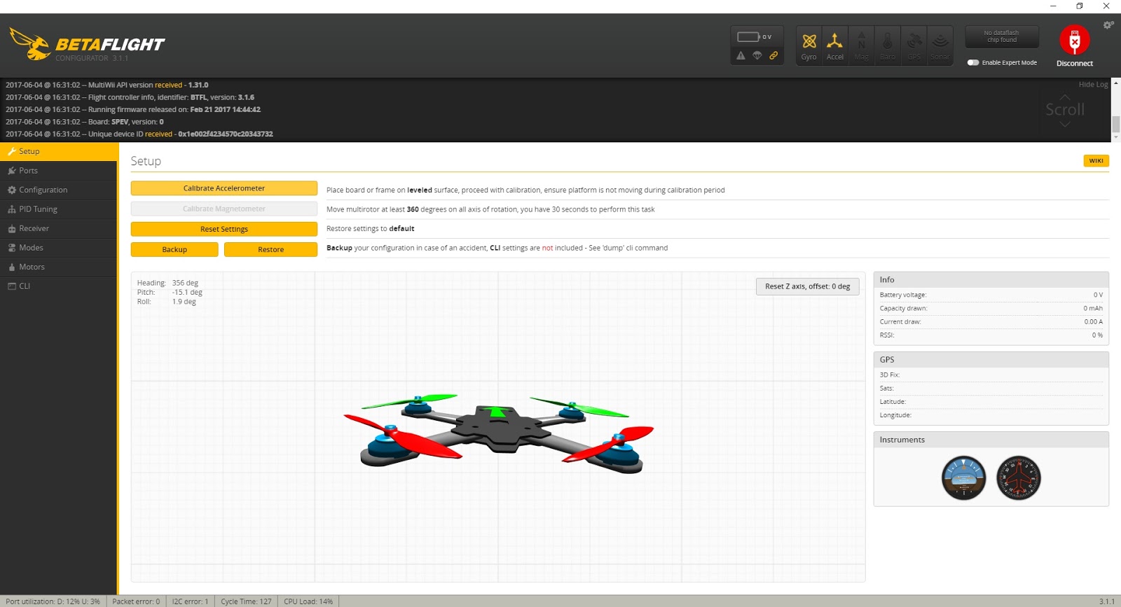

As Luca says - I’d take a look at the FC orientation, this is the most likely cause. Have you flipped, rotated or otherwise moved the FC out of it’s standard orientation? If you don’t know you could upload an image to this thread and we can take a look :slight_smile:
Hmm, maybe not. When I dip it forward and backward the model in BetaFlight reacts accordingly so I had assumed it was right but I’ve just realised when I tipped side to side the model tips in the opposite direction.
I’ve just adjusted the settings so now it’s tipping the right way and will go try again.

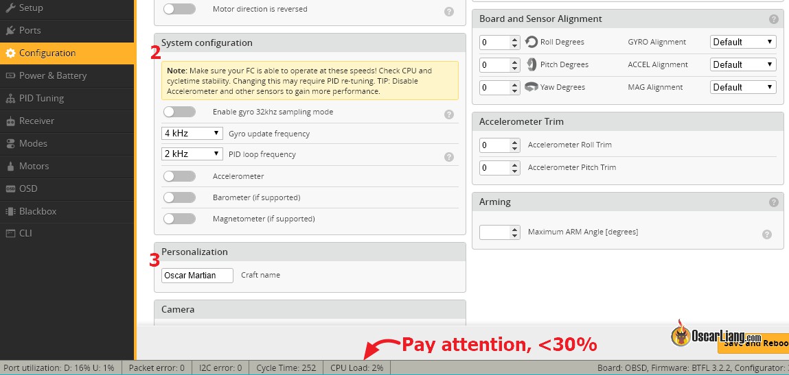

I’m currently messing about with the “Board and Sensor Alignment” settings in Betaflight but struggling to get a combination where the model correctly responds to changes in roll, pitch and yaw correctly at the same time, can get each one correct individualy but not all together :confused:
In betaflight you can check oreintation of fc. Green arrow points front of quad
There where you have board alignment on yaw type in 90 instead of 0 and chceck if its correct if not check 180 or 270 if non of this will work i think you board is up side down
Finally got it working by adjusting roll by “180deg” and Yaw by “270deg flip”, not 100% sure what the says about the mounting of my FC but I think it’s upside down and back to front :wink:
