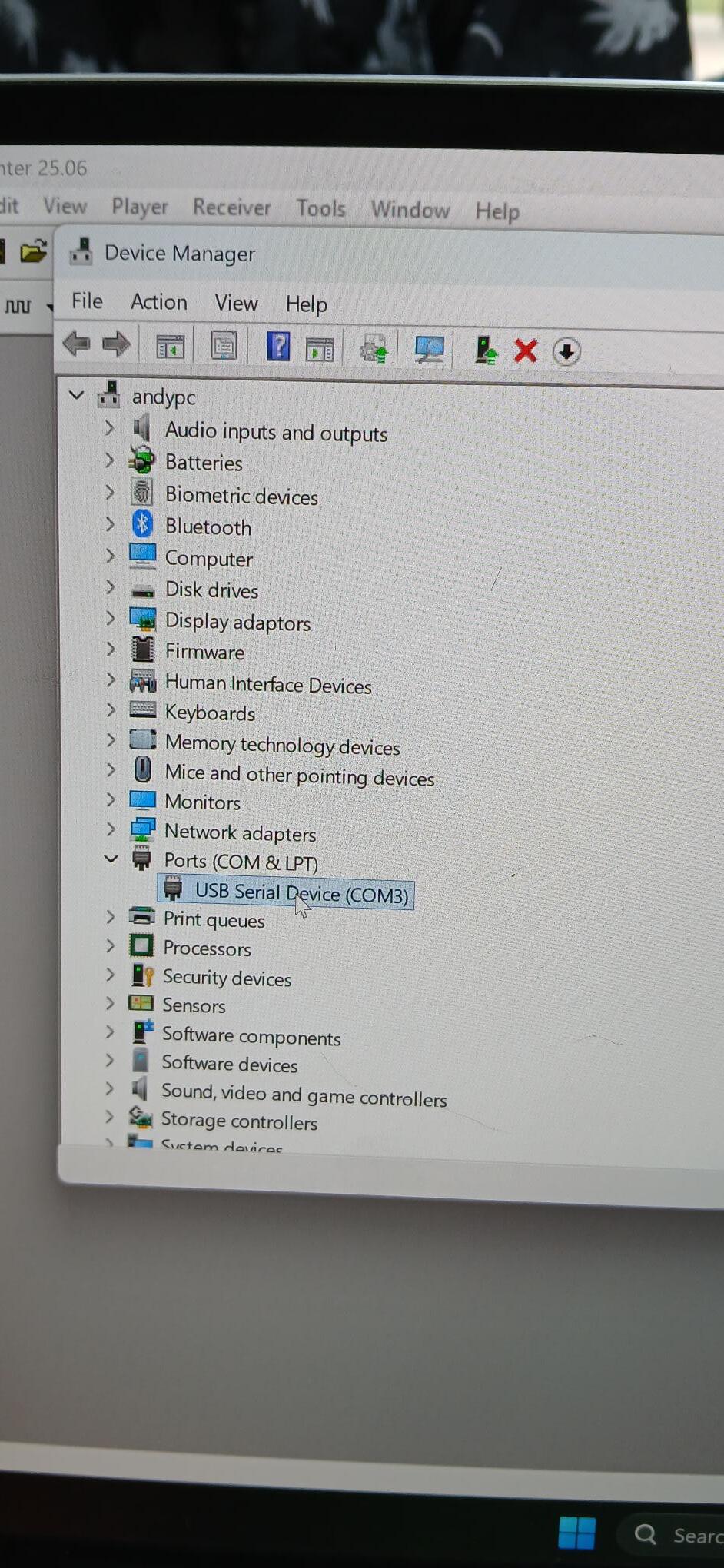

So when I connect the safeboot pin to gnd windows doesn’t recognise the device, see attachment. If try without connecting them, windows recognises the device and u center opens and loads the module, however it freezes as soon as I try to update firmware. You also mention checking the restart checkbox, but I can see that option.
Andy
(attachments)
The main reason the device is not found is likely because you do not have the correct “safeboot” driver on your system. To solve this please try to get the latest drivers from Ublox.

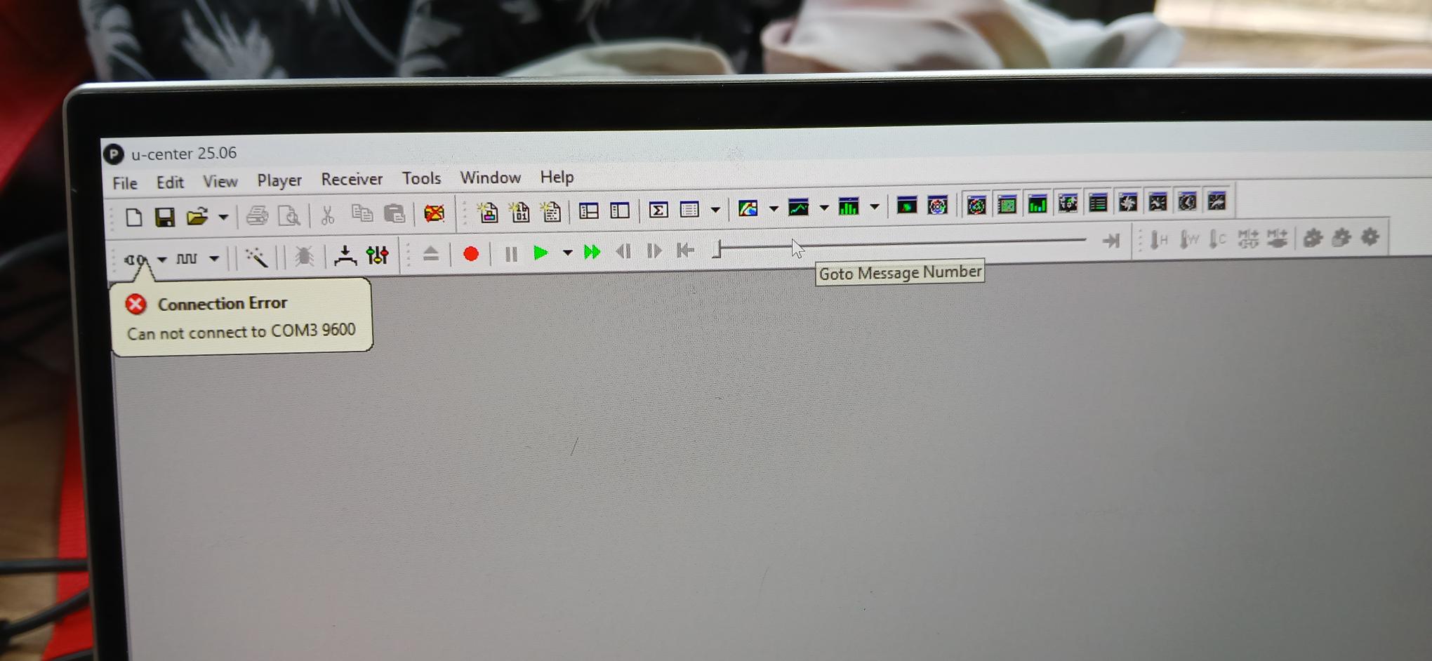

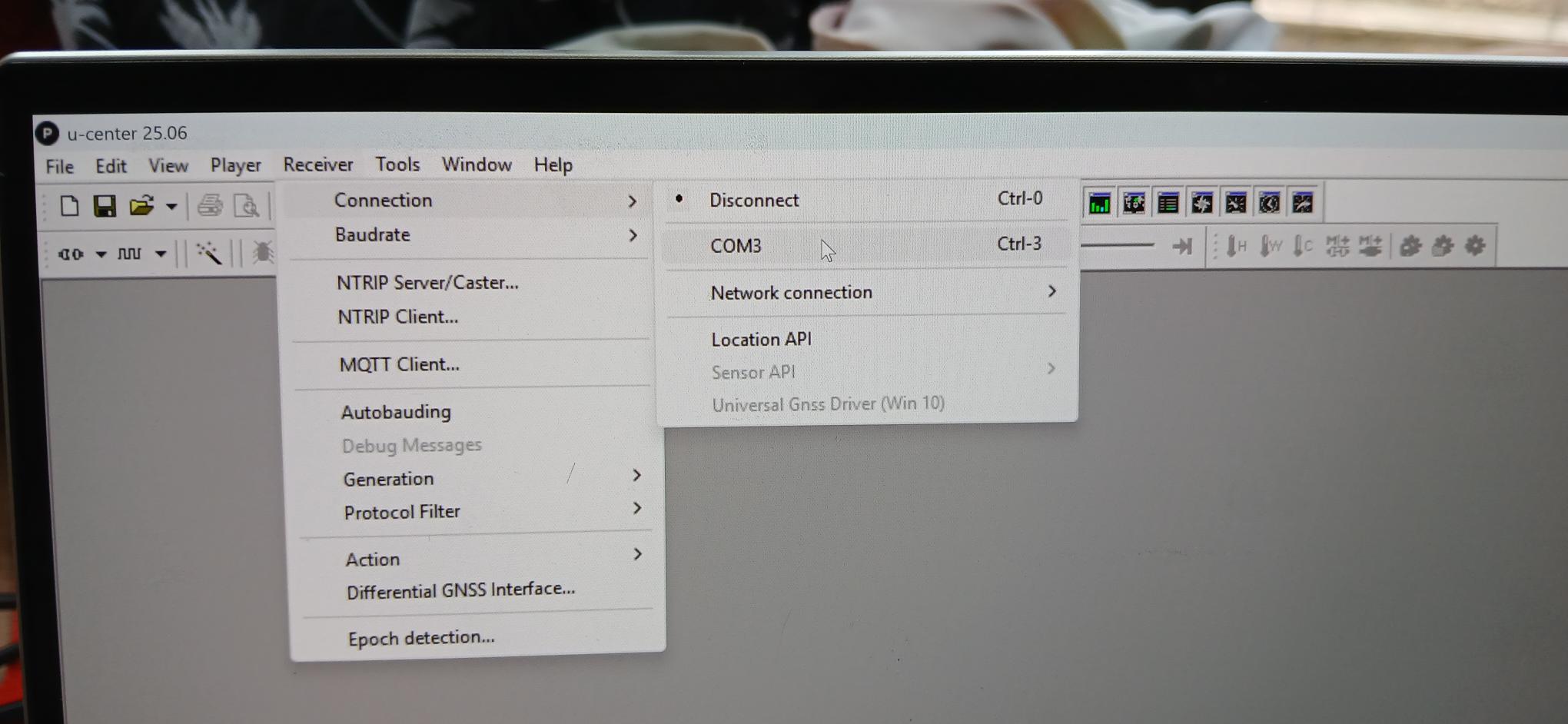

Unfortunately, it didn’t work. The port is recognised but failed to connect in ucenter - see screenshots. I cant flash if u center doesn’t connect.
Please advise as to next steps.
Andy
(attachments)
Could I ask if you have powered the device in safe boot?
As based on the situation as I understand, the unit was working when it arrived, then you tried to update firmware to a new version and that unfortunately failed. If this is the case then it’s almost certainly just been bricked, so if you boot into safe boot, you should be able to see it on your device manager, and recover it. If not there is another method but it’s a bit more complex by using a COM terminal.
However, if you do have it in safe boot but you can’t connect to flash, then it could just be a Windows security thing as I had this issue before on a Windows machine and could not use anything on a serial COM port.
That said it may be best to return the unit for us to check at this point if you want?
