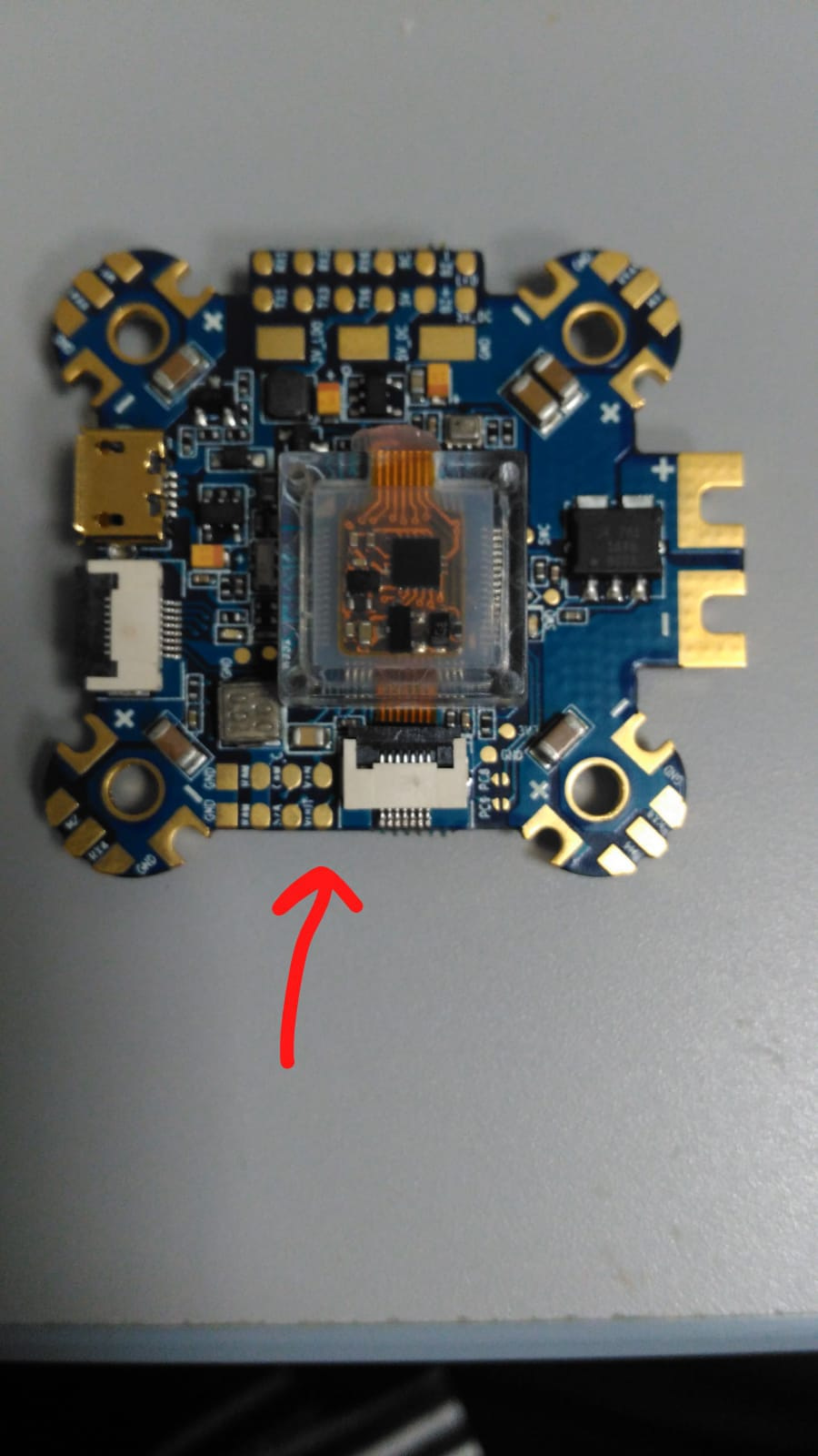

Well yesturday I had to fess up to @unmannedtech that I killed the Airbot Fireworks v2 FC he had sent me for this build.
I recorded the finished wiring video and then went on to the configuration video covering the runcam, FC, ESC, VTX etc… but only to find that the FPV feed was black… No OSD, no camera.
A black FPV feed normally mean no video is being received from the camera and no OSD mean no feed from there either.
When I soldered the video out from the FC to the VTX I lifted the pad killing all video out to the VTX.
I tried to fix it and it did work… until you knock the wire then it goes again
I could maybe get it to work again… but its not worth the risk flying with the chance of the FPV feed going black is never going to end well.
So I ordered a new FC that should be here in a day or two.

I have a variable heat soldering iron were I can adjust the temp from 250 - 450c I court the switch and turn my iron up to 450c
What can I do next time
Check the tempeture each time before using the iron or buy a better iron.
Maybe this is the excuse I need to get a TS100

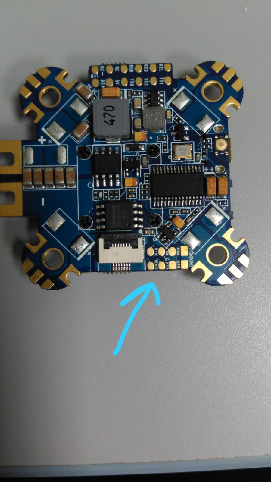

Is a repeat of all the solder pads on the top of the board… including the OSD video out pad.
So I don’t think I needed a new FC.
My job now is to lift all the hardware off the frame and solder onto the OSD pad on the under side of the FC.
Its a bit of a hassle but easier than soldering in a whole new FC.

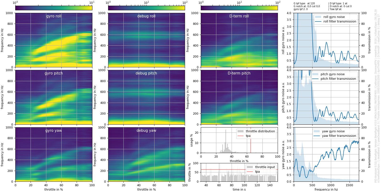

So I turned to Blackbox and Plasmatree for help ( thank god for blackbox logging onto a SD Card )
Now I’m no blackbox or plasmatree expert but even I know what I was looking at was bad…
Yellow = noise not getting filtered… lots of yellow = LOTS of noise.
So I posted it on Facebook for help and I was told…
taken from FB (Group Name - Betaflight BlackBox Log Review)
there is obviously two separate throttle dependent noise bands, a lower ranging from ~160Hz - ~300hz (though falls off @ 60% throttle), and a second higher ranging from ~300Hz to ~600Hz. Dyn notch is on as well as both lowpass and dterm lowpass filters, so honestly at this point I’d start looking for any mechanical issues and ways to reduce noise/vibes onto your gyro, paying close attention to whether something is touching your FC and whether it’s nicely floating on soft mounts, and then checking for rough motors, and/or bad props.
So…
I took a good look at everything on the frame and noticed that even though the FC could move on the soft mounts… I loosened them more, much more.
And long behold…
It was much much better 100% better…
I would share some HD footage but my SD card decided it was going to take a dump.
My Blackbox and Plasmatree data still looks bad ( too me ) but it looked some much better in the FPV feed…
