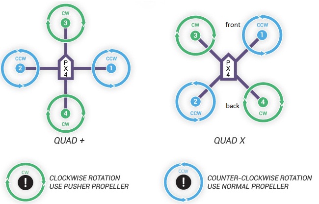

can anybody tell me why this is happening? I am also attaching a photo explaining my frame and motor setup. I am using “X” configuration.
Are your motors connected to the APM outputs as per the diagram, does pushing pitch (elevator) forward speed up motors 3 & 1 when it should speed up 2 & 4 in your diagram?
