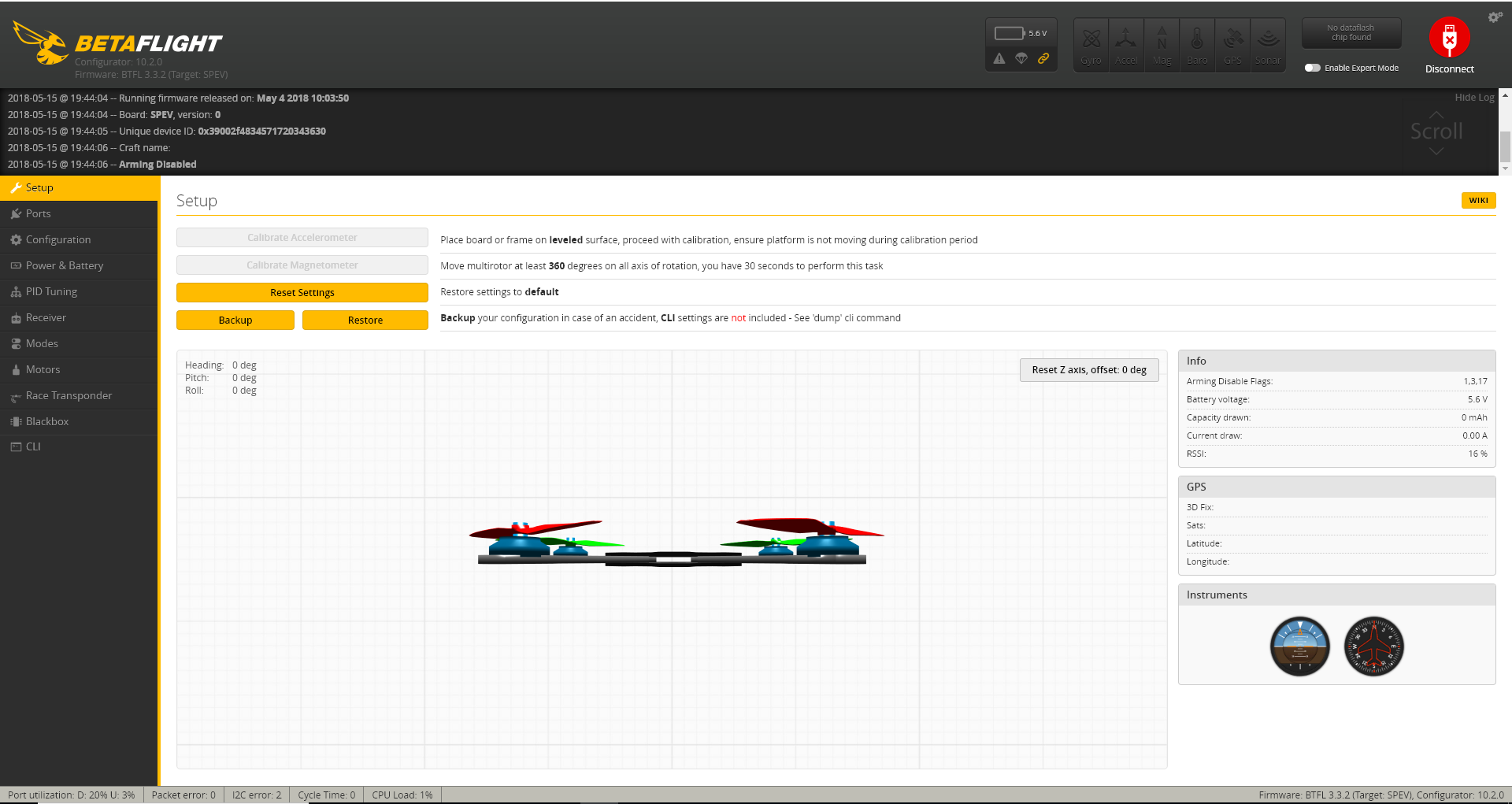

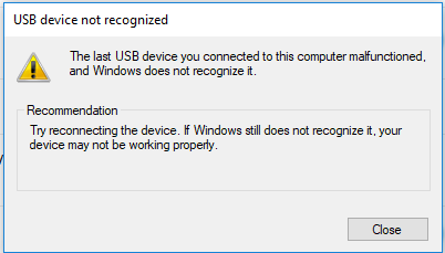

I tried to flash it with betaflight but after the flash, my pc won’t recognize the drone anymore but the betaflight do recognize something it connects to the drone but when I move the drone it looks like its stuck i tried to restart my pc, zadig, and impulserc but nothing helps.

Have you tried switching to another USB Port or another Cable?
Try mixing around with USB 2.0 and 3.0…

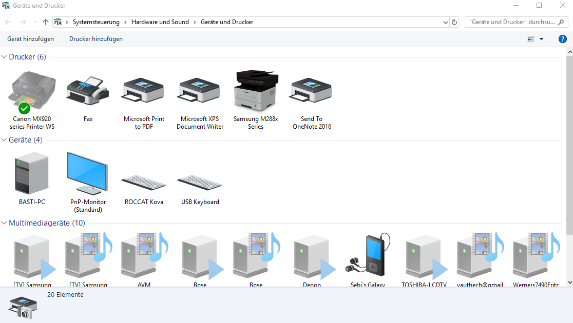

Settings → Open the Device manager → go to “Devices and Printer” (picture 1) → right click on your FC → click on "troubleshoot "

Picture 1 :
It looks like after you flashed you board it is connected and working.
The reason the 3D model is not moving is the gyro is not active (look at the icons at the top)
You may have to go through your Betaflight settings.

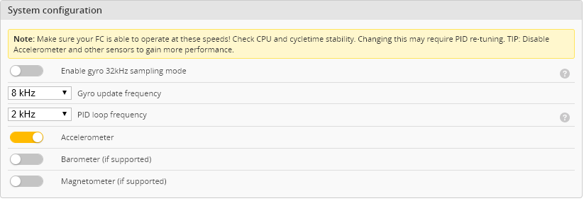

Hey, doomedfpv and thank you for the fast response.
the gyro and the accelerometer are enabled but it’s still not working.
