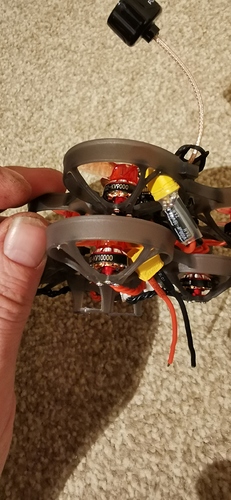

I know it’s not to do with binding but have you got the one with 9000kv motors & a cap on the xt30?
There’s 2 common failures that they have addressed since releasing
ESC - original had 10000kv motors, now has 9000kv motors
5v bec - caused by voltage spike, cap reduces spike
